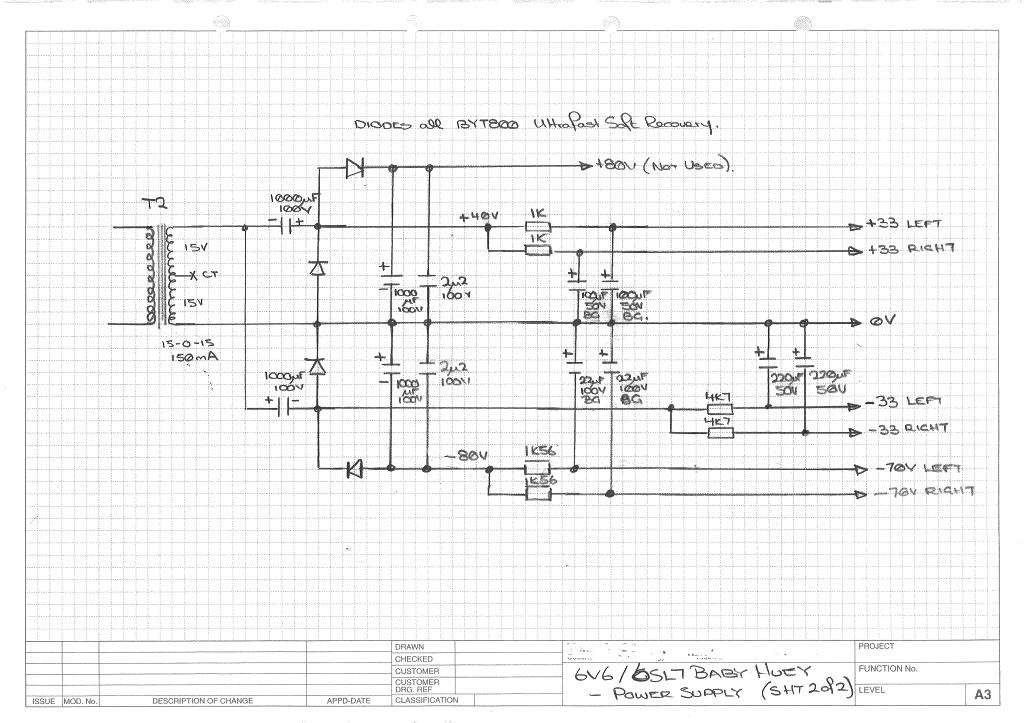

Long time lurker with this thread. I've also, slowly, been gathering parts.
I have a couple nice potted PT's, with plenty of 6.3V taps. So, would it be possible to build the bias blocks with 12.6 volts?
Do you mean to use 12.6 volts to get a negative supply for the diffamp CCS ?(ECC803S) The bias blocks set the cathode bias on the EL84s.
Sorry, everything off the 15V Tx. For the 6V6/SL7 version.
http://www.diyaudio.com/forums/atta...12468-el84-amp-baby-huey-babyhuey_6v6_ps2.jpg
Thanks Golana, I too have gathered together most of the parts for the 6SL7/6V6 baby huey ( sockets, valves, transformers ) and hope to start the build soon. I believe the 6SL7/6V6 version is worthy of it's own thread.
Just to clarify, T2 in Gingertubes schematic is 15-0-15 with an unused centre tap. To me this means two 15V secondaries connected in series to give 30V end to end. A dedicated transformer seems the easier path.
Your link is sht 2 of 2, could you post a link to sht 1 of 2 so we can see which version you would like to build.
Looks like it's from post 1358 🙂
http://www.diyaudio.com/forums/tubes-valves/72536-el84-amp-baby-huey-136.html#post3488845
Yes, that was it sorry. I answered my own question , as soon as I typed it. Yes, I can, but a waste of of big fil. transformer.
