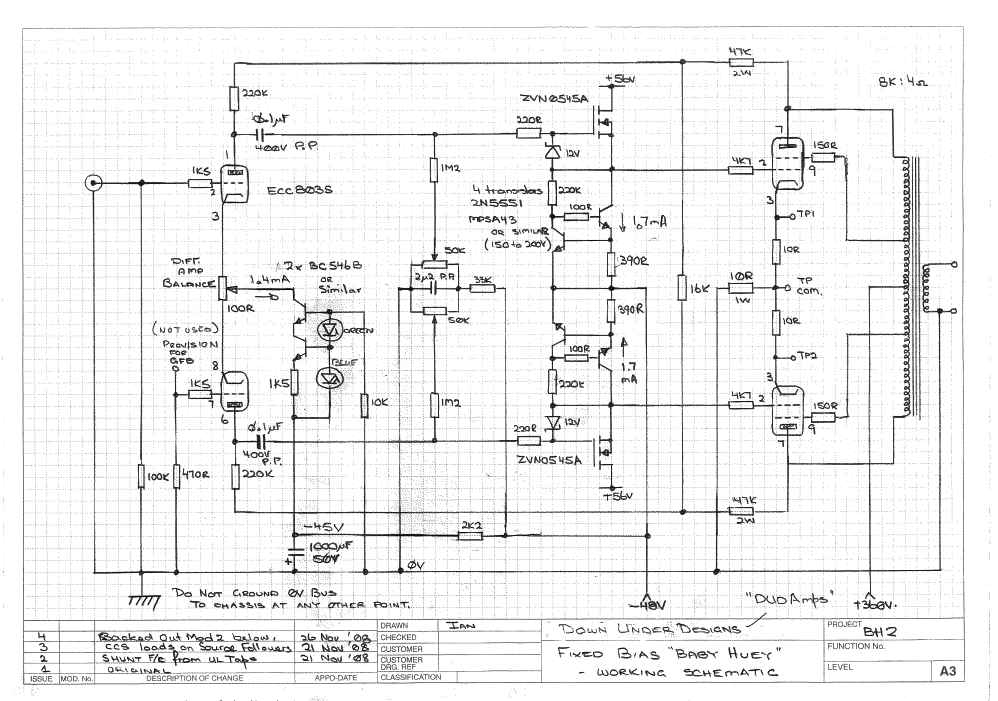

rogon,
A bit confusing, sorry. The new power supply drawings show the " local for each channel" power supply decoupling components, ignore the duplicates on your markup. That is,
the 2K2 and 1000uF from the -70V are deleted and the point you have marked -33V comes direct from the power supply where you will see that this supply has 4K7 + 220uF decoupling instead. Hope that clears this up.
Ian

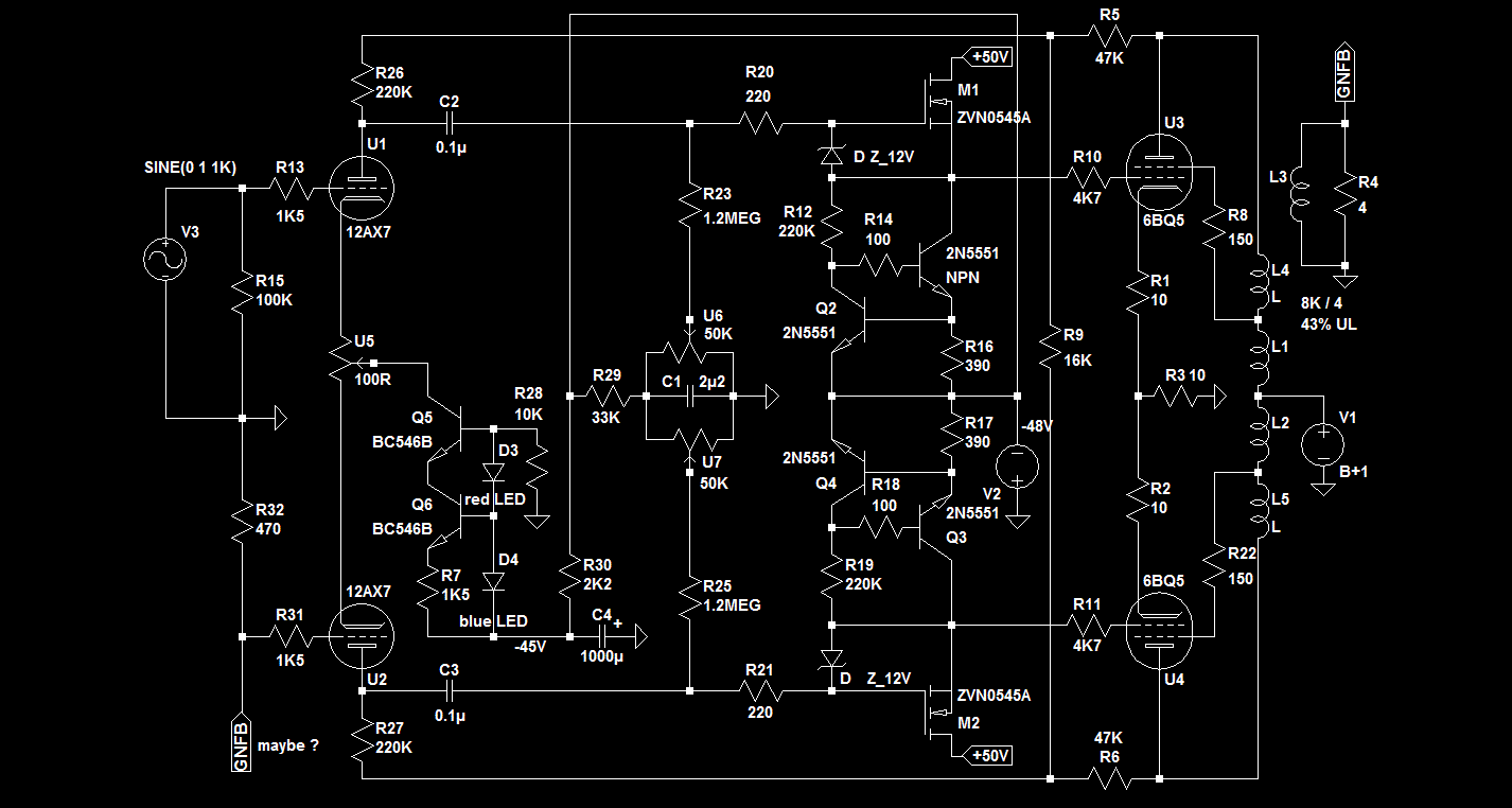

J.
It looks fine.
The Ultralinear connections are not shown, that would require splitting L1 and L2 into 2 inductors each. Also remember that D3 and D4 are LEDS (D3 Green, D4 Blue).
Ian
It looks fine.
Ian

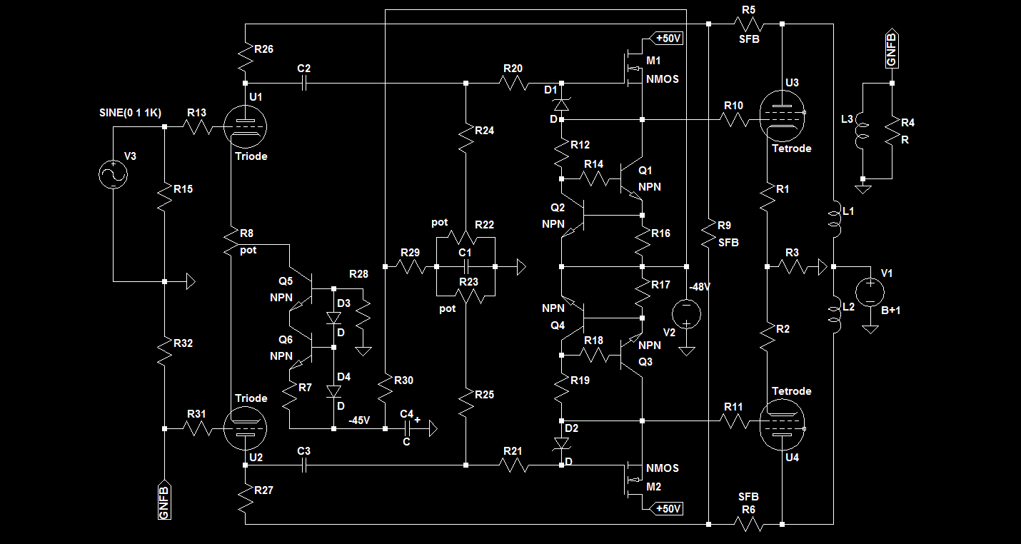

Thanks! I'm going to build one of these for me, but EL34, and full pentode. Nevertheless I'll post a UL schematic with the same components numeration and figures, as per the "Dud Amp" BH2, for best use of other builders.
Besides, how difficult could be implement the H.Dean suggestion of driving the finals by the cathodes? No more a BH though...
