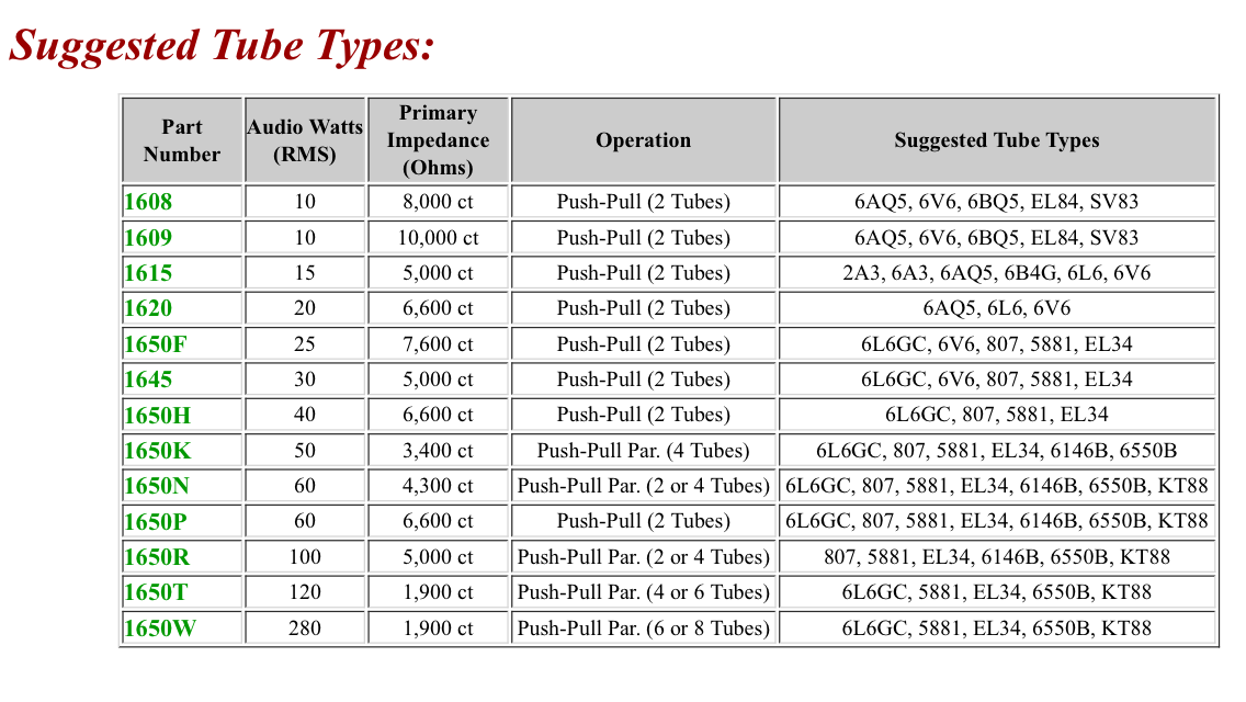

I have recently been gifted an old home amp that has some vintage Hammond iron. I have 2 of the Hammond 1626 Xfrmrs. I am inquiring if the data below makes them suitable for a 6V6 application like Ian has built. I am copying data from the 1974 Hammond catalouge.
AUDIO OUTPUT I TRANSFORMERS HAMMOND I 1600 SERIES - 10 Watt to 75 Watt Designed for Hi-Fi, Stereo or P.A. system applications (Tube circuits)..
Screen taps on 1626 (41 % of pri. turns); for ultra-linear operation if required.
Type 1626 - Frequency response 30 to 30 kHz (-1 dB ref 1 000 Hz minimum)
1626X, 20W, 6600 ct ohm P Imp., 80ma DC per side.

Yes! That’s why you can’t get EL34s at full tilt with your output transformers. Yes, that’s why I suggested to look at 6L6G. How many times do you need to hear it?
You could do BH EL84 somewhat compromised, like I mentioned before.
I think 7591 tubes would also work well with 6.6k OPTs. Easier to drive than 6L6GC types too (they'll require less signal swing at their grids).
Good 6L6 tubes will be easier to find, though.
6v6gt or 6p6s an option as well, with a pentode/ul (Yves/Ian) switch, but I've always read that generally speaking the 6L6 family likes high loads to play better (10 kOhm and above).
Another option (to be checked) could be to connect a 8 Ohm speaker to the 4 Ohm tap and use it as 13.2 kOhm Raa with 6L6GC at 400 V to run in class A full time using the UL tap. You should have approximately 20 W in this configuration.
You can also mount an adaptor noval into octal and install an EL84 or equivalents. Mullard datasheet suggests 6.6 kOhm Raa for UL.

Hi Myles,
With your OPT (1620) i would recommend a nice 6V6 push-pull.
See chart below from Hammond website.
BR
Eric
