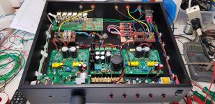

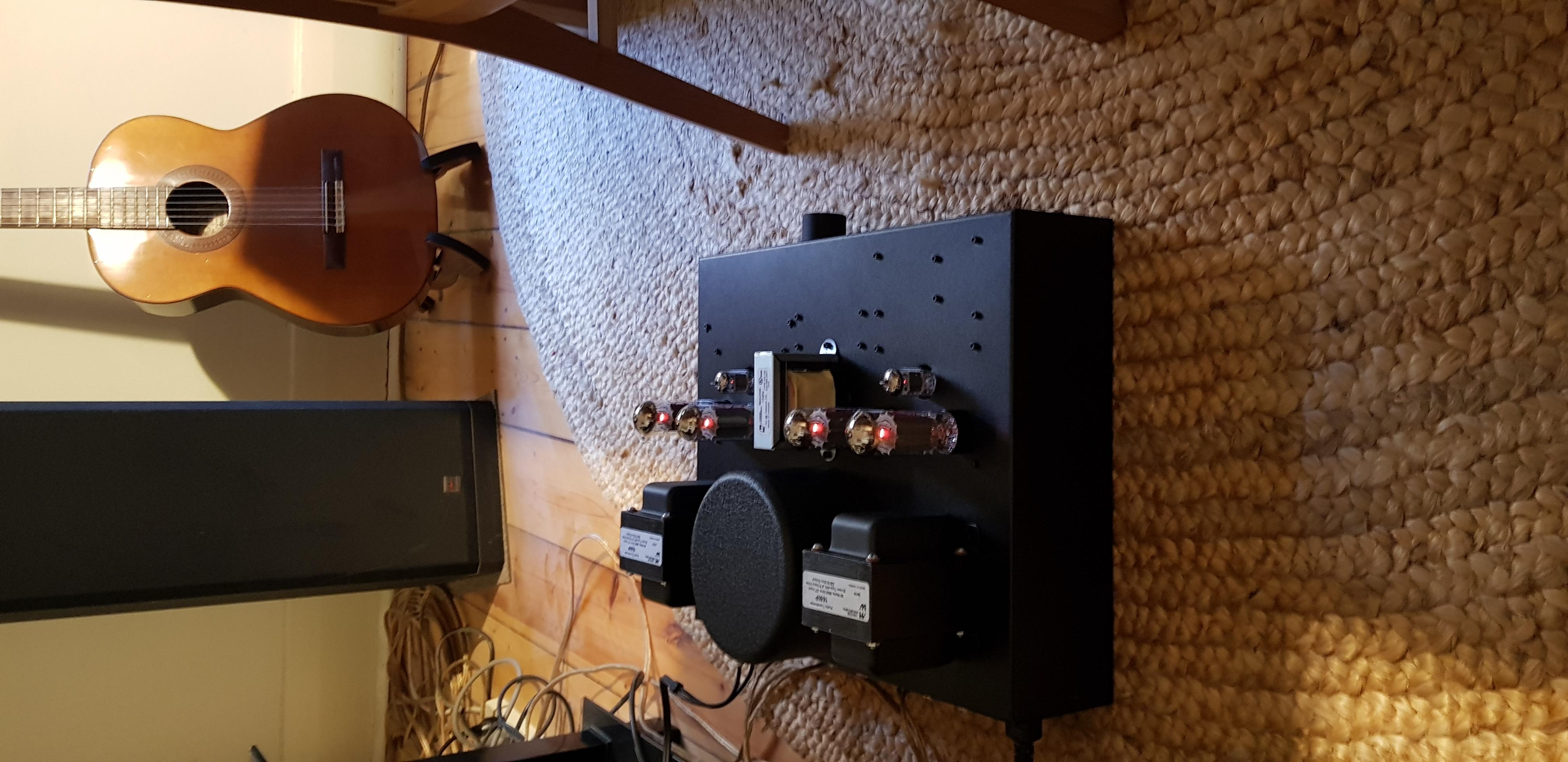

Finally got my build done.
Running B+ of 470V, KT77 output tubes into Hammond 1650P (6K6 Raa) and R13 (the shunt feedback set resistor) at 18K.
Not 100% happy with it. It sounds slightly "muffled" compared the 6V6/6SL7 BH Amp I've been running for several years. It does have a LOT more "grunt".
Am going to replace R17 with a second RED LED and adjust R16 to give 2mA LED current (mod mentioned earlier but not yet done) first, to make sure the diffamp/phase splitter is optimal.
Once that is done will "mess" with R13, the shunt feedback set resistor.
Ian

One thing I can report is that AC heaters and the +15V rail from voltage doubling all from a single heater winding works well (The AC heaters sit at a DC level of half that +15V supply because of the voltage doubler hung across it). Important to NOT add pseudo centre tap resistors. No HuMMM.
Those 2 fuse holders in the 1st picture are 1 each side of the transformers single 6.8 Amp heater winding (10 Amp Slow Blow fuses).
The RED LED front panel push switches are the input channel selection switches (in case I loose the remote). The Volume is remote controlled via motorised pot with slipping clutch so it can be set manually too. The Yellow LED is the remote control acknowledge LED. The selector board at the rear has provision for Op Amp buffer and Gain but I've left all that out.
Ian
