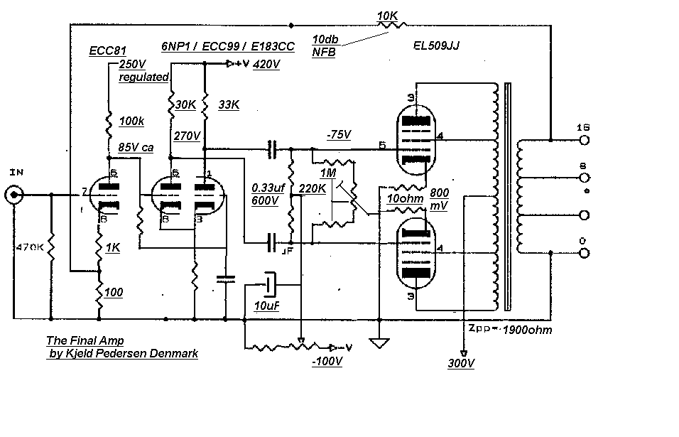

Or perhaps such an output transformeris not really necessary, unless you need big power. Kjeld Pederson’s “Final” Amp design attached, uses 300Vdc in a conventional UL transformer with 1900 Ohm primary to deliver a reported 80+ watts.

Here in Europe Toroidy is a very good source of trafos, but who cares if one simple pair in UL at 300 V can give 80+ Watts?
If you want to extract the maximum power out of a pair of PP EL509, using a tertiary winding for the screens, a core capable of well over 100 watts is likely to be needed. While I happily own several Toroidy power and output transformers, their largest core is good for “only” up to 80 watts, so they would not be able to wind one for max power on a EL509.
Thanks for the schematic, I will try some simulations with the 6KG6 model I have, and see if there's a way to use the BH EL34 boards, but I see hard times for the 12AX7. New ones (I've seen one with a gain stage after the PI and autobias) will absolutely perform better.Kjeld Pederson’s “Final” Amp design attached, uses 300Vdc in a conventional UL transformer with 1900 Ohm primary to deliver a reported 80+ watts.

Thanks for the schematic, I will try some simulations [of Kjeld Pederson’s “Final” Amp] with the 6KG6 model I have, and see if there's a way to use the BH EL34 boards, but I see hard times for the 12AX7. New ones (I've seen one with a gain stage after the PI and autobias) will absolutely perform better.
Roberto,
The “Final” Amp design is one I’m eager to build after the Baby Hueys. I have a pair of Plitron output transformers perfect for this amp already, but was unsure what driver/inverter tubes to use, since Mr. Pederson gave several options without associated part values. I’m not skilled (yet) with circuit simulation myself, so I would be VERY interested in your simulations of the ”Final” circuit. (Apologies for the OT diversion to all Baby Huey fans).
