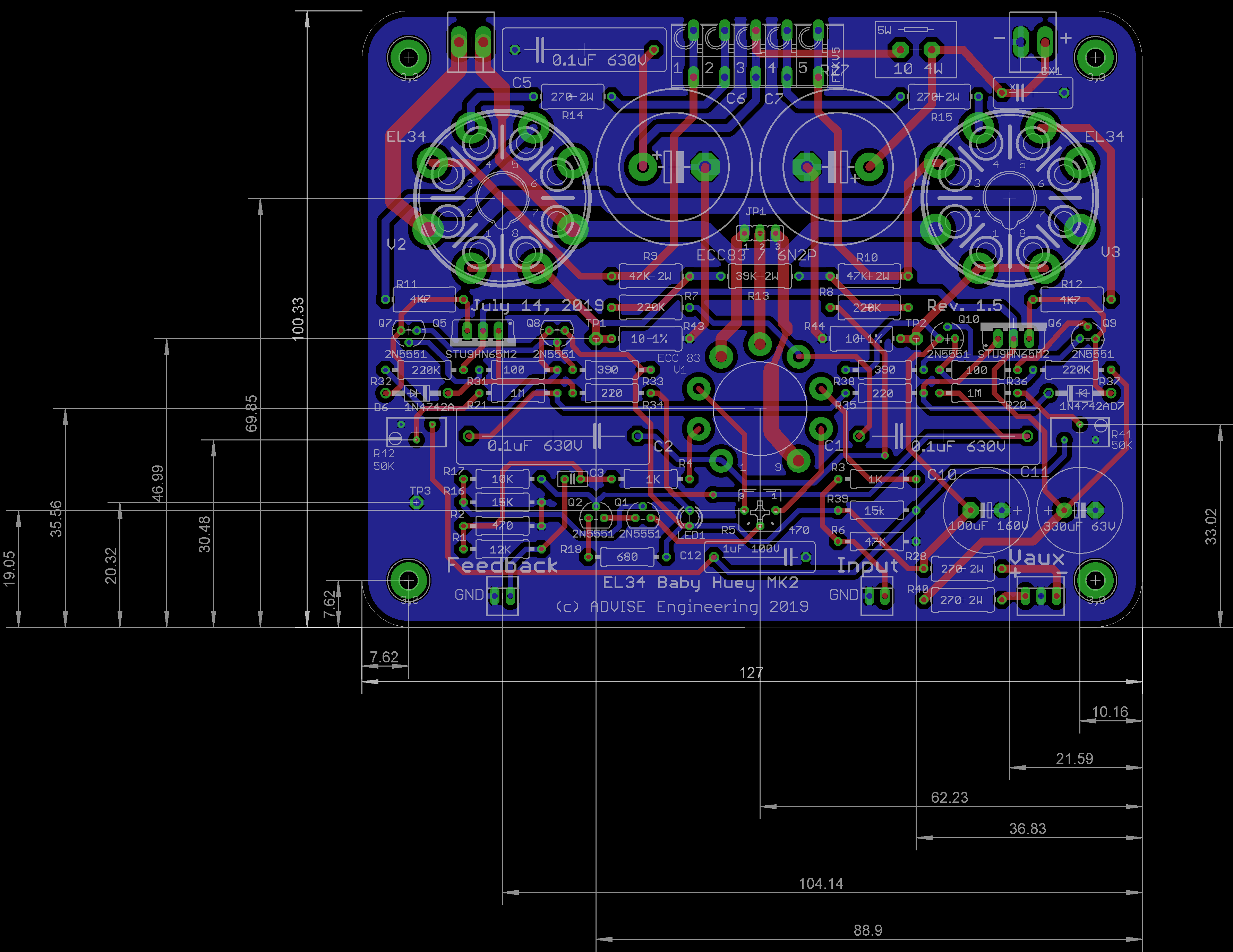

I repeat that this version has not been tested but it use exactly the same schematic that the first version and should work without problem. Now if some members of this forum want to take the risk and if Prasi can produce the PCB, it is time to check if there is enough interest to produce it ?
Because of the rules of the forum, I suggest to use this address to register your interest with the indication of MK2 PCB : GB for Baby Huey PCB If there is enough demand and if Prasi accept to do it, we may have an other round of EL34 Baby Huey production...

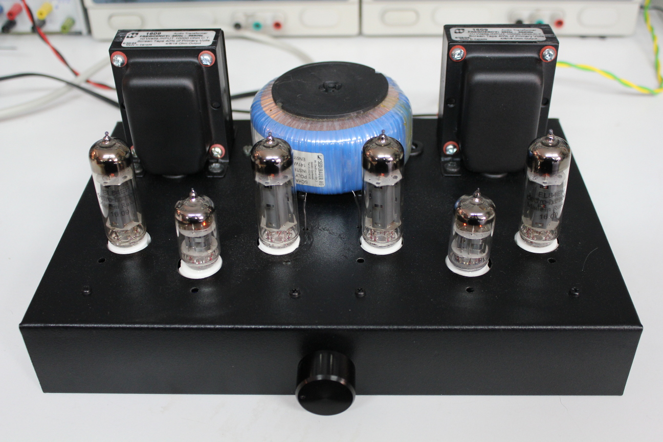

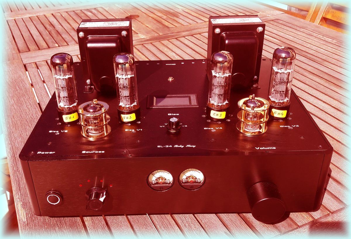

You can find below the last schematic and PCB of version 1.5 as well as the pictures of my EL84 and EL34 Baby Huey as well as the one of Philippe with nice Toroidy transformers...

Marc and others, For info - with EL34 output tubes R14 and R15 may not be large enough. Some years ago I built the Menno VDV70/100 with Plitron PAT4006. It specified 150 Ohm screen resistors but it suffered "Squegging" oscillation in Ultralinear mode. I had to increase the screen resistors to 1K to cure that. I would suggest using 1K for R14 and R15 at build time, just to avoid possible problems.

Is there a summary of the improvements brought by the Mk2 version of the PCB as opposed to the first run? Thanks.
I have ONLY seen the problem with EL34. If you look at the original Mullard application notes for EL34, you will see that they stated you should use 1K (per valve) screen resistors for ultralinear mode. If building an amp for 6CA7 then it makes sense to do so that you can plug in EL34 as well - so I would use 1K there too (also KT77).Hi Ian, Is this only with EL34 tubes or has to do with other tubes, like 6CA7? If resistors need to change to other values, please let me know. Many thanks, bekim
For other tubes 6V6, 6L6GC, KT88, KT66 etc. I would look at datsheets or application notes if you can find them. The 270 ohms is what I used for 6V6. I would suggest 1K as the "Universal" value BUT if using some of those othetr output tubes, than you may want to fine tune to a smaller value once up and running.

Hi rongon,
The idea of an MK2 version came after I have seen that several builders, including me, added some external power supply filtering to improve hum reduction and I took opportunity of this redesign to make other small changes, this is the list you are looking for :
1) Removed all rectifier diodes to use the MK2 power supply, but still use the on board capacitors for better on board additional filtering.
2) Modified Vdriver and Vbias value for more bias voltage margin with KT88 output tubes and R32 & R37 connected directly to Vdriver (based on Bfpca suggestion post 442)
3) Added heater jumper to accept ECC81 or 6N2P pinout
4) Increased voltage of capacitor C1 & C2 at 630 VDC (based on Ian remark post 452)
5) Connected both Vbias trimmer R41 & R42 in the same direction (as per Ian suggestion in post 498)
6) Used different connectors for better and easier wiring
7) And last but not the least, I made the serigraph visible from the bottom for easier assembly 🙂 Pinout of the tubes has been reversed !
All these modifications were done while keeping the same mechanical dimension to make it possible to upgrade existing enclosures...
Until the Group Buy has enough request, please take time to have a look at the final version 1.5 to send me a comment if there is something that you may find strange or wrong 😕
