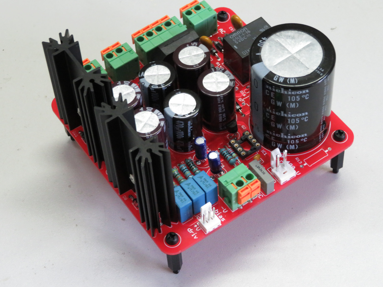

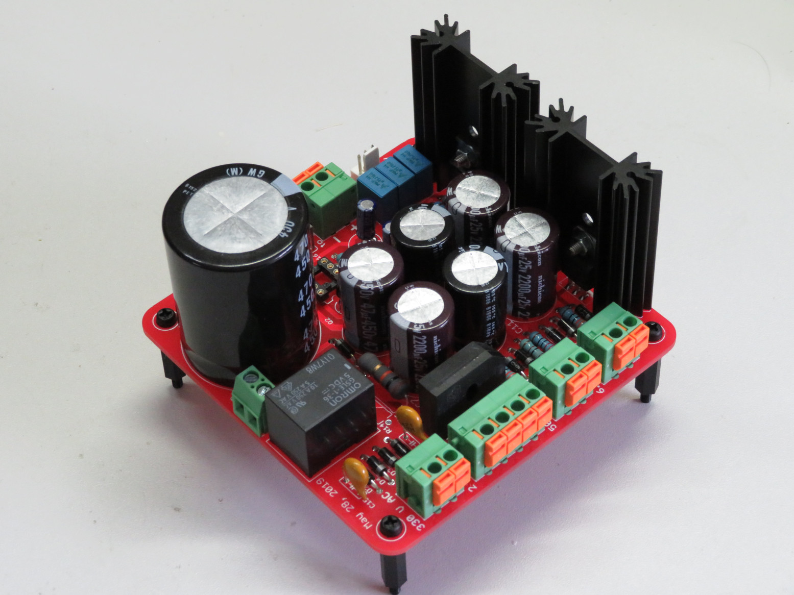

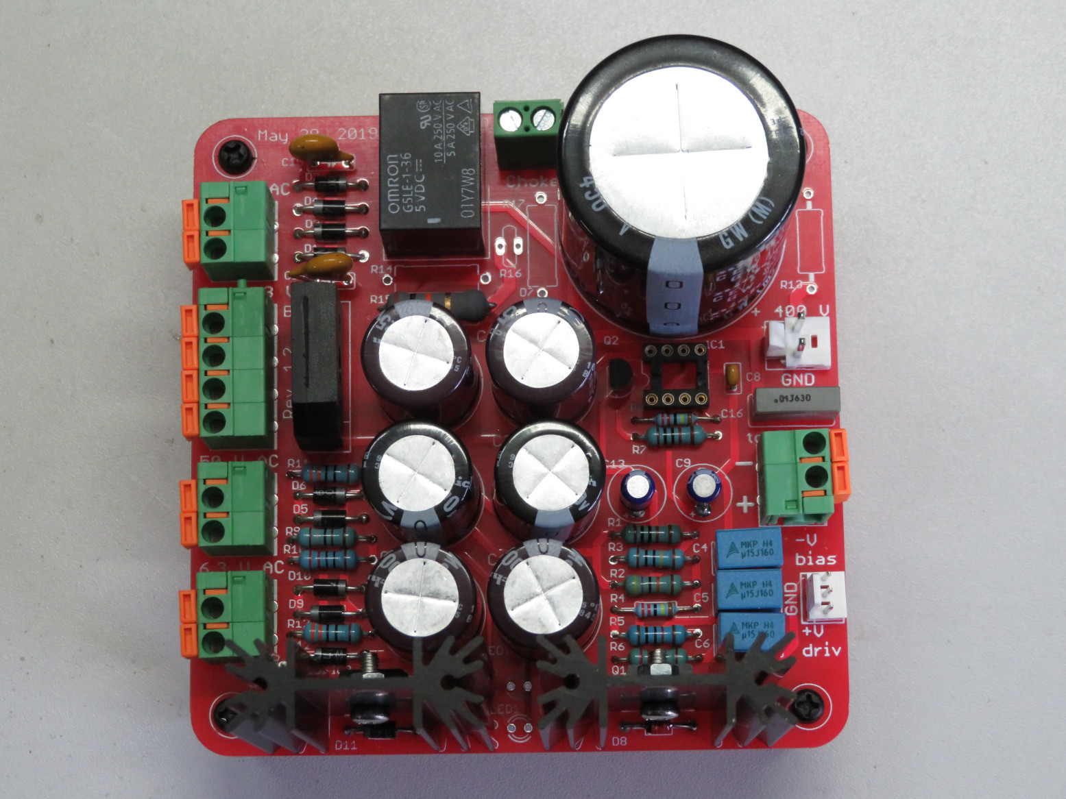

I have build the power supply for the Baby Huey MK2 and during the assembly I found a mistake, hopefully before powering the board 🙂
The capacitors C1 & C2 are in the wrong direction ! They must be mounted on the opposite direction of the serigraph 😱 I am a little bit surprised that nobody found this error 🙄
I have not yet started the tests because some components are missing, and I put a relay for the picture but I have only 5V version and I need to buy a 12V one...

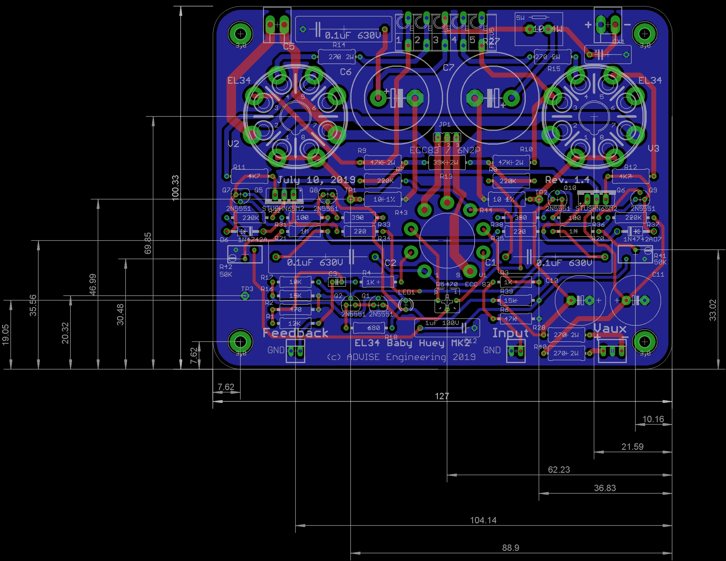

Hi Marc,
Have you sent the MKII PCB from schematic at post 478 for production yet?
From Schematic:
R41 and R42 (Bias adjustments) work in opposite directions, you could fix that.
Ideally clockwise adjust should mean increased idle current, that is, decreased -ve bias voltage .
Normally on pots data sheets you see pin 1 and pin 3 at ends, pin 2 is wiper which travels toward pin 3 with clockwise rotation.
If that is the case here, then I think R42 is the correct way round, R41 needs pins 1 and 3 swapped.
Ian
Hello Ian,
I am pleased to hear from you after all that time and thanks to give me good suggestion as usual 🙂
I have not send the PCB files to production yet, I have been quite busy recently and I was expecting some feedback before to produce it... In addition, may be Prasi will make a GB if there is enough interest ? I have made the suggested modification, you will find the schema and the PCB below.
