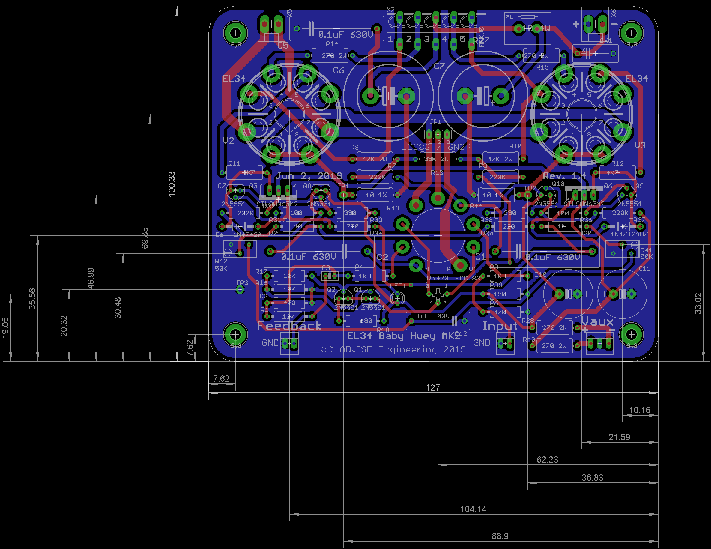

Hello Marc,
That's very nice indeed.
I have 2 general suggestions to make.
1. Those nets which carry high voltage, you can define them to have min clearance as per regulation , approx min 2.54 mm for 230VAC.
2. Pads can be made bigger for repeated soldering desoldering via the restring option in eagle under DRC setting .
Regards
Prasi

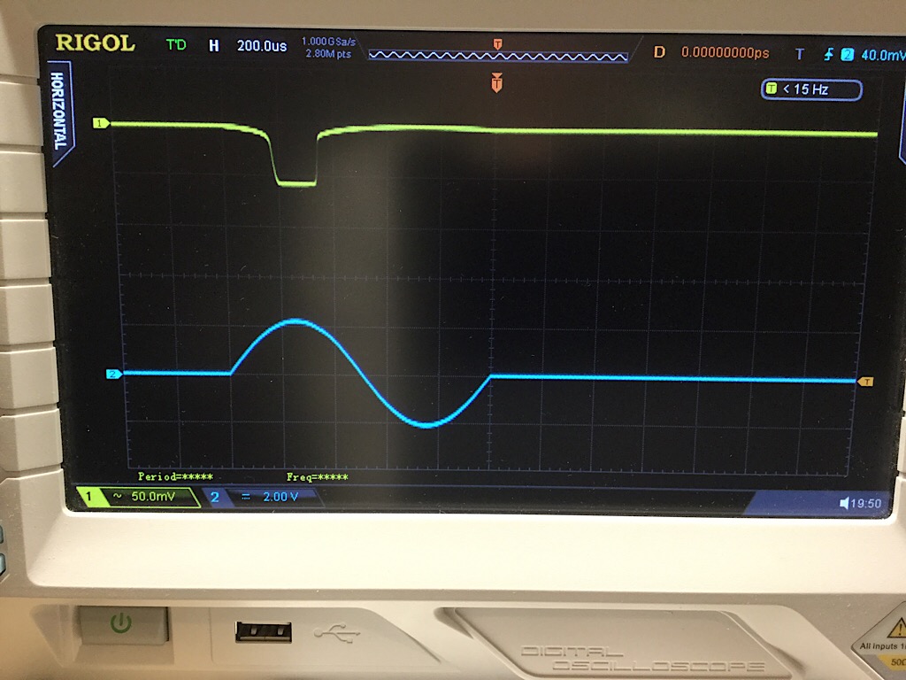

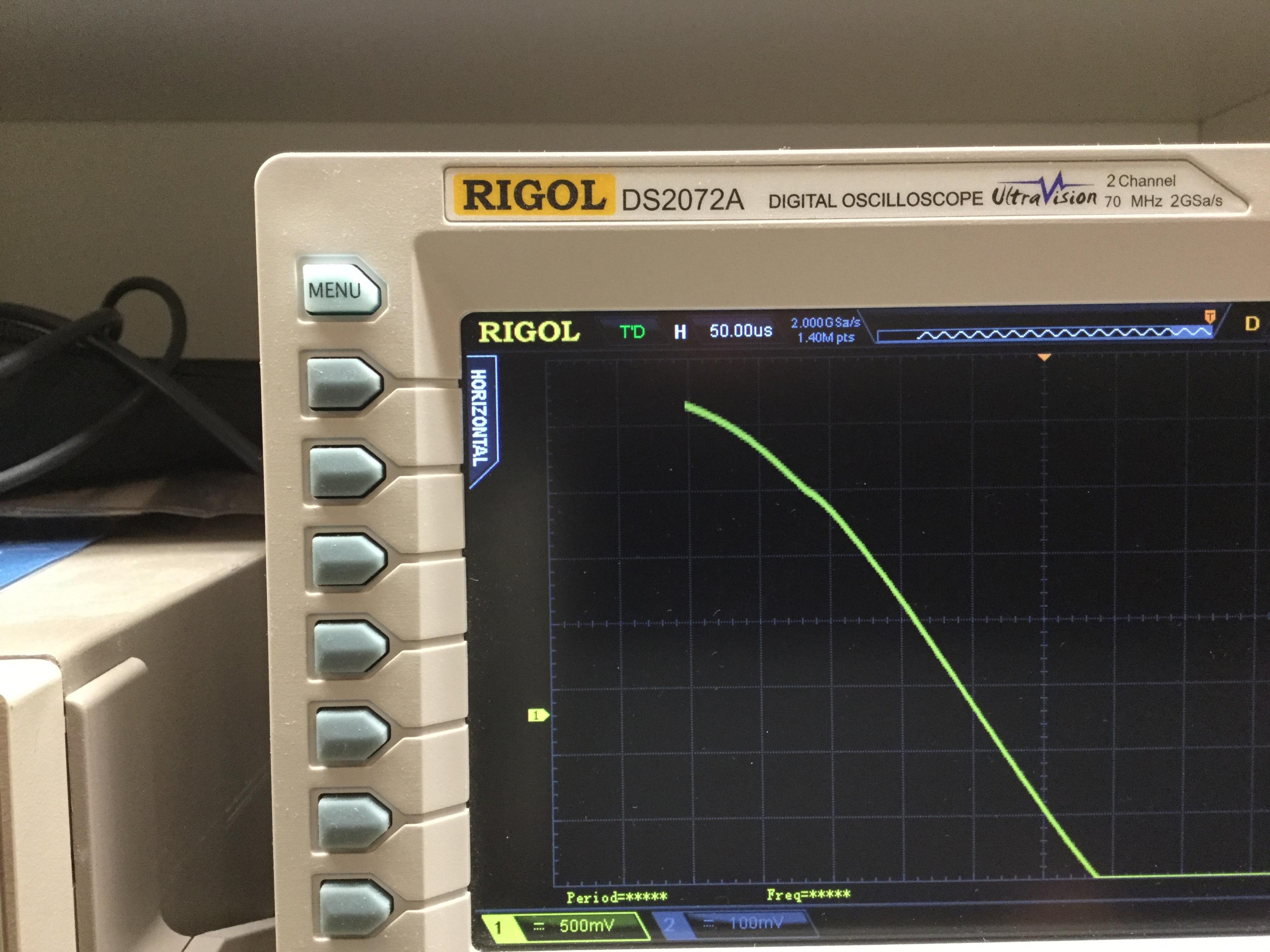

I got cut off by the 30 minute edit rule! I want to explain the 2 photos. The one on the left is the distortion in the speaker output waveform that occurs when you run out of - bias swing. The notch you see near the top of the close up of a sine wave. The one on the right (top waveform)is the voltage across the 390ohm current source resistor. The bottom one is input sine wave. You can see that the current source resistor voltage, which is analogous to current, changes slowly through the sine wave on either side of the positive peak. As the voltage output peaks the current is completely cut off. The other tube of the PP pair has the same waveforms on the opposite polarity of the sine wave.
I’m not sure what this sounds like but it is certainly not what we want to see in the output. Keep in mind that I was pushing the driver for max output due to my choice of tube HV and output transformer. After experimenting with KT88 at 450v 60ma, 425v 65ma and 400v 70ma I think I liked the lowerHV, higher bias current combo the best. Slightly less power output but that never seemed to be a concern for my speakers, room size and listening preferences. It sounded seriously good!

Hello Prasi,
I have followed your recommendation and slightly increase the restring from 25% to 30% but I cannot do more because it will reduce the clearance between track and pad 🙁
As you can see the board is quite full now since I want to keep it in the 10 cm per side limit ! I will send the Gerber files to the PCB manufacturer soon therefor tell me if you find some errors 😕

Hello Marc,
This is looking very good.
Amazing thing is you managed everything to fit on 10cm x 10cm. Congratulations🙂.

Hi Prasi,
Yes it was quite hard to fit everything in this size, but it was a good exercice and now the PCB are in production by JLCPCB 🙂 I changed from PCBWay after my last delivery problem with E-Packet and since I learned that JLCPCB was the same price than PCBWay of 5$ for 10 boards BUT they charge only 17$ for shipment by DHL instead of 25 !!!
I have also worked on the Baby Huey MK2 and I found that the layout was not completely symmetric and I had to move the tubes by 1.27 mm and therefor to move a lot of other components 🙁 Now I am close to finish it and you can see a comparison of the two version, remember that the first version was a top view while the new version is a bottom view with the serigraph for all components on the bottom.
Will you make a GB for the MK2 if there is enough interest 😀

Yes your design look OK, but I recommend to turn the Baby Huey board in the reverse direction to have the input triode not close to the transformer because the input stage is more sensitive to transformer magnetic field than the output tubes 🙂

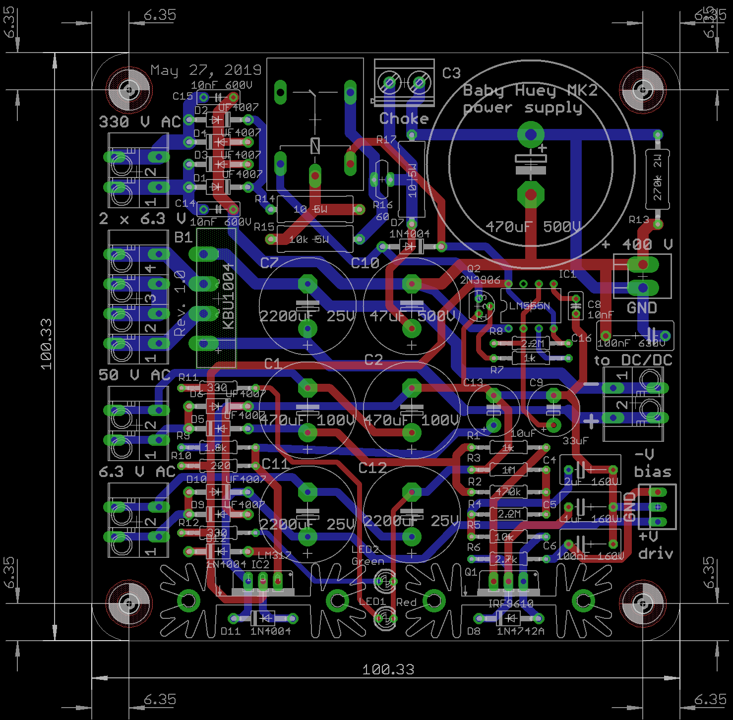

In the mean time I have made some more change on the MK2 PCB and I hope there is no error ? It is ready to be produced by Prasi if there is enough interest ? I made the modification suggested by bfpca and connected the MOSFET CCS directly to the +15 V and I increased the bias voltage to -100 V. I have also added a jumper to select ECC83 or 6N2P pinout for the input tube like in the last EL84 Baby Huey... I remind you that this version has not been tested but the schematic is the same except the two point explained before ! Anyway, I will appreciate if some of the expert reading this forum give me their feedback before we produce the PCB 😀
In principle I will receive the Power supply PCB soon and I will test it with the existing Baby Huey PCB (after removing the rectifiers of course) and let you know if it work well...
