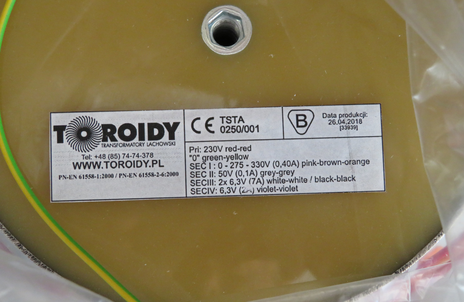

I will make a diagram of the wiring, this PCB has been optimized for the Toroidy 250 VA transformer...

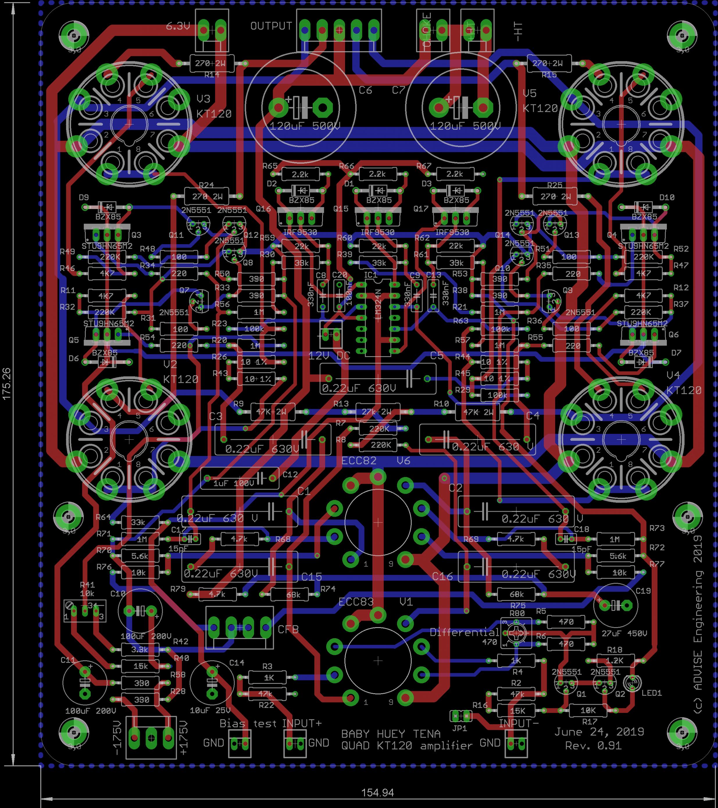

I send you also the latest revision of the Quad TENA / Baby Huey schematic since you helped me to make corrections on it. I have continued to check it since that time and will be testing it when I will have more free time. You can find the actual version in this post. I will probably replace the ECC82 by an ECC99 as suggested in your April 30, 2018 mail...

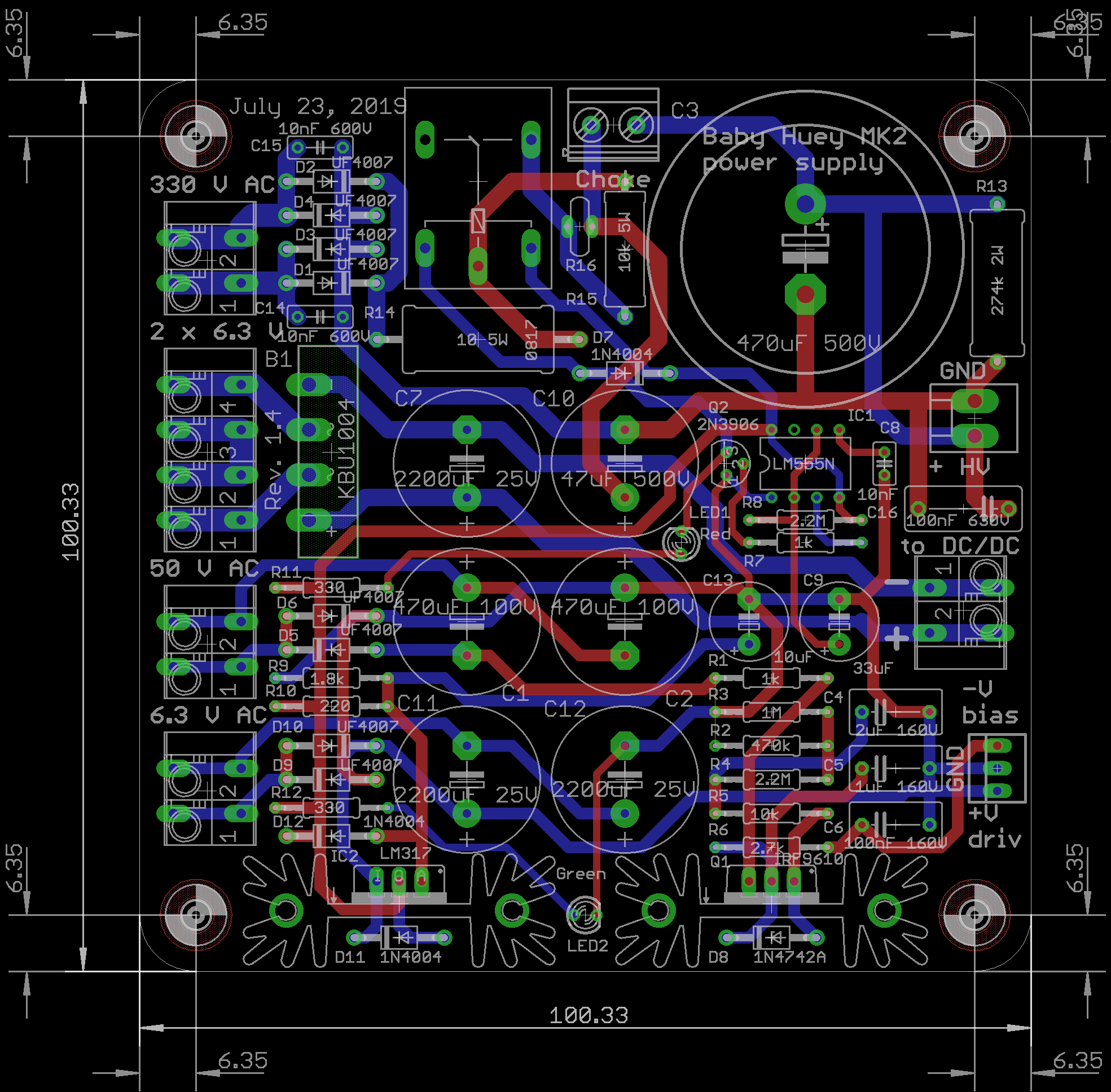

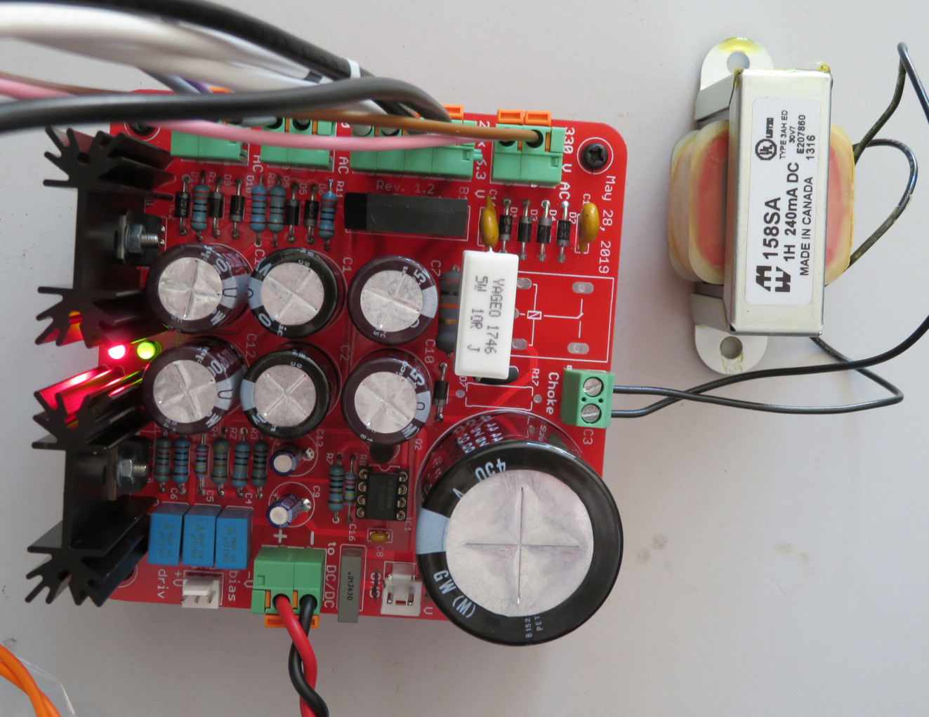

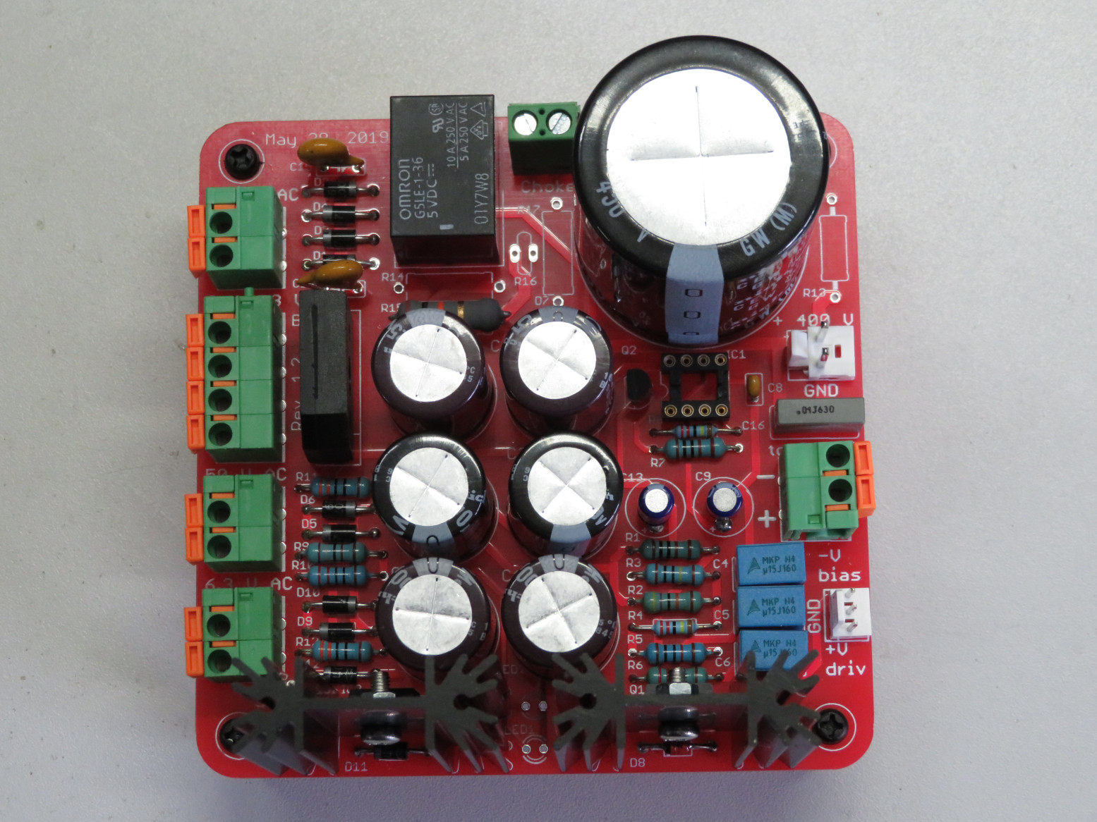

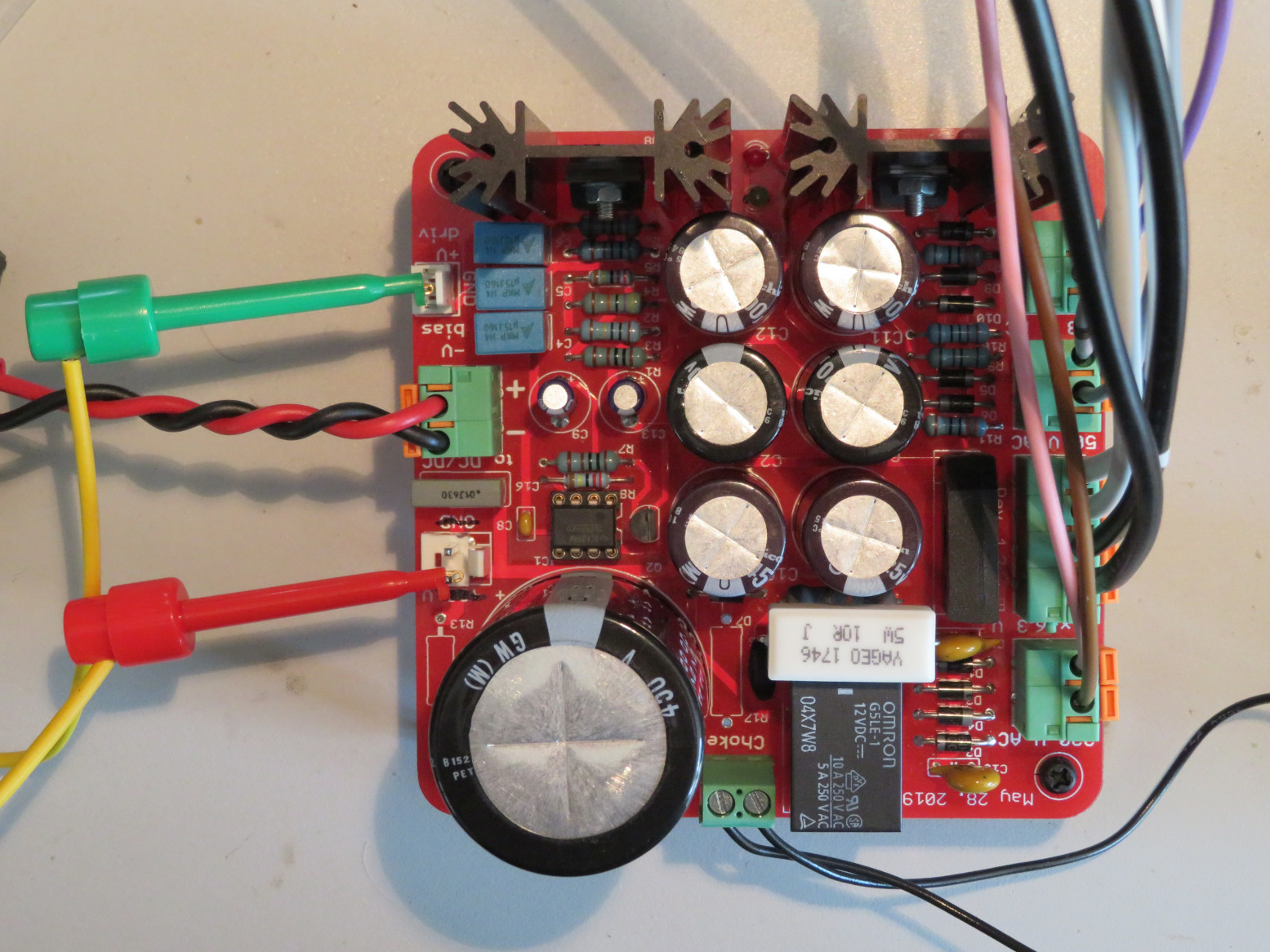

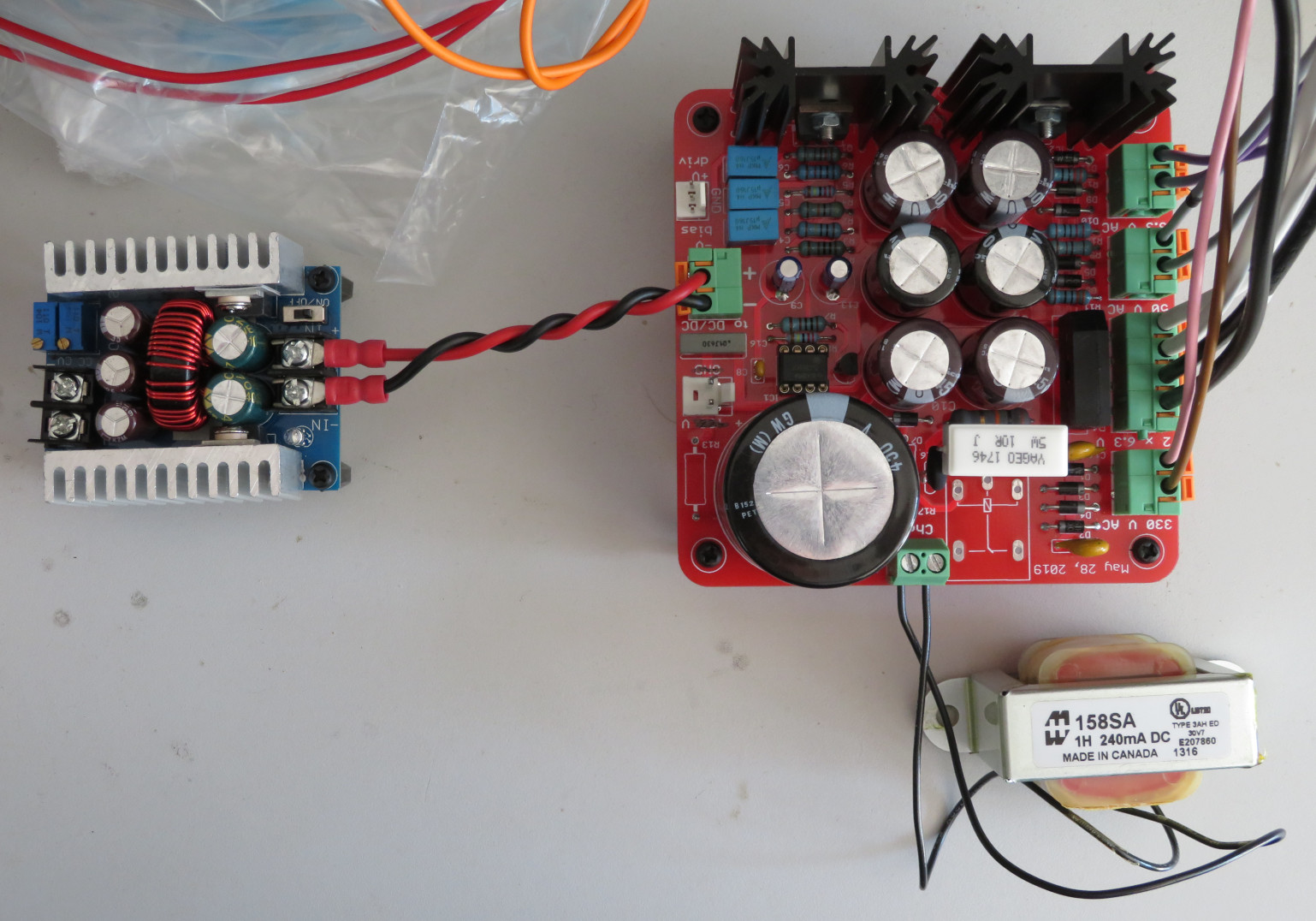

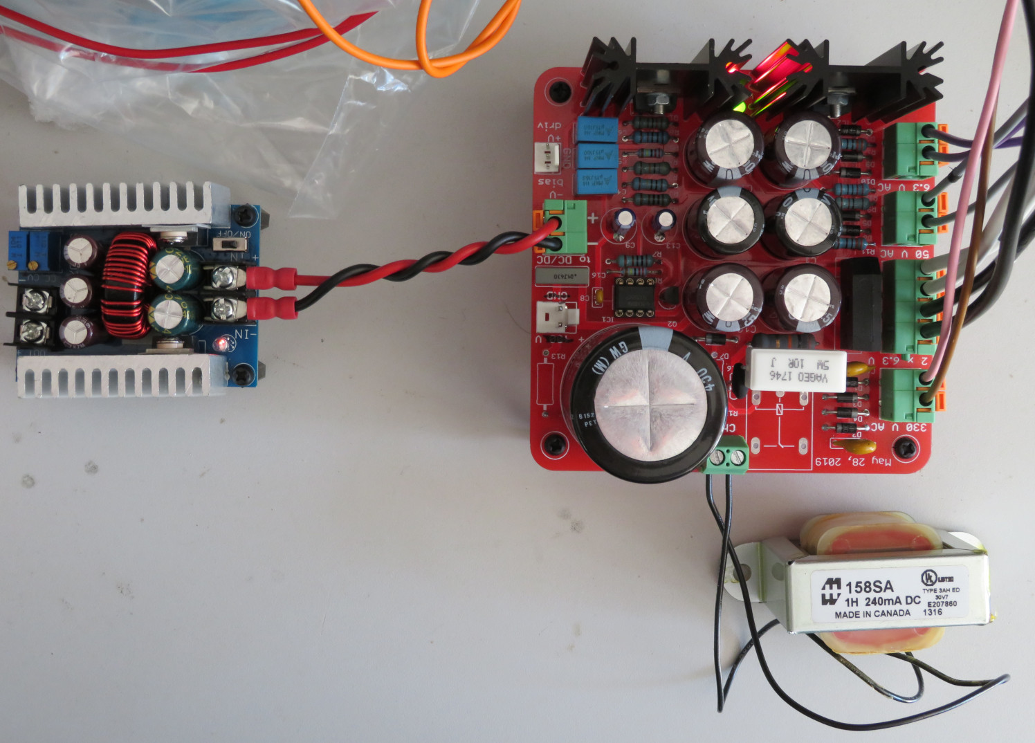

Hi all,
Before to send the Gerber files to Prasi, I wanted to test the Power Supply for the Baby Huey MK2 🙂
Beside the error of the capacitors of the negative power supply that I found during the assembly I didn't found any other wiring mistake bur only a serigraph error on the high voltage output connector where GND and +400 V were on the wrong side 😡
With the 275 VAC transformer output (I have only 450 VDC capacitors) I have about 435 VDC on the high voltage output without load.
With the 50 VAC I have -135 VDC voltage output without load.
The two 6.3 VAC 7A in serial give about 15 VDC to drive the DC/DC converter to generate 6.3 VDC for heaters.
The other 6.3 VAC 2A is used to generate the +15 VDC for the drivers and the 12 V regulator for the timer...
Marc

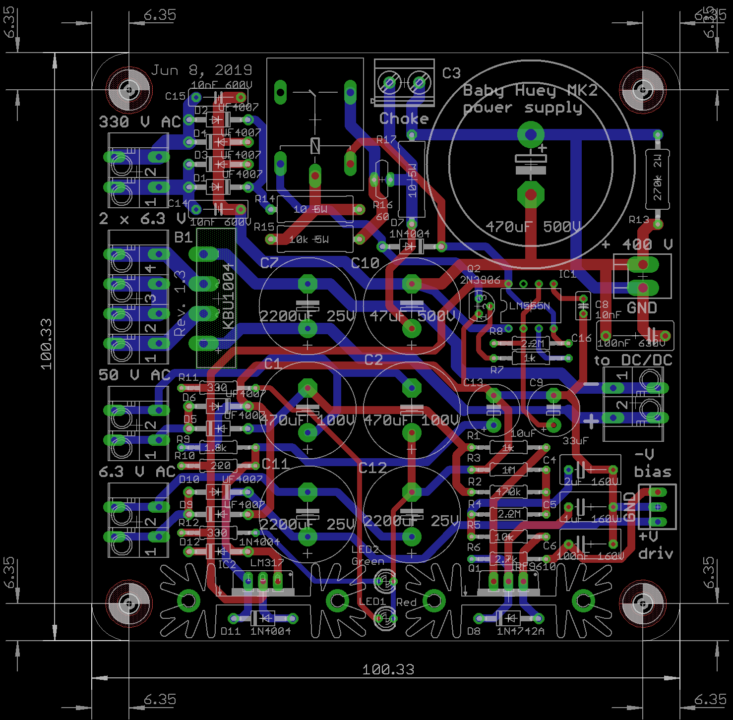

Hello Prasi,
Of course this PSU will be suitable for the EL84 Baby Huey with the right voltage value 🙂
In fact this Power Supply can be used with almost every tube amplifier with the following characteristics :
1) a high voltage filtered and delayed by a timer up to 500 VDC (340 VAC input max) with the right capacitors (for EL84 I will recommend 350 V)
2) a negative bias power supply up to -150 VDC (60 VAC input max) adjusted by R2 & R3 and regulated by the MOSFET transistor
3) a 15 VDC (with 2 x 6,3 VAC input) to drive a DC/DC converter to generate 6.3 VDC heater supply
4) an auxiliary +15 VDC to eventually power the MOSFET driver and a 12 V regulator for the timer logic
Regarding the timer, I have to check the value because I noticed that there was no delay, the green LED (power on with high voltage through a 10k resistor) turn on immediately, this is normal, but the red LED (high voltage fully on direct) is also on immediately which is not what I expected 😕
If you find an error let me know please
Ciao,
Marc

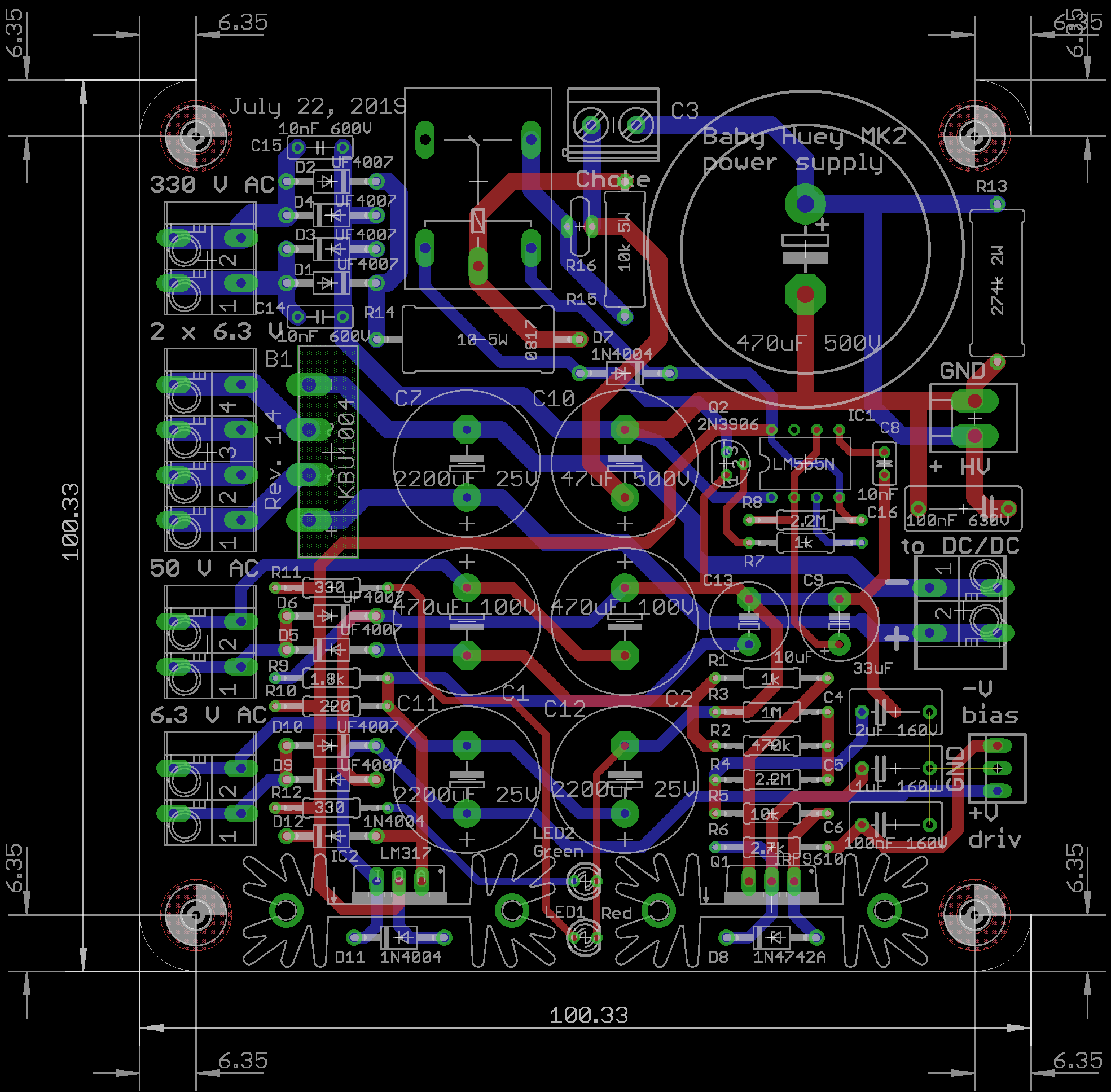

OK, I have corrected the LED and also found that pin 1 of the 555 was not connected to the GND 😡
Hopefully I should receive the relay tomorow and make a final check 😀
Here is the latest version...
As you can see, I have also increased the size of R13 & R14 🙂
Still waiting the relay sent Monday by Mouser, should arrive today (very fast from Texas to France 🙂 )
Any comments before I send the files to Prasi ?

OK , the relay arrived today as scheduled and I immediately tested it, and... it work 😀 The delay is 30 seconds which I think is enough to give the time to the tube heaters to warm up !
In fact the GND was connected to pin 1, but it was nod GND1 🙁 I had to connect them together, this will be modified on the final version but it is not critical anyway since all GND are connected together on the amplifier PCB 😎
Bye,
Marc
