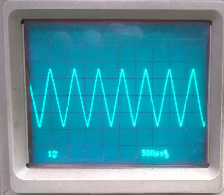

I started assembling it, but I started to get some weird oscillation when the global negative feedback wire is attached to output. However, when I removed the wire closing the negative feedback loop, it seemed to work fine:
Any idea where I should start debugging? I'm using Hammond 1650F output transformers.
You may have phasing wrong and are applying positive feedback. Try criss/crossing the O/P tube plate connections.

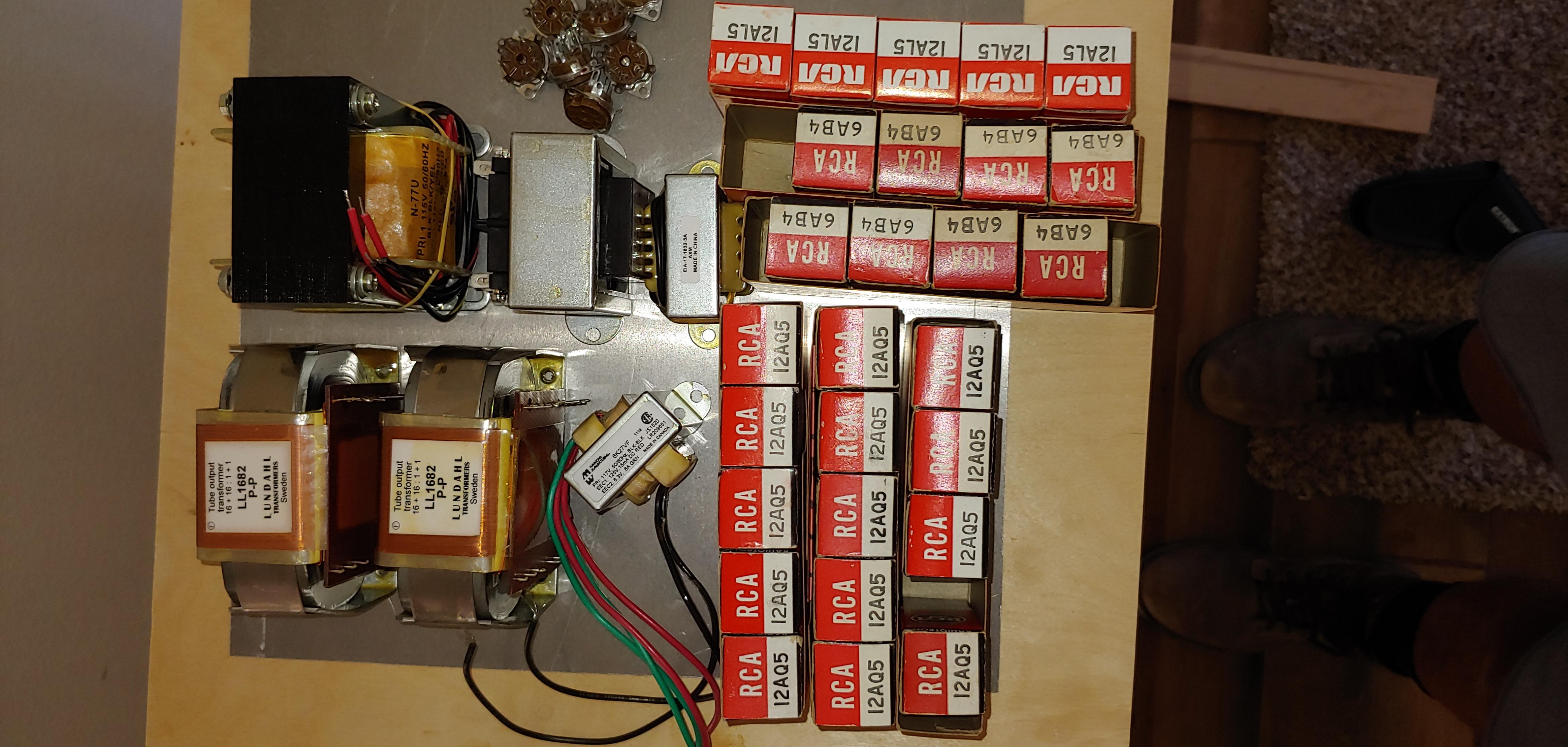

Hello All,
Please forgive my ignorance and lack of knowledge but is the phase splitting done in the power tubes because I was going to build this amplifier with four 6ab4's. It's easier for me to wire that way and don't know if I have matching/ability to check triode on the 6ab4's?
Thanks for the replies guys!
I didn't make myself clear as always! I have read where phase splitting can occur in a power tube which I will be using 12aq5 for the power tubes.
I would like to use four 6ab4's (1/2 a 12at7) as the driver tube and was wondering if they need to have matching triodes? I guess with CCS they don't need to match because the current is regulated.
Two cathodes that are connected to a common current source will have different currents, unless the tubes are very well matched.
Two cathodes that are connected to a common self bias resistor will have different currents, unless the tubes are very well matched.
Check what schematic you are using, to see if the cathodes are connected to either the same current source, or to the same self bias resistor.
