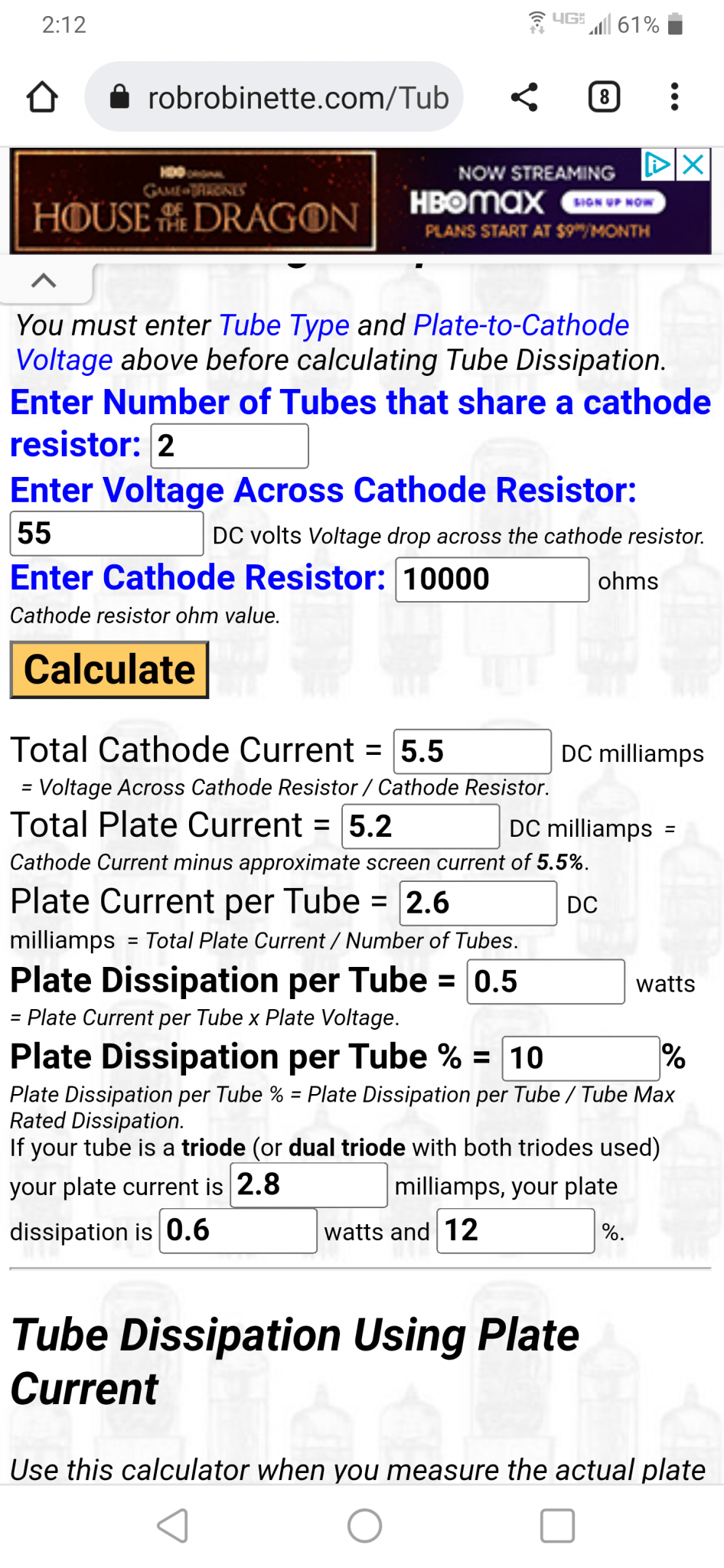

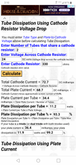

Sounds good and the numbers are really good.
12at7 followed by 12aq5!!!
