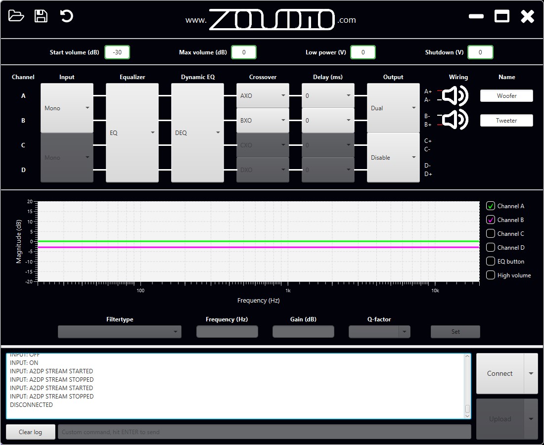

So I’m back on the case. I’m planning to biamp these with a ZOUDIO digital amp. Attached is a screen grab of what I have to play with. 13 EQs for the whole amp and a crossover per speaker with 5 settings.

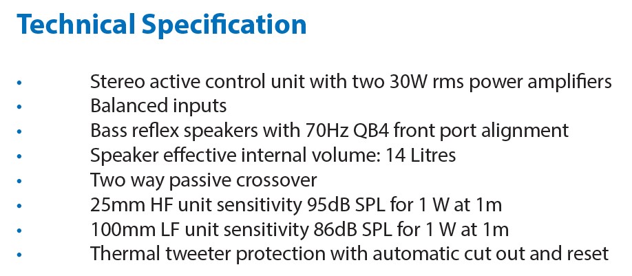

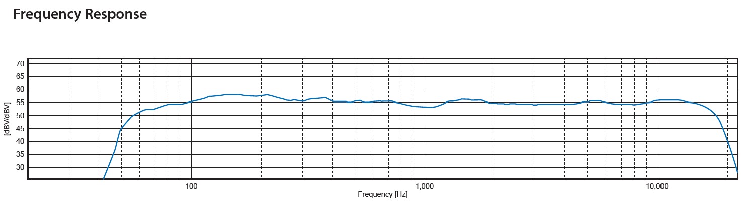

From Munro, the manufacturer of the egg shells we have these specs…
Some one mentioned the crossover frequency was 2KHz but I can’t see any mention of it in the manual.
I have a laptop with REW & MiniDSP UMIK-1. And I wonder if you good folk would help guide me through the setup. I thought it would be a useful exercise given that we know the end result ie Munro’s.

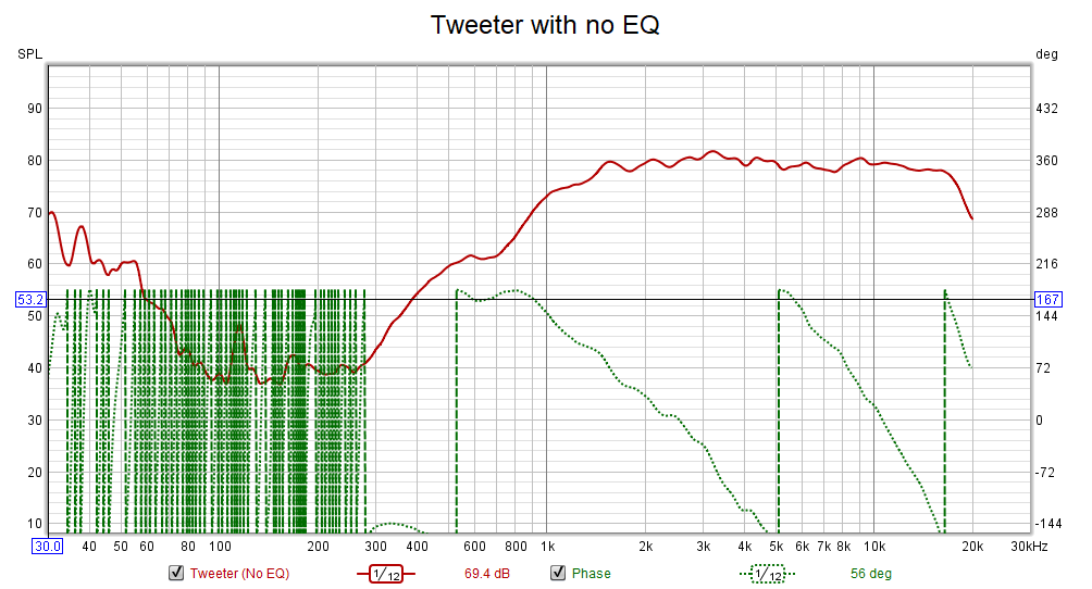

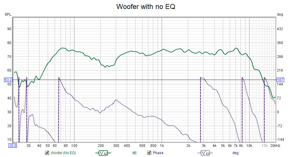

Measurement

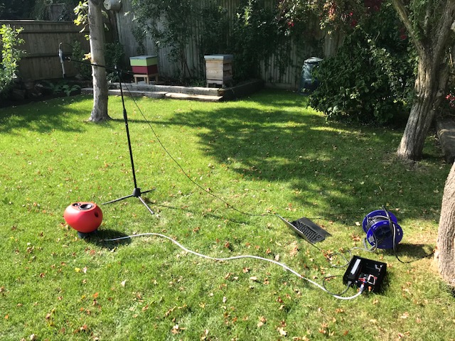

Not sure if this is the best or not but this is how I set up the speaker for measurement.
I took individual sweeps of both speakers.
And could see the tweeter was louder than the woofer so I played pink noise just into the woofer @ 76dB. Then did the same with the tweeter but that measured at 79dB. So in the crossover of the Zoudio I have dropped the tweeter by 3dB.
So what next? I guess decide the crossover frequency. The Monacor datasheet suggests 2.5KHz
