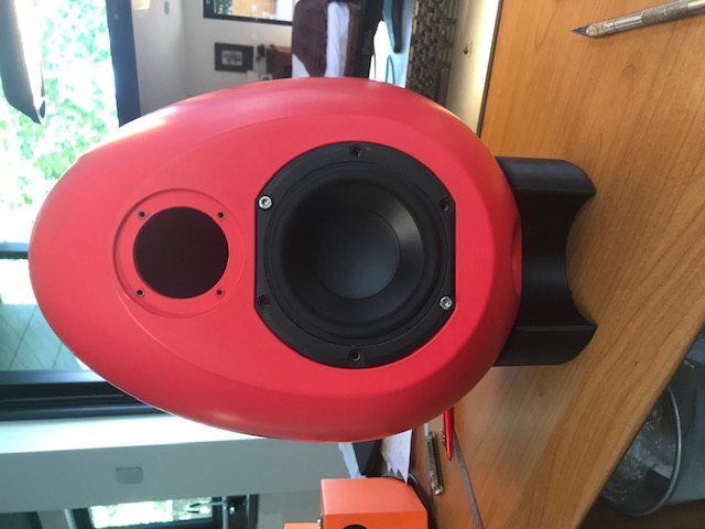

I have my devilish eggs in my work room and will take some pics, I measured them to be about 2.5 liters, I have some old jamo and pe full ranges to start one idea was to fire the woofer downward using some legs ,will see where the tweet tweet goes.

...Peerless 830870...
A good capable woofer. We use them in the uFonkenSET/uMar-KenSET wooferStands. They hit near 35 Hz F10 in a Woden ML-TL.
I figured they needed something like 15 litres for an optimum miniOnken alignment.
dave
...about 2.5 liters...
That is the volume of the uFonken/uMar-Ken so FF85wk, Alpair 5.2/3, and Faital Pro 3F22 should all work well. And no tweeter needed.
dave

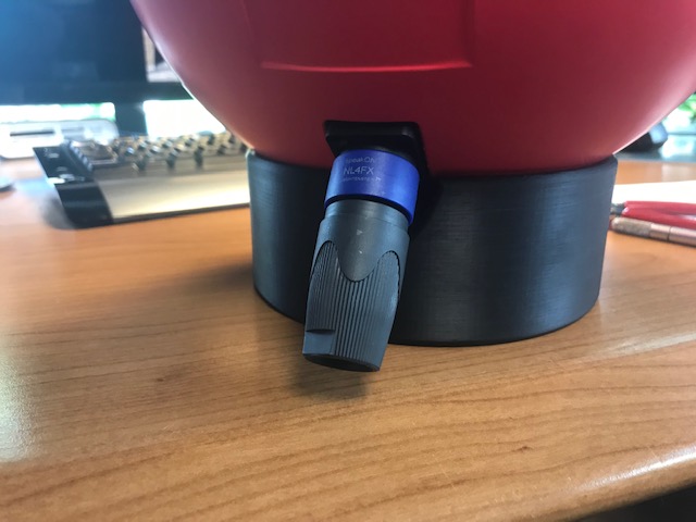

Edit: Just noticed the Egg 150s have a common ground connection for the drivers so they use 4 pole Speakons with 1 pole for the LED.

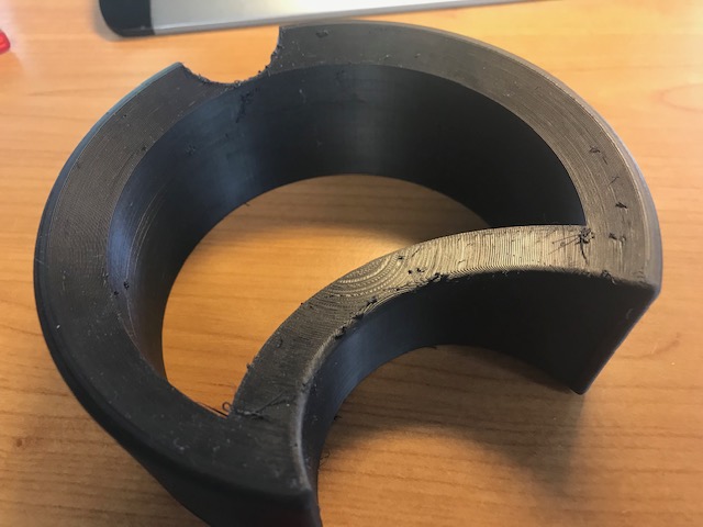

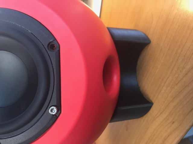

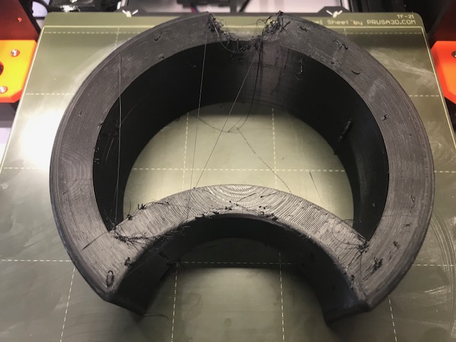

For me, this my longest print ever an epic 22 hours of hatching and my first ever printing with flex. Lots of stringing and print artifacts but some of that I should be able to tune out.
They have a honeycomb in fill and that makes them softer when squeezing from the sides but not so much from top to bottom.
The stands are soft and have the desired effect of preventing the speaker from sliding around as they do on the Orange prototypes.
Spose I'd better sort out the speakers next.
