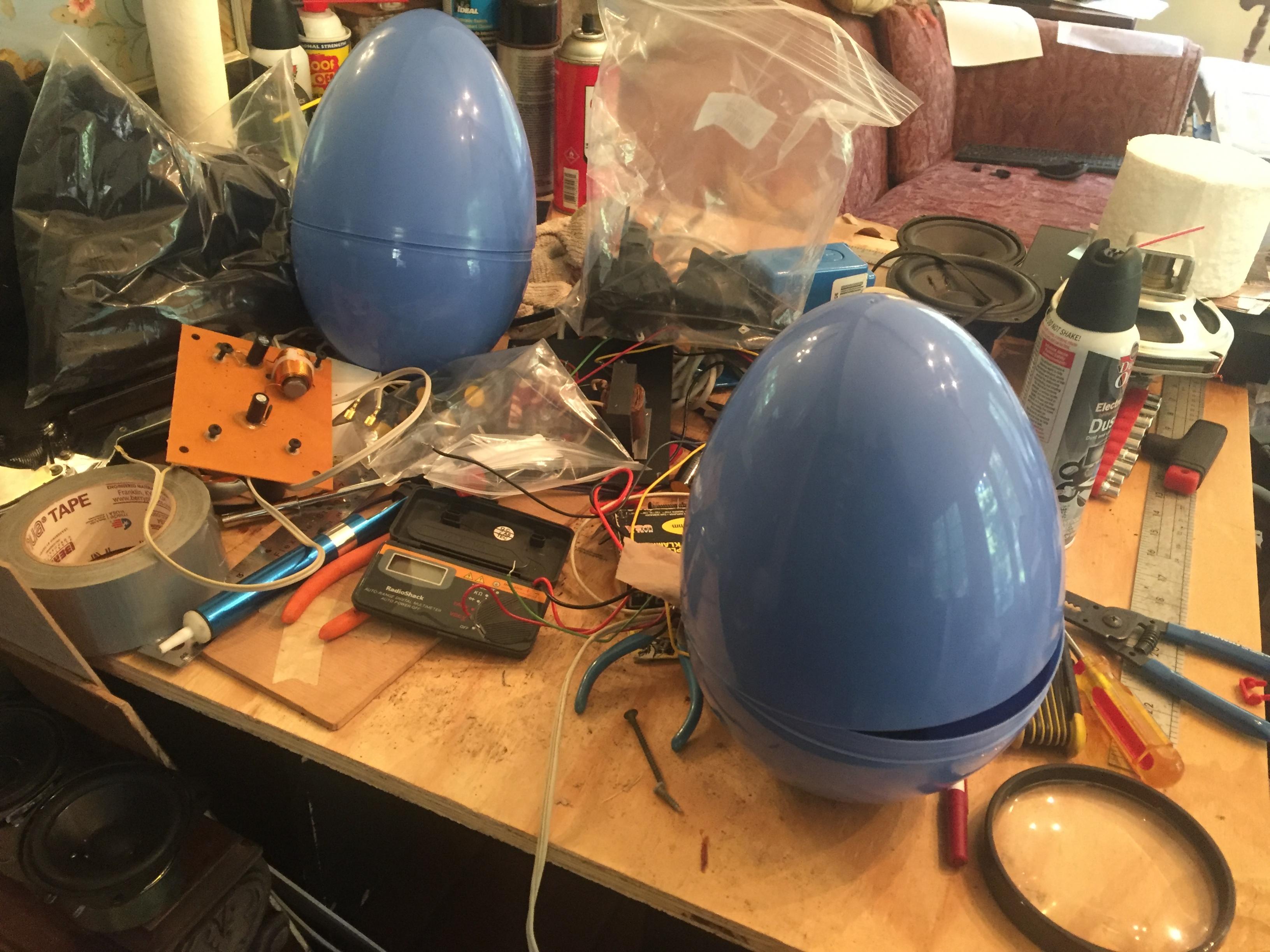

Such an eggcelent idea, I remember the focal egg speakers in the eighties, and funny enough I found these eggs at a yard sale and making a speaker for my jeweler friend,the idea being a Faberge egg design,right now I just put dynamat inside,eventually I will whip them up by fall.
That's not exactly a russian egg but that's nice : does the exact liter that is not given still important or the size gives you approximatly the volume then you tune with foam to increase virtualy the volume seen by the woof ?
Is that thick enough at this good price not to hear the bird to knock fro the inside (enclosure vibration) ?
