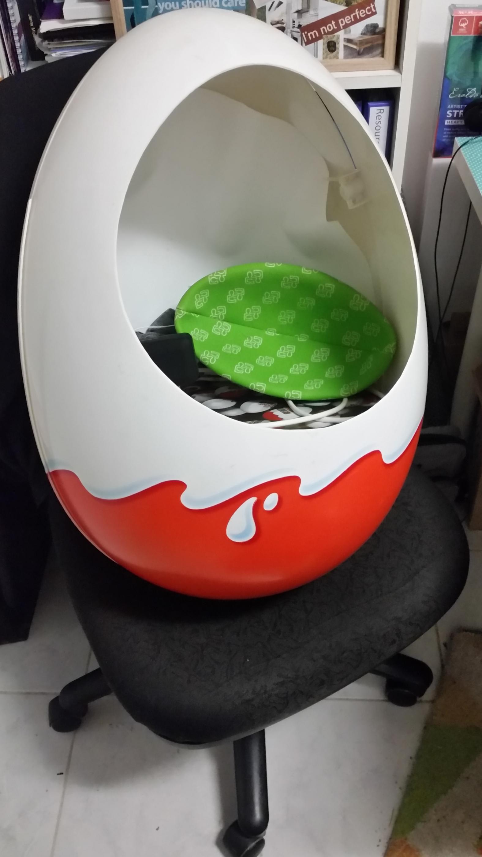

Quite a few complete Egg systems on Ebay, maybe more bankrupt stock. Looks like the rubber stands don't get on with the rubbery paint finish on the eggs. I've got two stainless steel cat bowls from my deceased cat that I think will make reasonable egg cups, maybe with some padding.

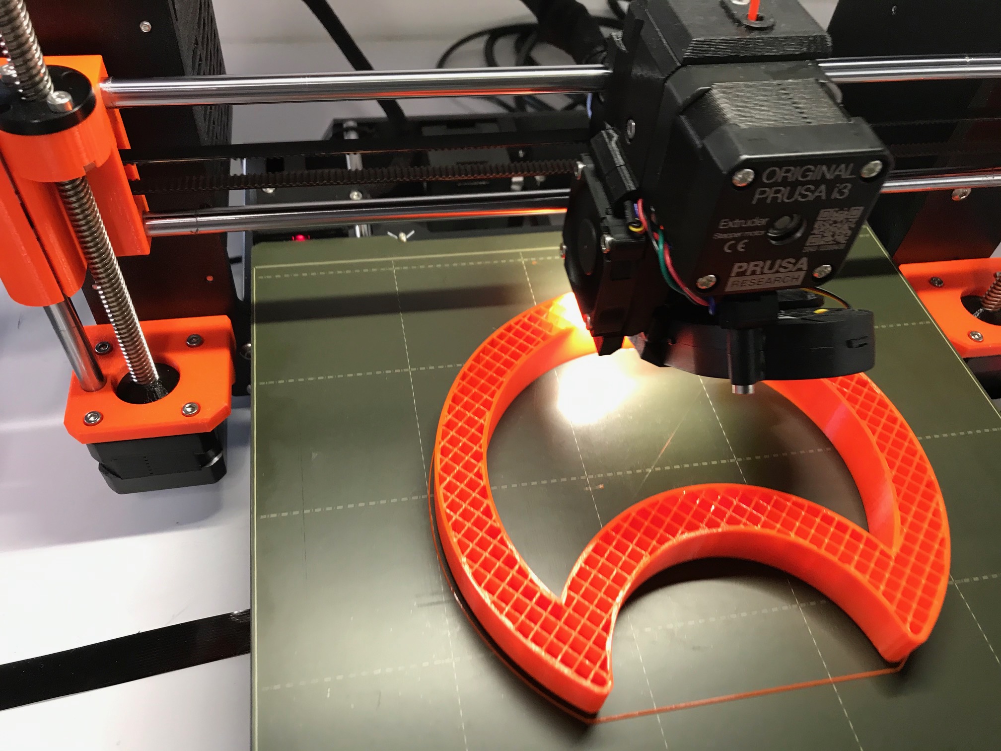

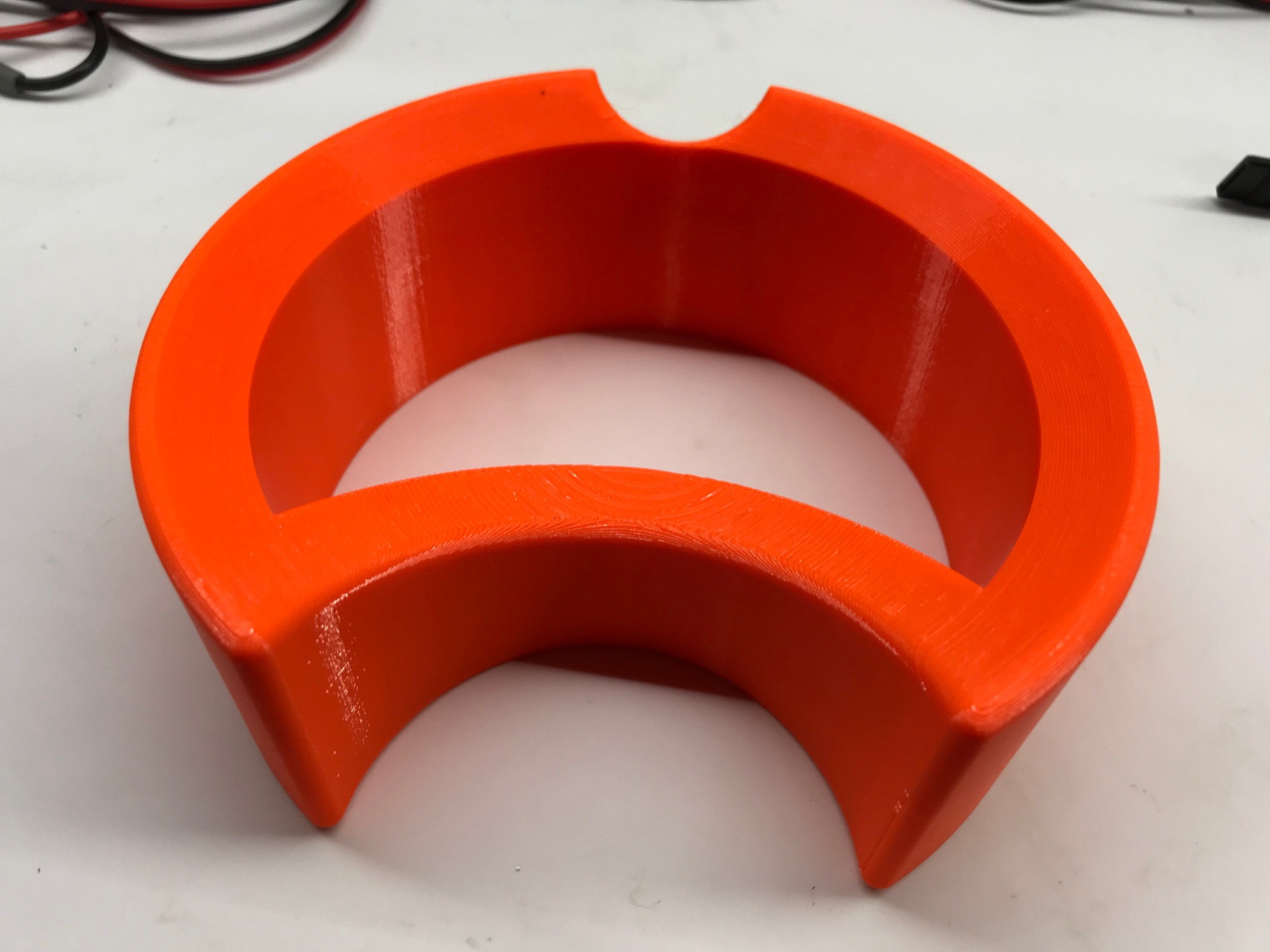

While I'm waiting for parts I've been designing a pair of egg cups. For now they are in a hard PETG for prototyping but I might look at a flexible filament although I have never printed in that as it might offer some damping and stop the speakers sliding around.

Ah, I didn't realise they were soft coated. I'll be repainting then for the same reason, it's a dust magnet, lol!

Nice idea with the stand!
I've got mixed impressions from reviews regarding crossover. Most give the impression it's handled within the amp but one or two have said it's mounted within the cabinet?
That stand looks great!

The stand was the best I could fathom from the pictures and my limited 3D CAD skills. The Egg does slip and slide so I have ordered some TPU and will see how my first flexible print comes out. Hopefully there will be some news later in the week.
That stand rules! I mean, it's egg-cellent. 🙂 With the first photo I thought it was silicone rubber because I have some rubber kitchen pads of the same color and pattern. Looking forward to seeing what you hatch in the way of flexible stands.
Cheers, I just printed it with what was loaded on the printer at the time, Prusa Orange. Filament wise printing is CHEEP its just very time consuming. These were printed in draft mode and took 5.5 hours each. It would have been a 13hr print if it were a quality job. I'm led to belive when using TPU it is better to go slower so we will see.
For now I have some stands to work with and stop the Eggs from rolling around. After all I would not like to break them, that really would be the last yoke.
