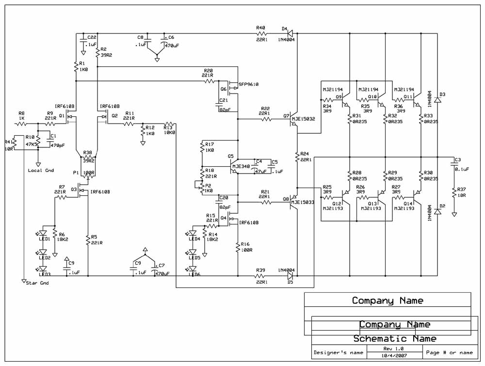

So to get a little closer to the topic, I have an issue with my circuit. At high levels, but below clipping I have audible distortion. It occurs at low frequencies only. My scope shows problems with very low frequency square waves which I will post. Even low frequency sinewaves clip in a strange manner.
The amp is only down ~1.6DB at 100Khz and 3hz. That is testing with a sinewave at 1W to 170W.
Here is the circuit below, with any changes I have made since last posting it.
Thanks, Don
Thanks, Don

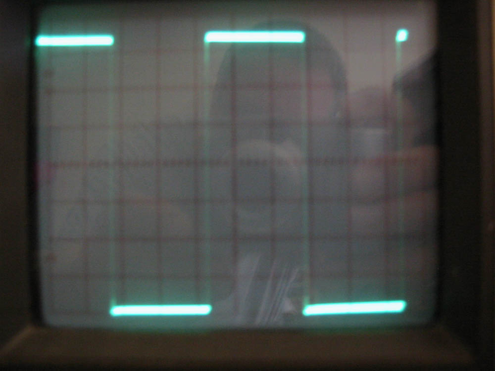

Here is the same input level trying to generate a 20hz square wave at 93V P2P into 8R0. It shows significant overshoot, (my best estimate is ~30%) causing clipping and an extreme tilt at the tops of the waveform. Even at (way) lower drive levels it still overshoots and tilts as demonstated by this scope shot, though without the clipping issue.
Were is the problem, and how can I fix it?
Help?
Thanks, Don
Help?
Thanks, Don
Hi Don,
That's not overshoot.
Something is collapsing. Your signal level is not maintained for some reason.
Use your scope triggered on that waveform and poke around looking for something else that is also collapsing. Do not overlook your supplies. I know, I don't see a classic ripple on the tail end, but it's still worth a look. Also look at your grounds for signal that shouldn't be there.
-Chris
-Chris

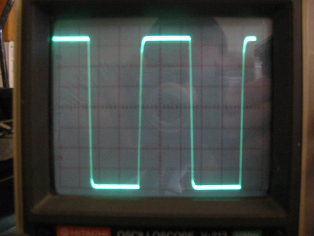

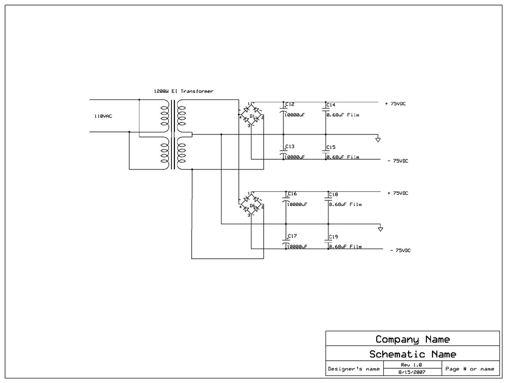

I really appreciate the help. However I am a little lost here! I noticed the problem on music and followed up with testing. Why should the amp have such poor LF performance? It is direct coupled! If it were very low capacitance on the power supply or a small transformer I could see the problem! Maybe! You have not seen the power supply, or the fact that the electro caps are circa 1984. I will post that below.
There is severe square wave tilt at just 1W of output at 100hz. Maybe it’s the caps? The amp can do +110V P2P before clipping at 1Khz and above.
Maybe there is some math that can help determine the caps values/function. The circuit draws ~350ma at idle. What kind of ripple voltage should I be looking at with this supply at idle, given my circuit?
Don,
This points to a topology or dimensioning issue. At 1W it cannot be the power supply!
Have a look at the voltage amp, then consider the current sink which supports it. Make sure the currents in the LTP are balanced at idle; this is very important. Compute the currents in each arm by measuring voltage across the tail resistors.
I doubt you need three series LEDs for voltage reference; two is usually quite sufficient with mosfets.
One further possibility; the direct coupling to the gate of the fb mosfet could be causing latchup at low frequencies. Try inserting a 470uF cap from the shunt fb resistor to ground.
Hugh
Hugh
Hi Don,
Just for grins and giggles, would you please post a shot of your supply ripple? Please include the ranges corrected for your probe (the actual scale factor).
-Chris
-Chris
Hey Don,
What a nuisance. Rather limits the selection of music you can play on this amp. 😉
When weird things happen at small signal levels it means one of two things: a component or wiring fault or a stability issue.
I'm sure you've checked the wiring and had a look at the psu lines and so on by now. I'd also check the ground connections to ensure they are all ok and starred. No need to insert a cap in the fb.
Let me know when you've done this. I have a bunch of methods to sort any stability problems out.
Brian
PS on your scope photo of the 20Hz squarewave, is the waveform offset or is is centred on zero volts?
Brian

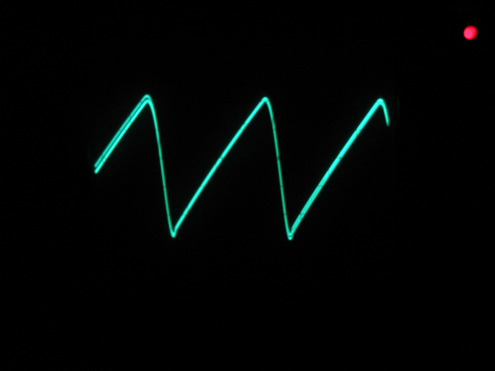

Chris here is a shot of the negative rail. The positive rail was inverted and equal voltage. The scope is at 5mV/division. P2P was 4 divisions, so 20mV P2P. The amp was at idle, which means it was drawing about 350mA from the supply.
I will bet there is some math to calculate the value of the filter caps from this information! I just don't know how to do it.
Thanks, Don
Thanks, Don

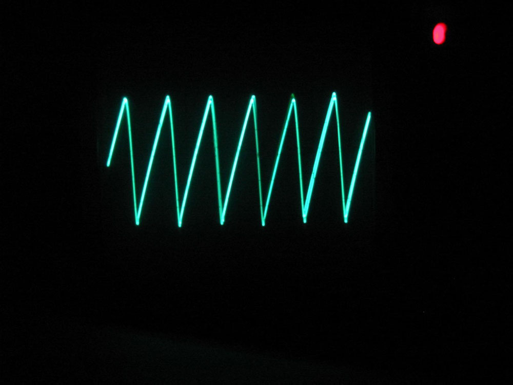

Hi Don,
Could you please expand the time scale so we see 2 cycles maximum? I want to see the leading edge of the ripple.
-Chris
-Chris
Hi Don,
Thank you!
See that elongated peak, or "pip" on the most negative portion of the waveform? That is what I look at to determine if the caps are okay or not. Yours look old, but fine otherwise.
-Chris
Thank you!
-Chris
