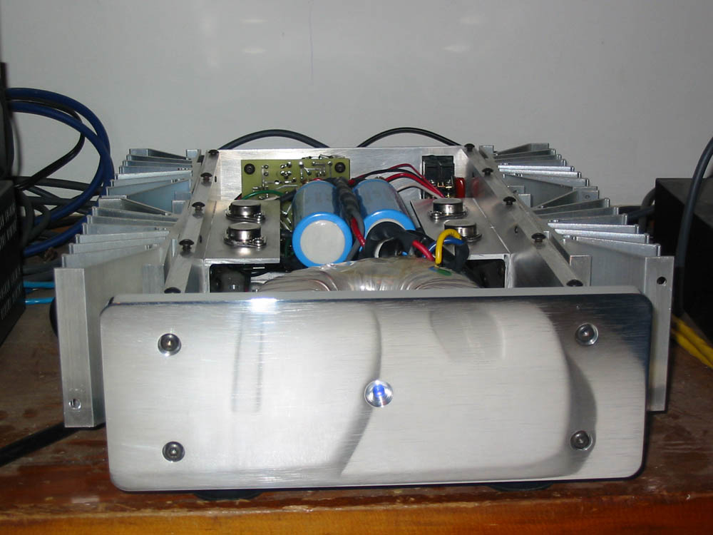

I have several preamps😀
The one I was using last night is a Chinese knockoff of a Marantz 7C. I couldn't build it for $168US. I stole it out of one of my other systems. Where it was connected to a pair of monoblock Pass A40's I built. (See picture below) The A40's drive a pair of B+W CDM1SE's.
The speaker I was using last night was a Vandersteen Model 1.
