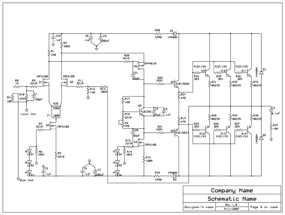

EF Output Stage
you already have three posters telling you that 3pair on +-75Vdc is not too clever with speaker loads below 4ohms.
The drivers look as though they are ticking over at about 13mA to 15mA. A big sink will help them out.
The base resistors are a bit high. They will pass about half an amp peak transient current into a 4ohm speaker load. That will drop about 1.7V. This will lead to increased distortion.
I have used a minimum effective impedance on fast starting transients of about 0.35*nominal impedance, i.e.1r4.

I understand some of the compromises I am making with 0R235 emittor resistors. The original amp had 0R1's! I have designed a low feedback FE and also plan to try and take the FB from the drivers not the outputs. In that case the emitter resistors need to be as low as reasonably possible.
Any thoughts on my changing the FB point?
I could have reused the old Sankens, as there was nothing wrong with them. I wanted to update the devices so replacements would be available. IMHO the 2119x devices are superior to the devices removed, from a SOAR point of view. It was also the first time I saw a data sheet with distortion spec's for audio use.
The original ckt also had what I thought was a strange value for the driver's emitter resistor. (33R2) What are the upsides and downsides to this low value?

With only three pairs of output devices, 0.235R will be fine. At peak output currents they will be dropping well over a volt each, which is more than enough to ensure adequate current sharing.
With regards to bias current thermal stability, it all depends on how much bias current you can run.
The higher the bias current, the greater the stability. Even OR1 would be fine with ~100mA per device.
I’m building an amp with +/-80V rails, 15 pairs of devices and 0.2R emitter resistors, but it dissipates a lot at idle.
If you want to take the NFB from the driver stage, then you probably would want a high bias current to keep distortion low. How big are your heatsinks?
BTW, 3 pairs of MJ2119X devices on +/-75V rails is still very low, even for 4 ohm loads. If you’re going to replace the supply filter electrolytic capacitors, don’t add a lot more (if any) capacitance than what the amplifier originally had.

Here is the full circuit below. It works, and think it sounds good too! I have used fets in the voltage amplification spots because they are voltage to current devices. Bipolars in the current gain stages because they are current amplification devices.
I took the original 5 stage amp and reduced it to 4. I spec'd very robust mosfets to handle the voltages and currents needed to do this. There is 9mA running through the LTP and 20mA though the VAS.
The only issue I would really like to solve at this moment is that the initial DC offset is -350mV. This drops to -100mV in ~6minutes. After about 20 minutes It will maintain an offset of +- 20mV under all conditions.
Suggestions to reduce initial offset?
Please take a look and feel free to make suggestions for improvement.
Thanks, DonS
