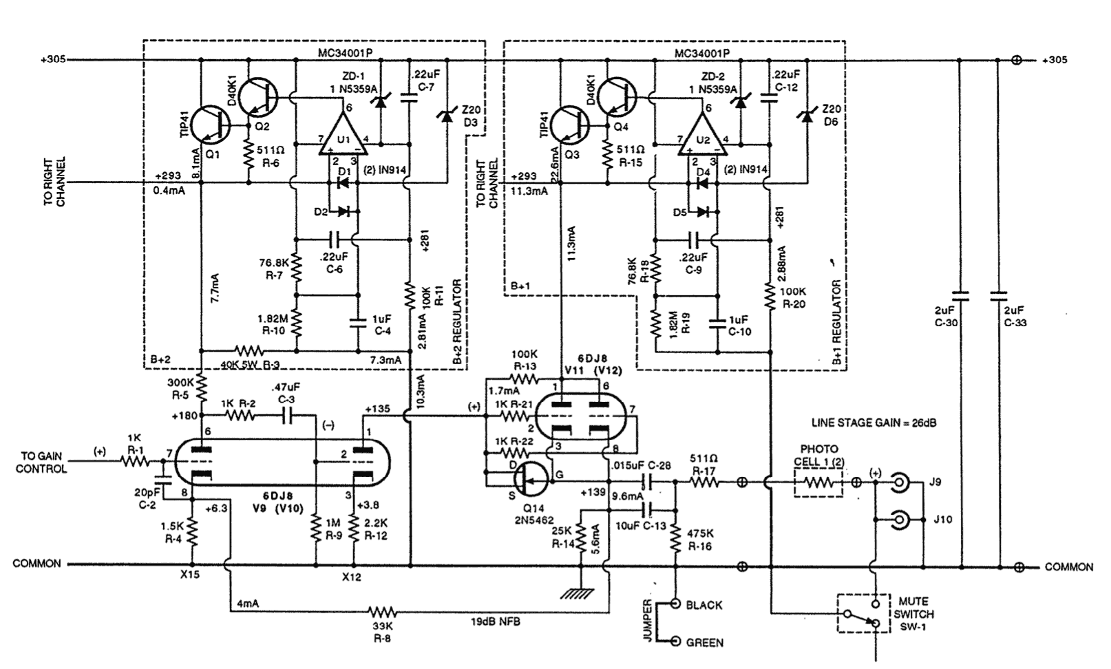

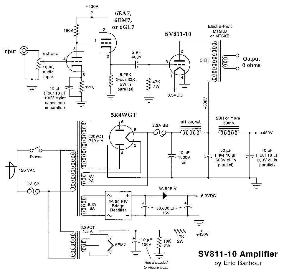

If you still have patience to spare, can you fellas review these two designs, they are both ‘on my drawing board’ for construction and both appear to contain the same topology in question although one a pre amp the other the front end of a power amp. Do you think I am safe in not using a diode in the manner we discussed above ?
I am not the original designer of course, but I believe both have been built by others, one being a commercial product. I am planning to duplicate the pre amp more or less as-is, but the power amp I will use different tubes as per my parts bin and I’ll be doubling-up to make it push-pull but it’s the same topology for the driver tubes and the tubes I’m using serve the same roles. Let’s take ‘worse case’ of SS rectifiers in both cases.

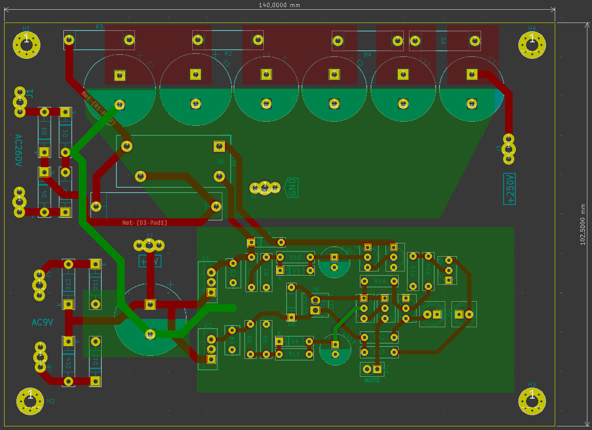

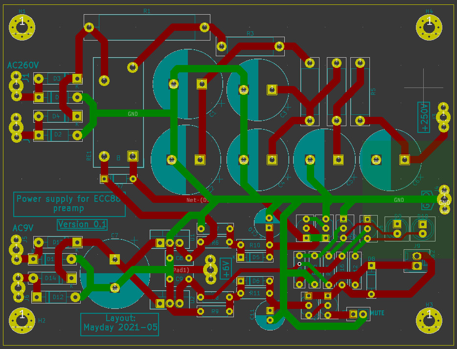

I started a first revision layout of that power supply board today,
In fact, when I looked, I had already collected 95% of the parts lol!
That's what happends when you have to many projects going at once and then from time to time life gets in the way and months go by before you look at a specific project again. I did put in an order for the parts I didn't have.

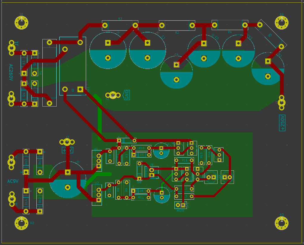

My first revision isn't all that refined as I started out with the intention on etching the board myself... I may, will most likely, refine the layout and have a boardhouse make 5 or 10 PCB's.
Keep in mind this is only a first quick and dirty layout.
As far as I could tell, the B+ part was, apart from being soft/slow started, a C-R-C....and so on design.Of course followed by the reg. circuit on the preamp PCB. The heater is merely dropped to 9V and the on the preamp board dropped to 6V. One could, if a low noise supply for the heaters is desireable use much better than 78xx regs.
Version 0.1 is because I usually do the routing at least 10 times before I feel it's good enough 😱

I did my own etching once, single sided first and a double sided later. It's rewarding to make it all by yourself but I found it hard to justify the effort once I had discovered those low cost board houses and so now I do as you are planning, just contract it out. I find board layout a relaxing and satisfying process, I think there is some art to it and I like to end up with something that pleases my eye as well as being technically good.
You might be able to thicken up some traces for the higher current paths, mostly those carrying charging pulses to rectifiers & their first caps. There should be minimal loop area for these high pulse currents to minimize their radiating somewhere you don’t want. Grounding is also key, mainly to avoid loops and to avoid sensitive circuits sharing any ground returns with high current parts. I think you can improve on your grounding, trying for a ‘star earth’ approach might be simplest, bringing separate earth traces to a spot near the ground connector. With a two sided board you have lots of scope.
For 260V there will be some guidelines you can search up on minimum distances between adjacent conductors.
I too noticed that the main supply has a belt and braces approach. By using a long set of RC filters, a valid approach used by Shindo, Kondo etc. there should be a clean supply but there is also a zener-regulated capacitance multiplier which will itself provide a slow rise B+ without relays.
I did my own etching once, single sided first and a double sided later. It's rewarding to make it all by yourself but I found it hard to justify once I had discovered low cost hoard houses and so I do as you are planning, just contract it out. I find board layout a relaxing and satisfying process, I think there is sone art to it and I like to end up with something that pleases my eye.
I too noticed that the main supply has a belt and braces approach. By using a long set of RC filters, a valid approach used by Shindo, Kondo etc. there should be a clean supply but there is also a zener-regulated capacitance multiplier.
I agree completely about the ground, as I wrote, this is just a quick and dirty layout. At first intended to be single sided, using jumper wires for the top traces.
I agree on the traces as well.
I spent maybe 2-3h on this, including the schematic. It's is very relaxing, and as you write...there's an element of personal touch/art to it as well. 🙂
The traces are just 1mm(1,5mm from the diodes to the resistors and caps), that according to google conversion is just above 39mils and just above 60mils.
If I can't get the traces to the width I'd like with a fairly compact layout, I'll add to the thickness of the Cu layers if/when ordering from a board house.
Being used to working with mostly surface mount parts, I try to make the boards as small as I can while still getting a layout that I'm satisfied with.
For me, doing layout is more relaxing than sudoku, mahjong...whatever.
I have chronic pain, and doing this takes my mind of it for a while.

V.0.2 of ? lol
I did another quick shuffle of the parts and routing.
Now most traces are 2mm wide, that is about 78.7mil.
I know I'm not there yet, but each time I re-do a layout (the same thing with just about every project) I learn something new. That is what we're in this crazy thing called DIY in the first place, isn't it? To have fun and learn things.
Anyway here comes the second quick and dirty layout.

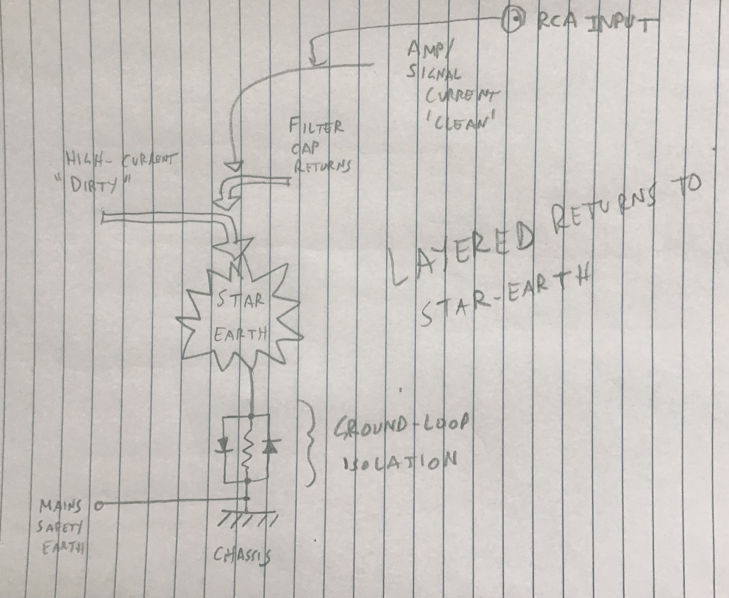

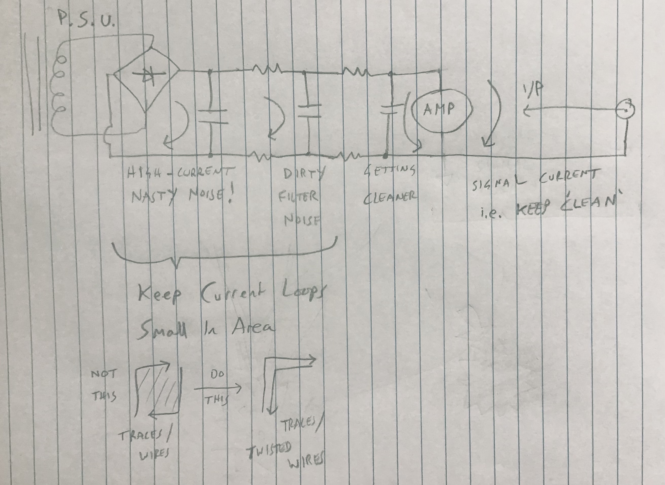

What I do is to layer the earth return traces according to how ‘dirty’ the are. I like to get the dirty currents sunk first, to a star ground (which is usually located at the ‘earth’ side of the PSU capacitor and where speaker return is connected if in a power amp). Then all the dirty currents are kept to a small loop local to the power supply. I then layer-on additional earth traces for cleaner signals. Of course, it’s not a ‘follow blindly’ method, but a starting point and depending on details maybe modified.
So on your pcb I’d be using all available area to fill copper over the connections for the diodes, main caps and connections to the AC supply from the power transformer. Keeping all those areas tightly grouped etc. In my layout software you can create solid polygons to make full use of the available space.
You have gnd returns coming in like branches of a tree but they’re coming in from filter caps and sensitive circuits all along the trunk. It maybe fine but I usually don't like to do that. You could create a local star ground point for all the small signal return currents and the tie that into the main star ground with one trace. I’d also move the gnd connector closer to the diodes/fist cap to keep high current spikes contained to a small area.
Some layout techniques work better with a ground plane, but you really need to be careful about cuts and return paths.
I hope you don’t mind my nit picking!

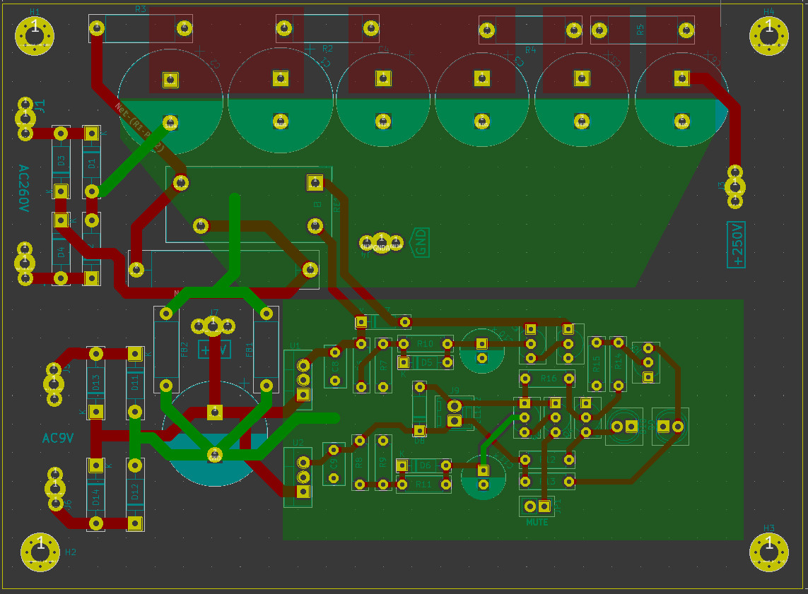

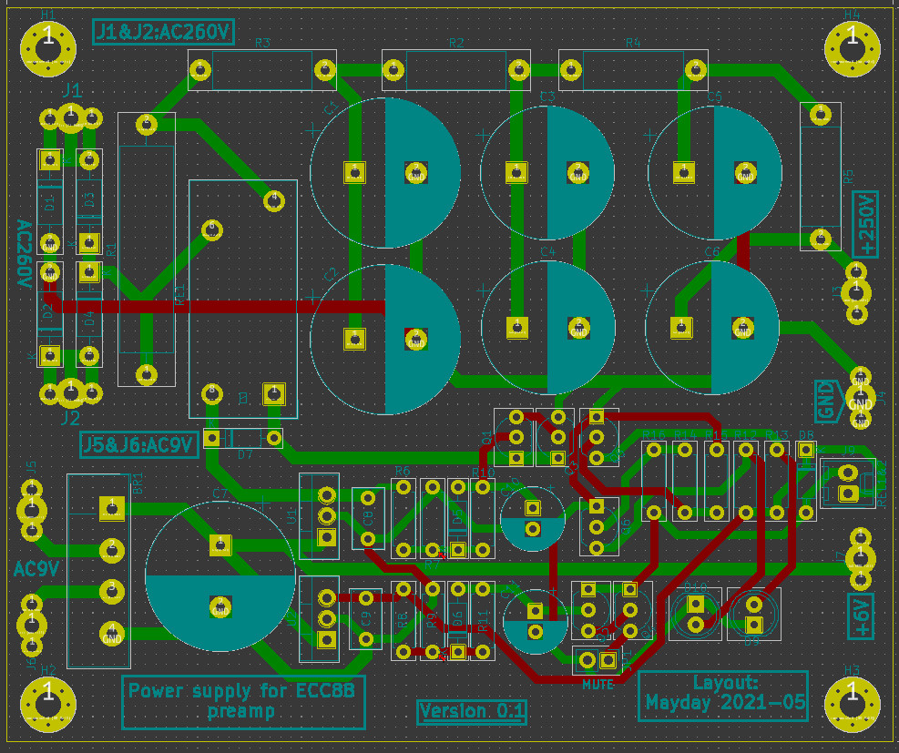

I decided to do one more before calling it a night.
I'm not saying it's much better, just playing around for now.
Dimensions are 150*120mm, so close to the largest board I've ever done a layout for, with the least amount of components as well lol.
The zones are clumsy and connection between them are ugly, but I wanted it done as I sorely need to rest my back (no pun intended).
Let's get some more constructive critique 🙂

I like the changes. You might be able to move that relay so that the first cap after the diodes at the top can be placed close to the diodes like you have it on the bottom. I’d pull back the gnd plane away from that 250V connector as high voltage needs space around it. Some of those red traces at the caps could be polygons too, these connections carry as much current as the gnd connections.

It takes me weeks until I’m happy with a layout, it’s even been known to require me to redo from scratch if the appearance troubles me. I only tape out once it feels right. I’d be hopeless as a professional because it takes me too long and I’d stop enjoying it. I have never been tempted to ruin my hobby by trying to make a living off it, assuming my stuff was even good enough for that anyhow!!
I suspect board layout for some of us is akin to calligraphy for others.
I made two versions this morning after having walked my daughter to daycare.
Lets call them option A & B, B being the one with ferrite beads separating the B+ GND from heater and timing/relay-related circuit GND.
