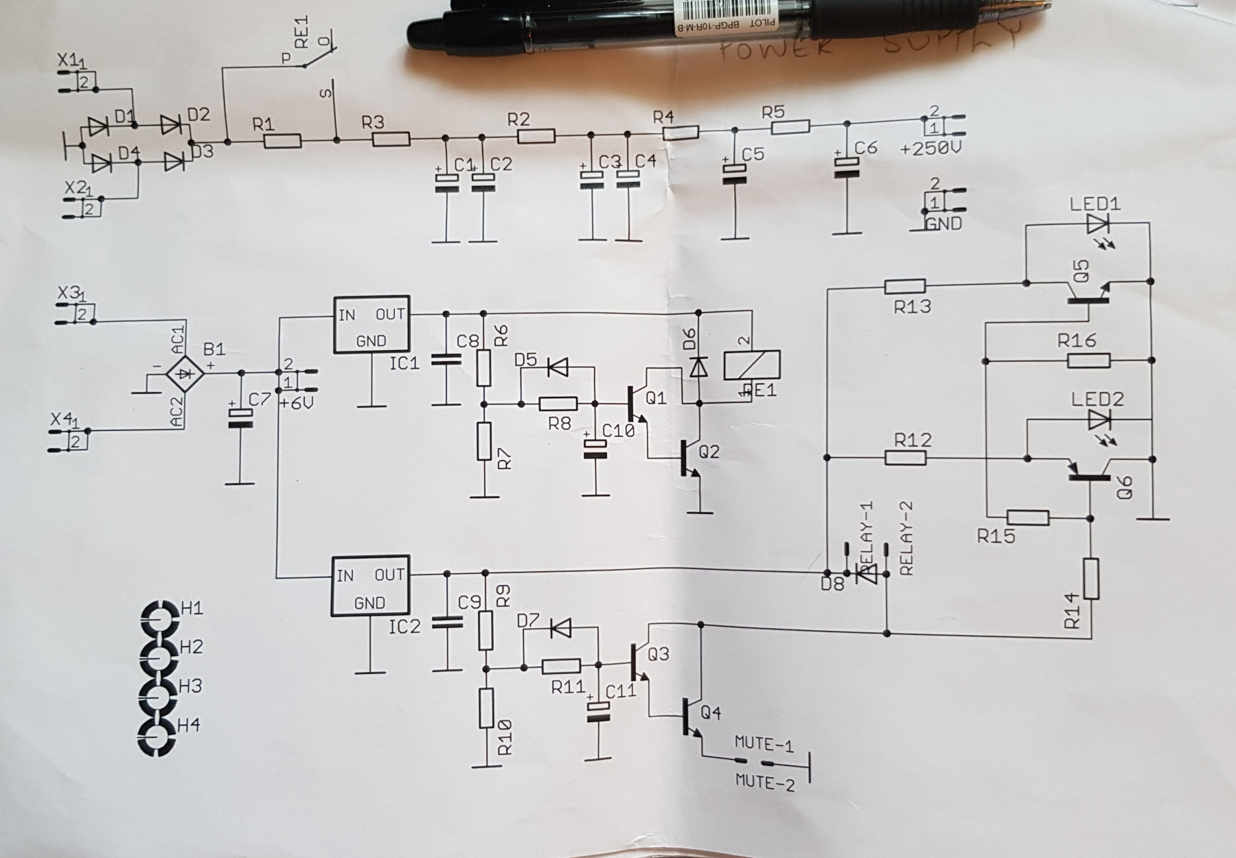

I just recalled that there was supposed to be a power supply, relay-timer board designed for use with the preamp board.
The seller was out and the listing on ebay was for the preamp board only.
I like this design, at least for first look it brings all the features asked, with slow start on B+, delayed mute, manual mute switch - could be useful as a pcb for other similar projects.
I started a first revision layout of that power supply board today,
In fact, when I looked, I had already collected 95% of the parts lol!
That's what happends when you have to many projects going at once and then from time to time life gets in the way and months go by before you look at a specific project again. I did put in an order for the parts I didn't have.
My first revision isn't all that refined as I started out with the intention on etching the board myself... I may, will most likely, refine the layout and have a boardhouse make 5 or 10 PCB's.
Keep in mind this is only a first quick and dirty layout.
As far as I could tell, the B+ part was, apart from being soft/slow started, a C-R-C....and so on design.Of course followed by the reg. circuit on the preamp PCB. The heater is merely dropped to 9V and the on the preamp board dropped to 6V. One could, if a low noise supply for the heaters is desireable use much better than 78xx regs.

You might be able to thicken up some traces for the higher current paths, mostly those carrying charging pulses to rectifiers & their first caps. There should be minimal loop area for these high pulse currents to minimize their radiating somewhere you don’t want. Grounding is also key, mainly to avoid loops and to avoid sensitive circuits sharing any ground returns with high current parts. I think you can improve on your grounding, trying for a ‘star earth’ approach might be simplest, bringing separate earth traces to a spot near the ground connector. With a two sided board you have lots of scope.
For 260V there will be some guidelines you can search up on minimum distances between adjacent conductors.
I too noticed that the main supply has a belt and braces approach. By using a long set of RC filters, a valid approach used by Shindo, Kondo etc. there should be a clean supply but there is also a zener-regulated capacitance multiplier which will itself provide a slow rise B+ without relays.

I agree completely about the ground, as I wrote, this is just a quick and dirty layout. At first intended to be single sided, using jumper wires for the top traces.
I agree on the traces as well.
I spent maybe 2-3h on this, including the schematic. It's is very relaxing, and as you write...there's an element of personal touch/art to it as well. 🙂
The traces are just 1mm(1,5mm from the diodes to the resistors and caps), that according to google conversion is just above 39mils and just above 60mils.
If I can't get the traces to the width I'd like with a fairly compact layout, I'll add to the thickness of the Cu layers if/when ordering from a board house.
