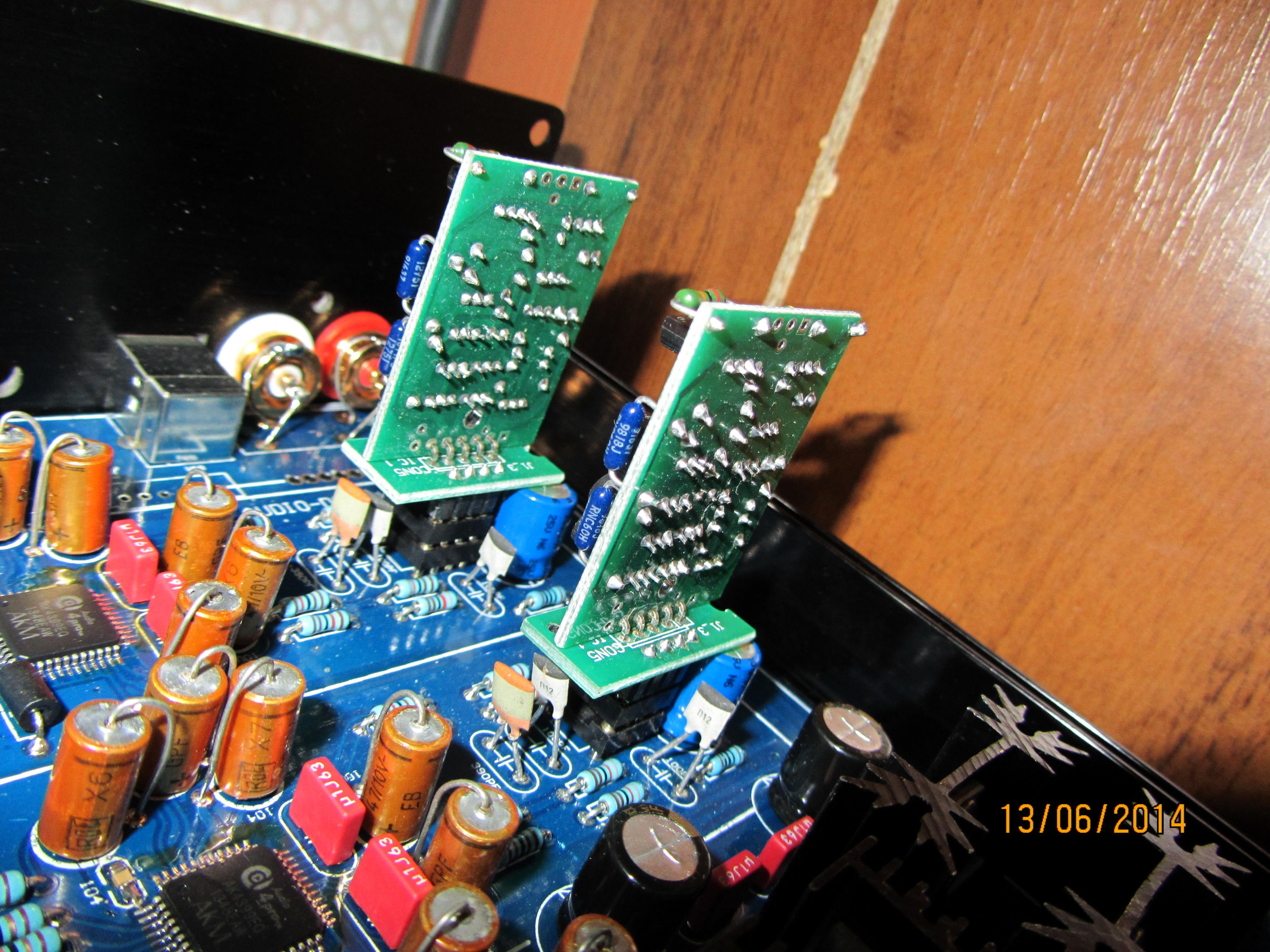

Established OP01 so far this is the best sound.
½ÜÃ÷OP01¶¥¼¶µ¥ÔË·ÅÄ£¿é£¬³¬OPA627½ð·â¡¢AD797¡¢NE5534-ÌÔ±¦Íø
Privet Lomonosoff
Spasibo for this info as well as for schematic diagram you shared some time ago.
I am very curious why output stage on discrete transistors give better sound than based on OA. Is it only because output of such amplifiers works in class A?
Privet Valeri100. I don't know why. But trust my ears. My brief review and photos in your signature.

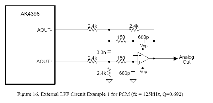

Output stage for all devices with AK4396/99 looks like this, values are maybe different, but schematic is same..
The biggest problem there is 680p feedback resistor, because it significantly slows opamp.. there is no logic that you can hear differences between two opamps, as long as circuit is like this.. same story about replacing of capacitors..
