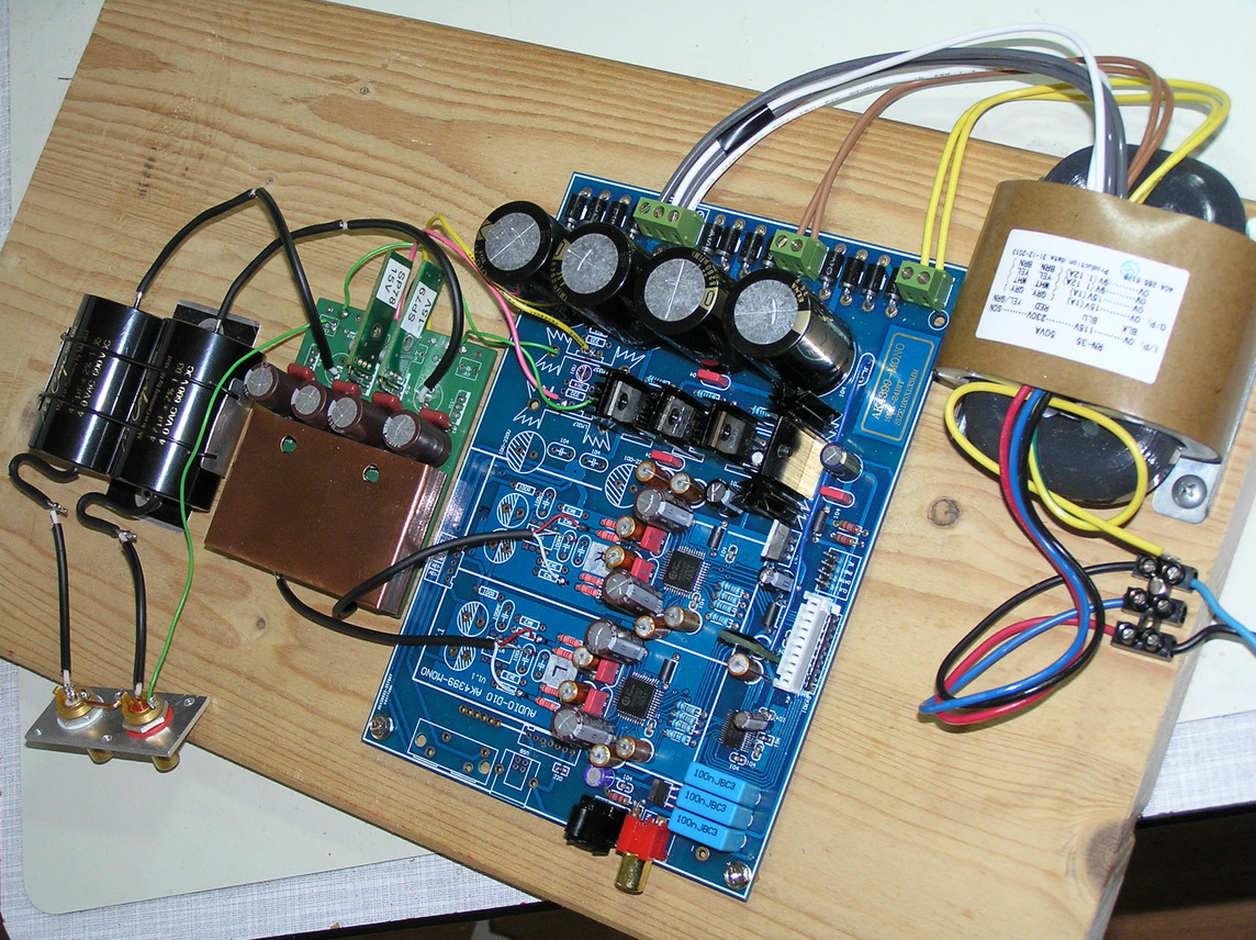

Yesterday I connected UTC A20 transformers directly to AK4399 outputs. The result exceeded expectation!!! Sound stage become deeper and wider. I also noticed bass improvement. I did not make A-B test but it is clear without it. I said that result exceeded expectation because I did the same two years ago with DAC based on CS4398 and did not noticed any improvement. I don't have an explanation about that.
Generally it makes sense to use transformers in output stage. I see only advantages:
1. No OPAs
2. No negative feedback in amplifier
3. It is very simple
4. Power supply can be simpler (no need for separate power supply for OPAs.) In my case one transformer less.
5. With a good transformer the DAC sounds very good
6. Galvanic isolation between DAC and pre-amplifier. It is valuable bonus for me because the DAC is directly connected to Nelson Pass F5 amplifier which doesn't have input capacitor. Thus I don't need to worry that in case if for any reason an OPA of the DAC will be broken and DC will go directly to my amplifier.
I will stay with this mod and will think what to do next.

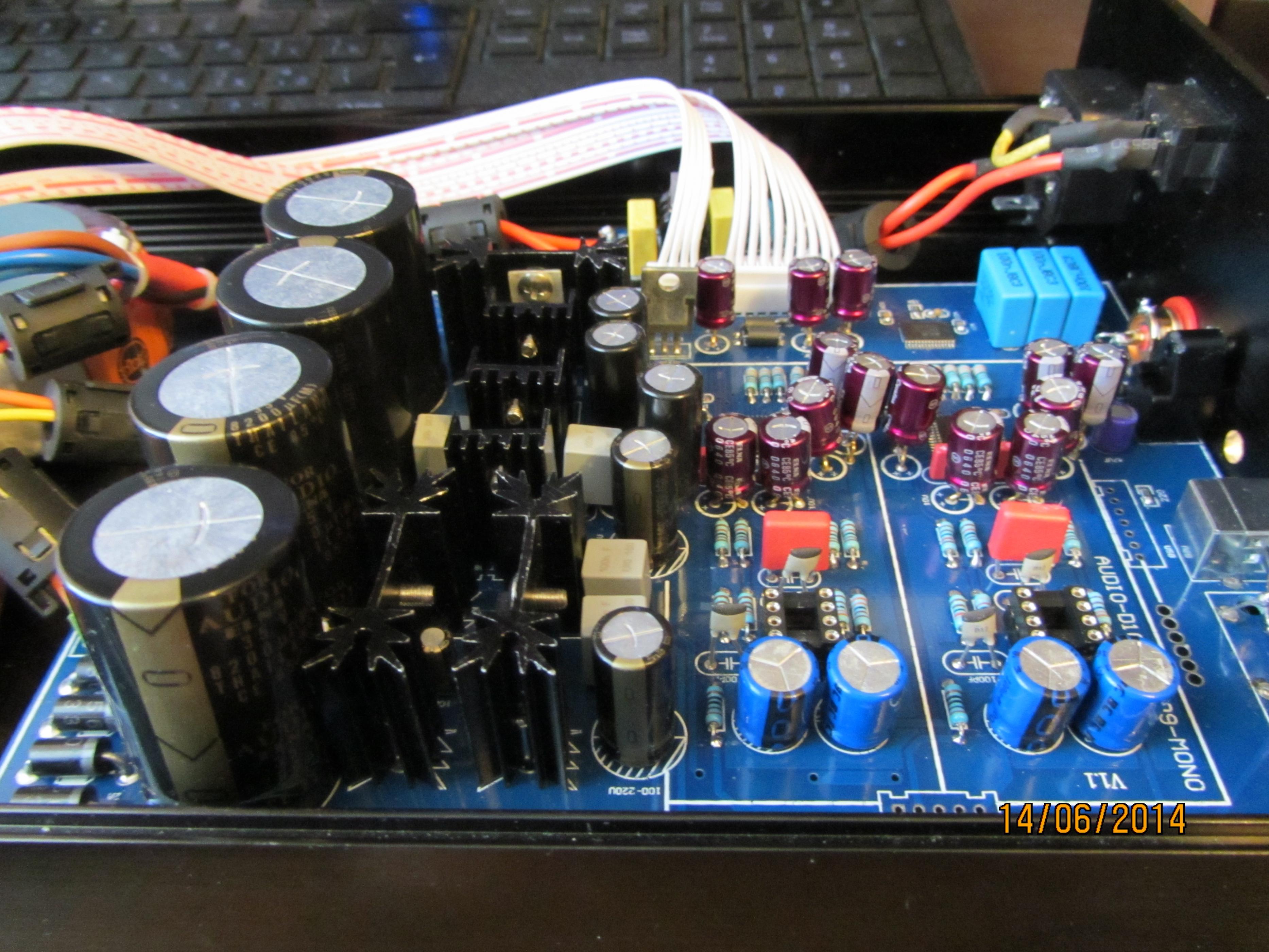

vulejov: I can tell you for sure you'll here the differences with changing opas on this board but it is not significant like night and day, minor change of characteristic...
here is schematic of our board AOUT, any suggestions? thank you
click image upload
Hi kukynas
Of course you can hear differences with changing opamps and/or decoupling caps.
If you want to stick with opamp output, here some suggestions::
The opamp used in the analog output stage has a combined function. It does some amplifying, filtering and adds the two differential signals from the dac to one output signal.
The filter used is called a 2nd order differential multiple feedback low pass filter. This type of filter is commonly used in cd-players output stages. The values of the resistors and capacitors determine the gain, the cut-off frequency and the filter characteristic. In general it's not easy to design these filters, but you can e.g. use Texas Instruments Filter Pro software.
If you want to change cut-off frequency (here set to 109.5 kHz) or characteristic of the filter (e.g. to Bessel), you must design your own filter; you'll end up with different values for C and R.
If you are content with your design, you can even improve sound, for example, with using matched resistors and capacitors, to improve the filter performance. Or you can replace the capacitors with polystyrene types or polypropylene. Also resistor material alters sound character (metal film or carbon film). As do different types of decoupling capacitors and super regulators in power supply...
You could also experiment with vulejovs' approach. The filter then becomes of 1st order, and has only 20dB roll off / decade. I don't know if this is enough to attenuate HF out of band noise, but you can try. If it works, then simpler is better.
Anyway, I'm glad to help if I can, let me know.

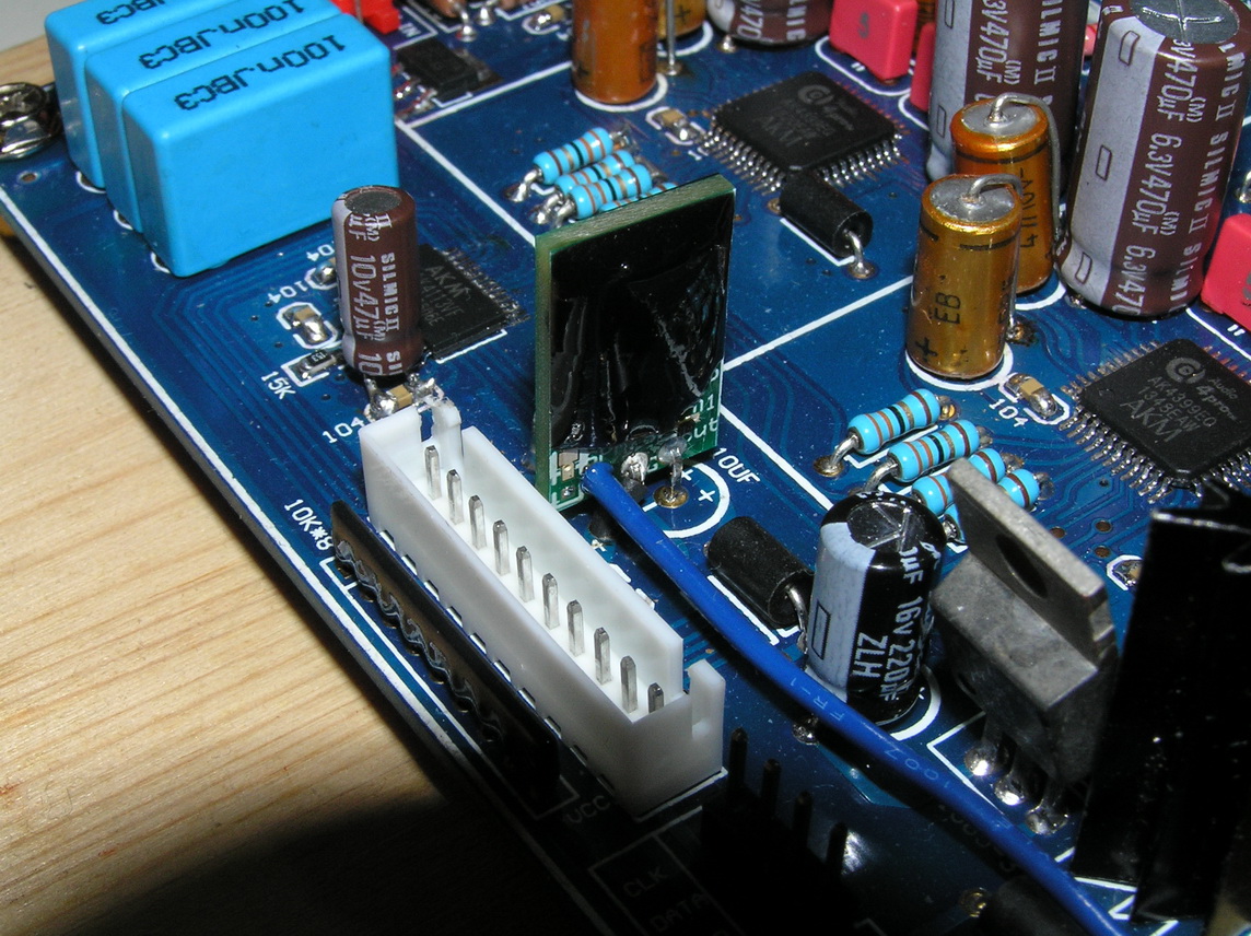

analog psu for AK4113
I'd like to inform you about my latest mod. I separated analog and digital power supply of the AK4113.
The analog supply pin is powering the PLL, which reconstructs the clock signal of the transport (I'm using Squeezebox Touch with Toolbox). A voltage controlled oscillator is used to generate the clock. To improve jitter reduction, the power supply needs to be as clean as possible, in order to keep the VCO stable.
Because digital and analog powersupply is the same, digital noise can enter analog supply pin, despite of the ferrite beads.
The mod is simple.
I bought a new super regulator of Belleson, the super power mini (partsconnexion). It's almost as small as a regular TO220 package, but can only handle 225mA max, and even less with higher Vin-Vout difference. But in this case it's perfect, analog supply draws only 5mA typical.
It's very low noise, only 4-5 micro Volts. It's a 3.3V regulator you need. Analog and Digital voltage may not differ to much, max 300mV. So I had to check the voltage of the digital regulator, but the difference was just fine, 20 mV.
I removed the 47uF ROE capacitor and the ferrite bead. The regulator then could take the place of the cap. The Vin of the regulator comes directly from the big filtering cap of the supply (with a wire). Close to the chip I soldered a decoupling cap on top of the little smd 100nF ceramic.
Sound quality improved a lot. More detail, sound is more fluid and transparent, voices are much better. I even thought of vinyl when listening, it's very nice.
I think, whatever output stage you have, this mod is an improvement. But performance is , to some extend, also dependent on quality of the incoming digital audio signal, I think. You can also try to use a common 3.3V regulator first, but a super regulator has better performance.
Regards, NinoSimona
