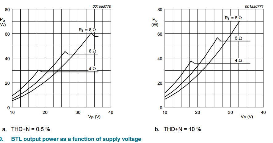

Ok, I've tested the tda8932 and was pretty disappointed, I'm reaching the thermal limit pretty fast(even with a tiny heatsink). 😡
So I will just buy the TDA7498 from sanwu and use only one channel.

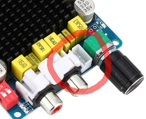

I have one last and pretty stupid Question:
How are these connectors called?😀
JST XH.... Japan Solderless Technologies.
Typically used with RC car/aeroplane batteries. Can get connectors with wire tails all over eBay. Must be an "XH" though. JST make a lot of different connectors.
Yeah, and some boards use similar looking but smaller connectors.
My Sanwu TPA3116 board uses an 3-pin XH 2.54mm pitch connector (I hope, that's what I ordered). From the diagrams they provide, their TPA7498 uses the same connector. A different TPA3116 board I have (ChengZhi) has a similar but smaller pitch connector. Fortunately it came with a cable.
