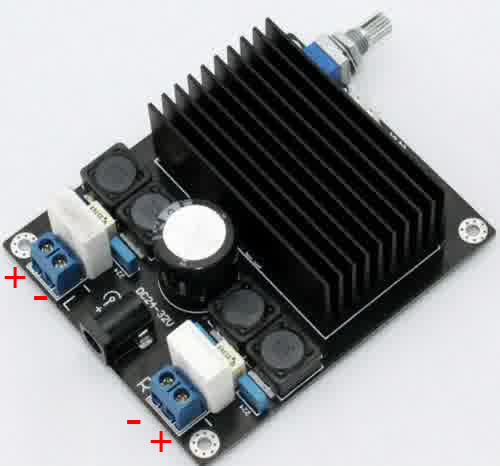

Some of these boards have reversed speaker output. Are you shure phase are ok?
I have tried reversing speaker polarity , still lack of bass.
You need to do that on only one channel.
Most likely it is the same as on my board, where the right channel has + and - interchanged.

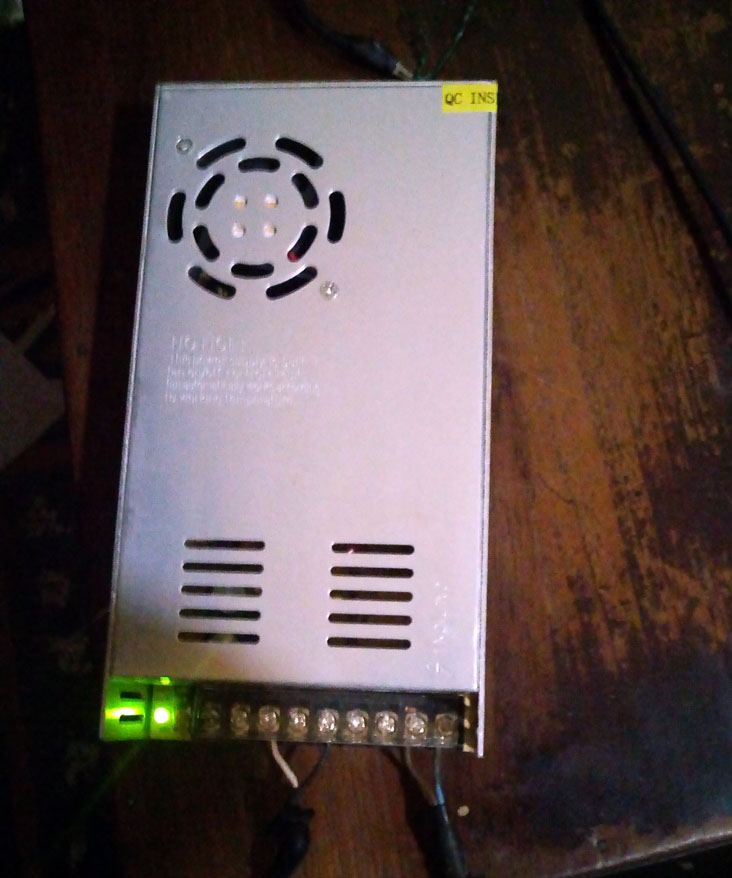

ok i will try . still Waiting 24v 15A psu.
thanks
24v 15A psu has arrived, connect speaker with polarity + - + - still weak bass, connect with polarity + - - + bass is ok.

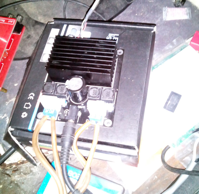

I had one cheap black 7498 to spare and wanted to give it to a friend.
I put it into a small box with connectors, nicer volume pot and everything.
My plan was to tell my friend to use a laptop brick as psu.
I tried a laptop brick i had at home, its values say 19V, 3.42A.
The amp went crazy and was playing music only every 1/4 sec and repeated like that ... on ... off ... all the time.
I measured 13V at the boards power connector with the psu connected.
Then i connected the next psu i had at hand - 12V 5.83A - the board didn't even start up.
To be sure that the amp isn't wrecked i connected 19V from sla batteries and the board worked as usual.
Is my 19V laptop brick wrecked?
Will my friend be able to run the amp with a 19V laptop brick or will all laptop bricks drop voltage that much?

If it's the cheap black board, it requires 18V to run normally.
I've also tried it with 12V - it won't start at all.
So, use proper 19V, and it should work OK.
The first "brick" you tried it with is obviously defective, if it produces only 13V...

Without a load i measure 19V.
It is possible to charge a notebook with it.
It was the first time i recognized the voltage drop to 13V.
Can you confirm that it works with a laptop brick?
Yes, mine run just fine on 19V/3.95A laptop brick....
