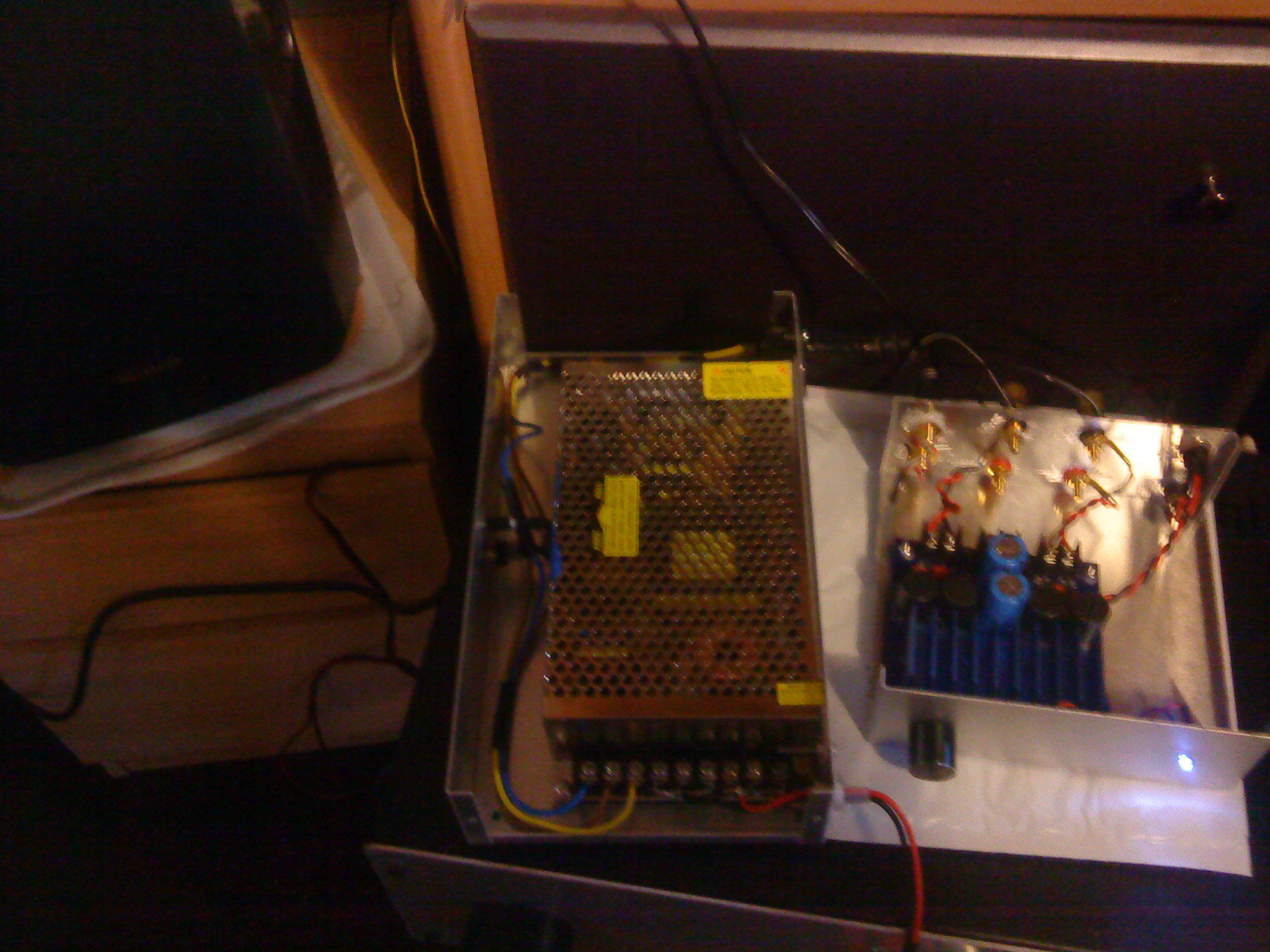

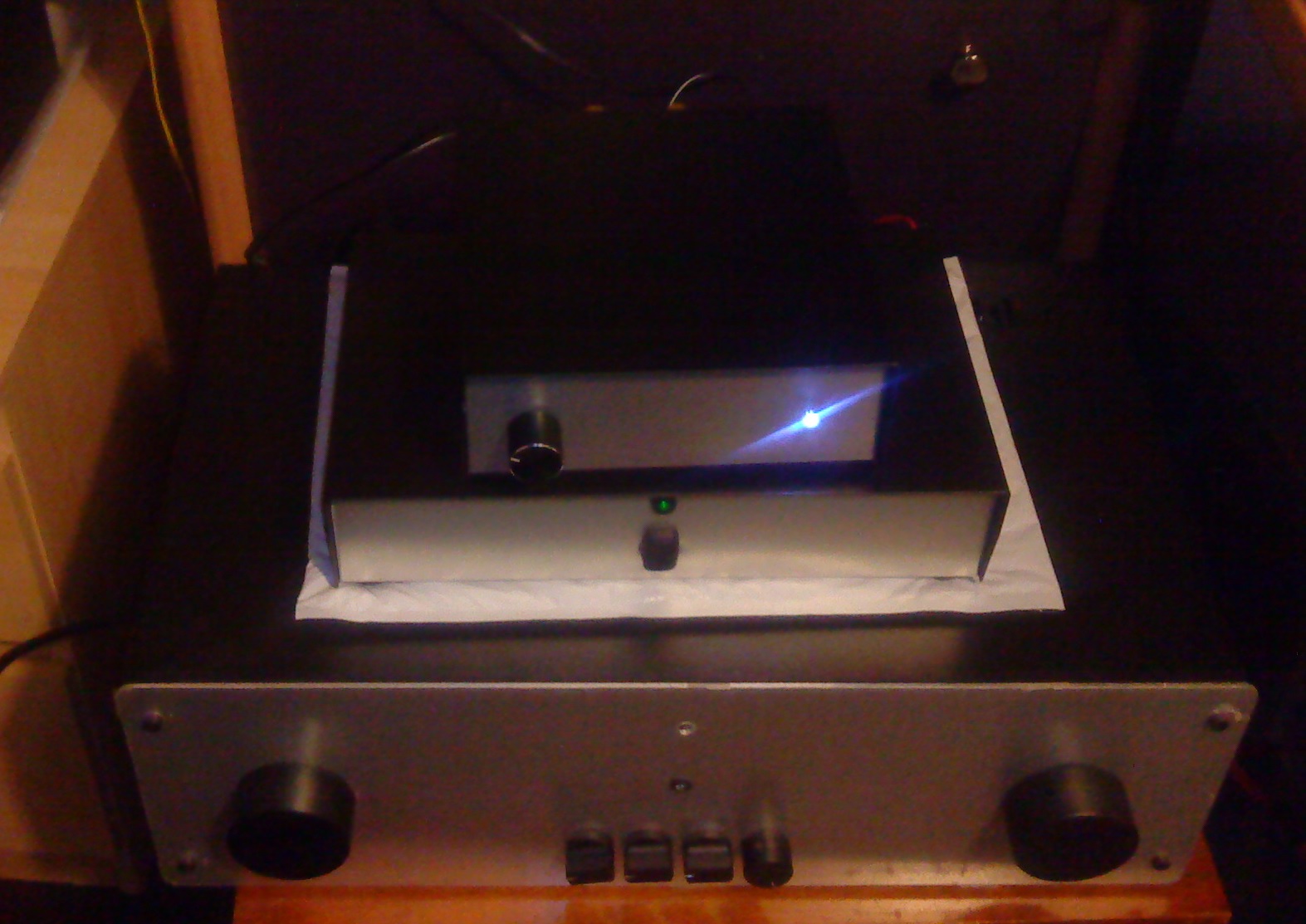

I just finished one of these cheap ebay TDA 7498 Amps.
I use a 36V 200W switching power supply to power it up, which I run at 31V.
I have tested it in two different set of speakers. What is noticeable is there is a lot of bass. Especially in a, 8 ohm Celeph speaker set.
In a pair of normal everyday Aiwa 6 ohm set it seems to promote a little bit more mid and high frequencies but still there are plenty and very good low’s.
It is dead silent with no input signal, even though its input gain is set a little bit high.
In it pros is that it comes with 63V filter caps, and through hole, not smd caps at the output filter. It also has a 12V voltage output on the board for a fan or whatever someone might think to hook up.
Drawbacks are that its audio input caps are smd type (as everything else) so it is not easily tweaked.
I am amazed from the detail and bass this small amp has. It performs extremely well for its price.
And there is no hum or other noises generated from the board or from the SMPS injected into the amp.

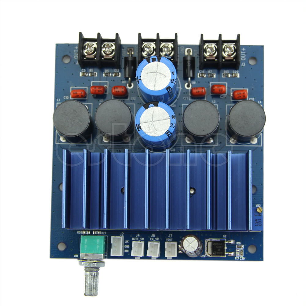

@drunktnk,
I have the same board and like it. Can you confirm that on board PSU is 12 V? According to the schematic in the data sheet, it is 3.3V.
@drunktnk,
If you look closely to the 2nd picture attached "J7" is marked Vout. That is trim-able by the trimmer next to the heatsink, on the right hand side, and currently I 've got it at 11.5V powering a led with a resistor in series.
Next to it (J7) there are (J4, J6) the mute and the standby output sockets, these (J4, J6) are at 3.3V, between pin and ground, as per schematic.
Interesting. I did not realise that. Look like this is something extra since I did not see any 12 V supply on the schematic (see attached). Thanks!
Yes, this is the schematic provided by manufacturer of the chip, as a guide for implementation. Usually all these cheap board amps from China use these schematics as board layouts (no R&D on their own). But sometimes they put something extra. Probably that is with this board.
There is also an application note from ST with more details about layout etc. if you like some more info.

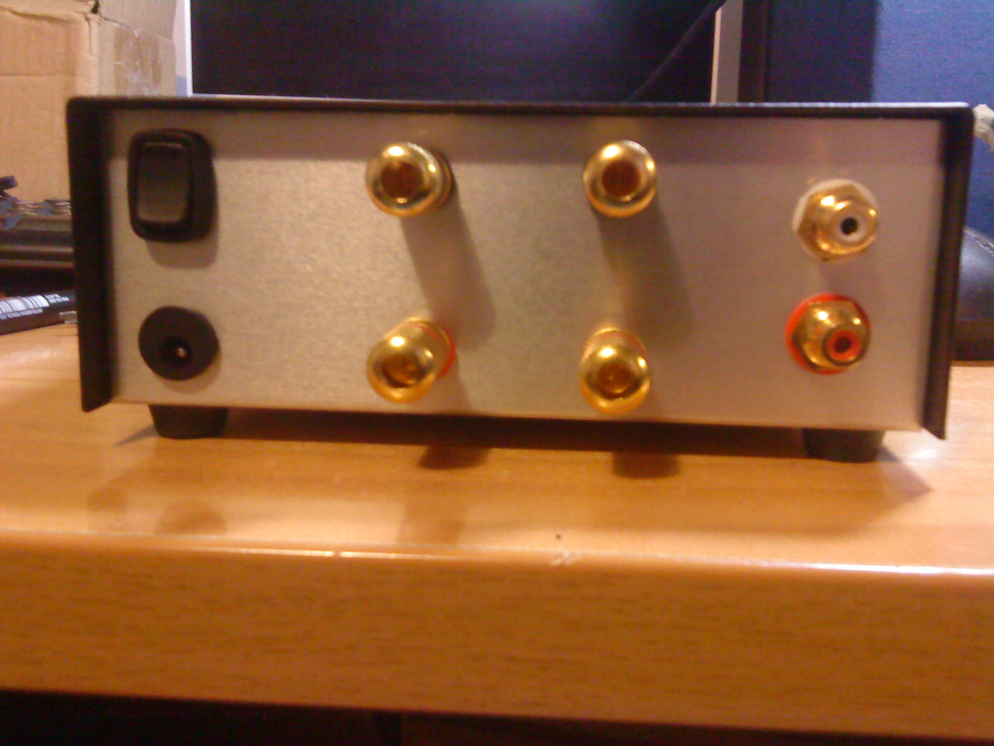

Good spot Doctormod. What is the current rating of those connectors?
Nothing gets soldered until I stop taking it in and out, I'm not sure when that'll be though - the curse of DIY is that you always think of something new to try and tinker with...

I agree, I should solder on a little green screw connector there. I have some too that I bought for the tiny 3118 PBTL boards... a future mod.
What really surprised me was how well it worked when I left such long leads on those 220nF caps, I seem to be useless at re-using through holes so I just solder through hole components straight on the top like SMD. Sometimes I need to dab on a little flux to help as tin is awful when the flux leaves, but that means those caps are around 10mm off the board!
