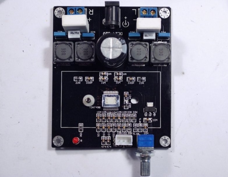

now I have received the module:
tested it with a thinkpad notebook power supply (16V): very clear sound, i'm missing the bass (on 4 Ohm subwoofer + satellites). It seems to be a 2.1 mm/5mm socket, so the 2.5/5mm mm plug of the ibm power supply is a bit loose.
AutoTech, 14-39V according to the st-data sheet, but 39V not recommended, there is also another thread on the power supplies here. No hum with my thinkpad power supply, so a good notebook power supply should be ok.
In the meantime I have testet this cheap tda7498 module with two 4 Ohm speaker systems: Sony ss-sw1 (passive subwoofer + 2 satellites) and wigo A11 http://www.radiomuseum.org/r/wigo2_a11.html?language_id=2 (good old German speakers from the 70's, which sounds ok with my TEAC Hifi). The basses are totally missing, probably due to the output filter.
Not suitable to 4 Ohm speakers!

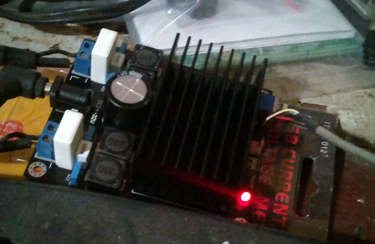

I have one of these on the way too (paid $12.67 during the 11.11 sale on Aliexpress) along with this PSU which I got for $18.65 including shipping. Will be fun to see what such cheap parts can do with my Q Acoustics 2050i speakers. 🙂
Btw. the impedance of the speakers is rated 6Ω nominal (4Ω minimum). Does that call for any mods?
I finally got around to test the above amp + psu and thought I would share my initial listening impressions. Compared to the credit card sized Sure TPA3110 and this TPA3116 (unmodded) I have at home also it definitely packs a bigger punch. It's a clear winner in terms of bass and volume. Highs are not as great as my TPA3110/3116's though (at least not without mods), to my ears they are a bit grainier and sharp in comparison. I also have some static noise when the volume knob goes past 1/3. The noise strangely peaks at around 3/4 volume and then decreases a bit when I turn the volume all the way up. I should mention that I have a static noise problem with my TPA3116 amp also and the TDA7498 is actually not worse. Overall I'm quite impressed with what I got for about 30 bucks and I would actually be happy to fire my speakers up with this at a party. For relaxed listening at lower volumes my battery powered TPA3110 is still my preferred cheap class D amp though.
last weekend we built two new cubo12 for our outdoor party machinery.
that board is a good and inexpensive amplifier for those.
we tried our setup with a smps and got similar noise.
when we hooked sla-batteries to the amp, all noise was gone and the punch was even better.
i'm still not 100% sure with the comparison between TDA749x and TPA311x.
i like both.
but i have to admit that i like the extra-spl that the 7498 provides for my woofers.

will output conductors likethese be better - it's a few bucks more than the cheapest TDA7498 boards.
Tda7498 digital amplifier board 80wx2 d amplifier board high power !-inAmplifier from Consumer Electronics on Aliexpress.com | Alibaba Group

It would be really nice to know if the larger inductors in the more expensive boards, are worths the extra 5-6$
i don't think they are better.
their magnetic fields might influence each other more than horizontal built ones.
(someone please correct me if i'm wrong)
There has been a discussion about inductor alignment in the tpa3116 thread.
downside if those inductors On chinese boards is that you have no idea if their value until you hold the board in your own hands.
those big inductors might have higher saturation currents, but that's worthless if the inductance Dosen't fit the filter.
a board with smd inductors is easier to mod imo as i have found good inductors only in smd packages.
i have one if those more expensive boards.
compared to the cheap black board it is NOT worth the money.

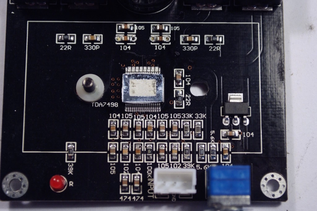

Anyone experiences loud turn-on pop with these?
I bought one (cheap, black version) of these TDA7498 boards.
However, connected to a laptop "brick" (20V), I hear a very loud turn-on pop when turning on the power...
Anyone have any ideas how one could implement a delay circuit on these?
I used a simple diode + capacitor + resistor delay circuit for my TPA3116, as found in the TPA3116 thread here, but I'm at a loss with this one.... I should probably scrape some varnish off to see the traces - but all components are SMD 🙁
I can provide a larger, more detailed photo, if needed...
TIA,
Denis
