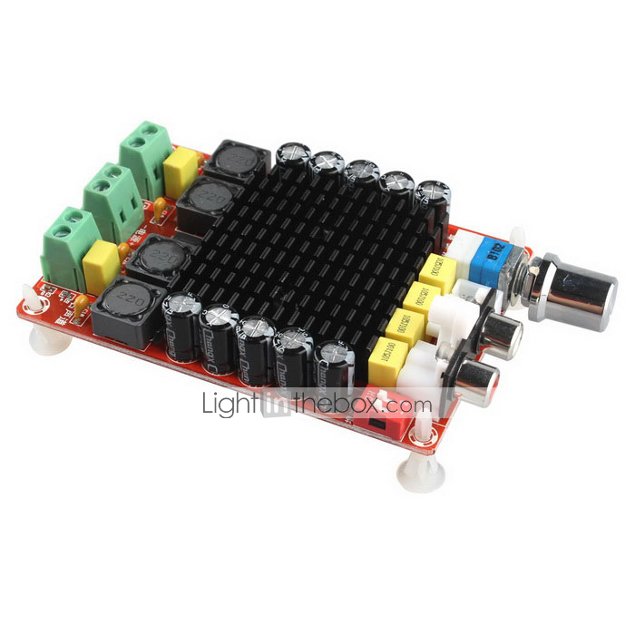

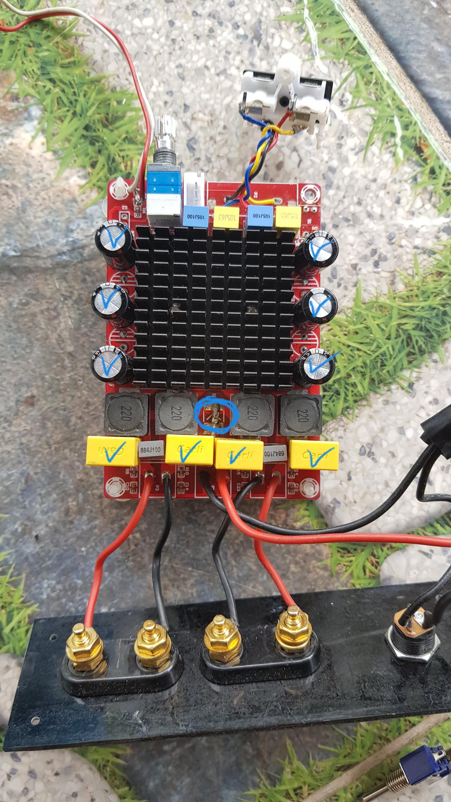

My TDA7498 (code XH-M510 as attached pictures) board keeps entering protection mode after about 20 to 40 minutes running, and I don't know why 😕
I did some mods:
- Short the power anti-reverse diode
- Change output filter capacitors to a different type but the same value (220nF)
- Change decoupling capacitors from 220uF/63V to 470uF/63V
I don't think it's a thermal issue, because with the heatsink removed the board keeps running as long as with heatsink installed 😕
Can somebody help me find the problem please? 🙂

@chermann: Thank you! I've read the datasheet many times, and I'm still trying to figure it out. 🙂
I've tested my TDA7498 board with a 19VDC/3.45A laptop brick adapter and a 24VDC/5A transformer, so I don't think it's about the power issue.
I saw that all protections seem to cause the same symptom "outputs to the high-impedance state", except with Over Thermal "the device goes to mute mode and the positive and negative PWM outputs are forced to 50% duty cycle". When my board gets protection kick in it suddenly muted and after some minutes it goes back active. I will try to replace another heatsink to confirm if it has thermal issue or not.

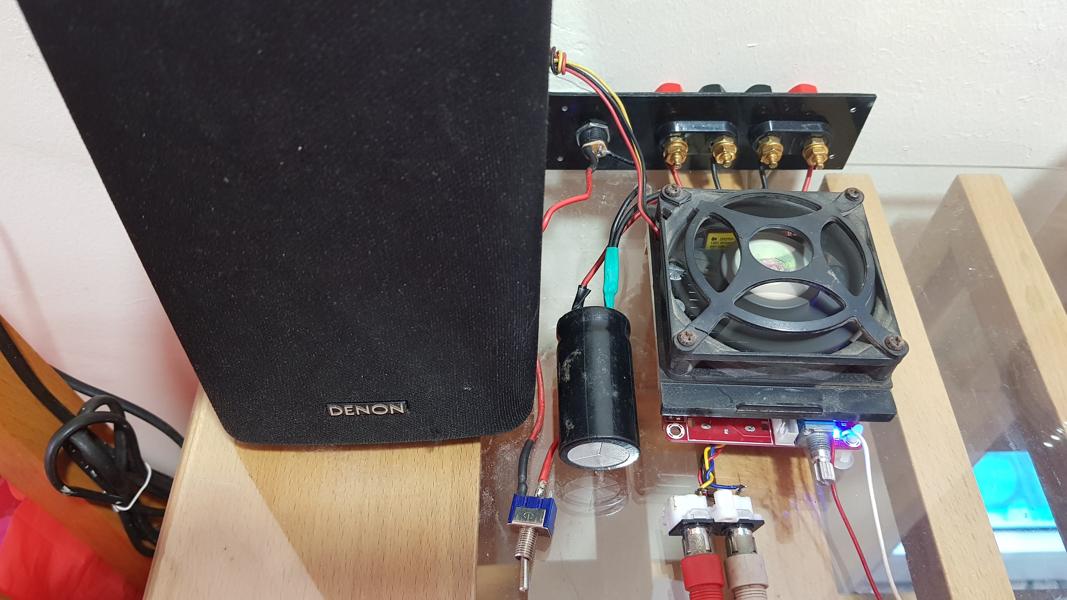

...... I will try to replace another heatsink to confirm if it has thermal issue or not.
Very good advises you got from Chris.
When you want to check thermal issues like a sufficiently big and efficient heatsink, changing it for a start into a bigger heatsink is the difficult way. I use an ordinary table fan for such testing. Put near to the existing heatsink it is like using a MUCH BIGGER heatsink. Don't care for a start about the hiss from the fan. If the amplifier with the initial heatsink and a fan works, start thinking about how you realistically get a better cooling system in place. If your chip still shuts down, you were looking in the wrong direction and need not spend time on a more difficult replacement of the heatsink.
@FauxFrench and Chermann: Thank you again! The "fan solution" worked! 🙂 With a CPU cooler fan on the top of the heatsink, my TDA7498 board operates at max volume for a 2 hours period continuously without halting. Again, it's a "matter of price" as you said, the Chinese cheap boards come with cheap and insufficient quality components so they didn't work as they should.

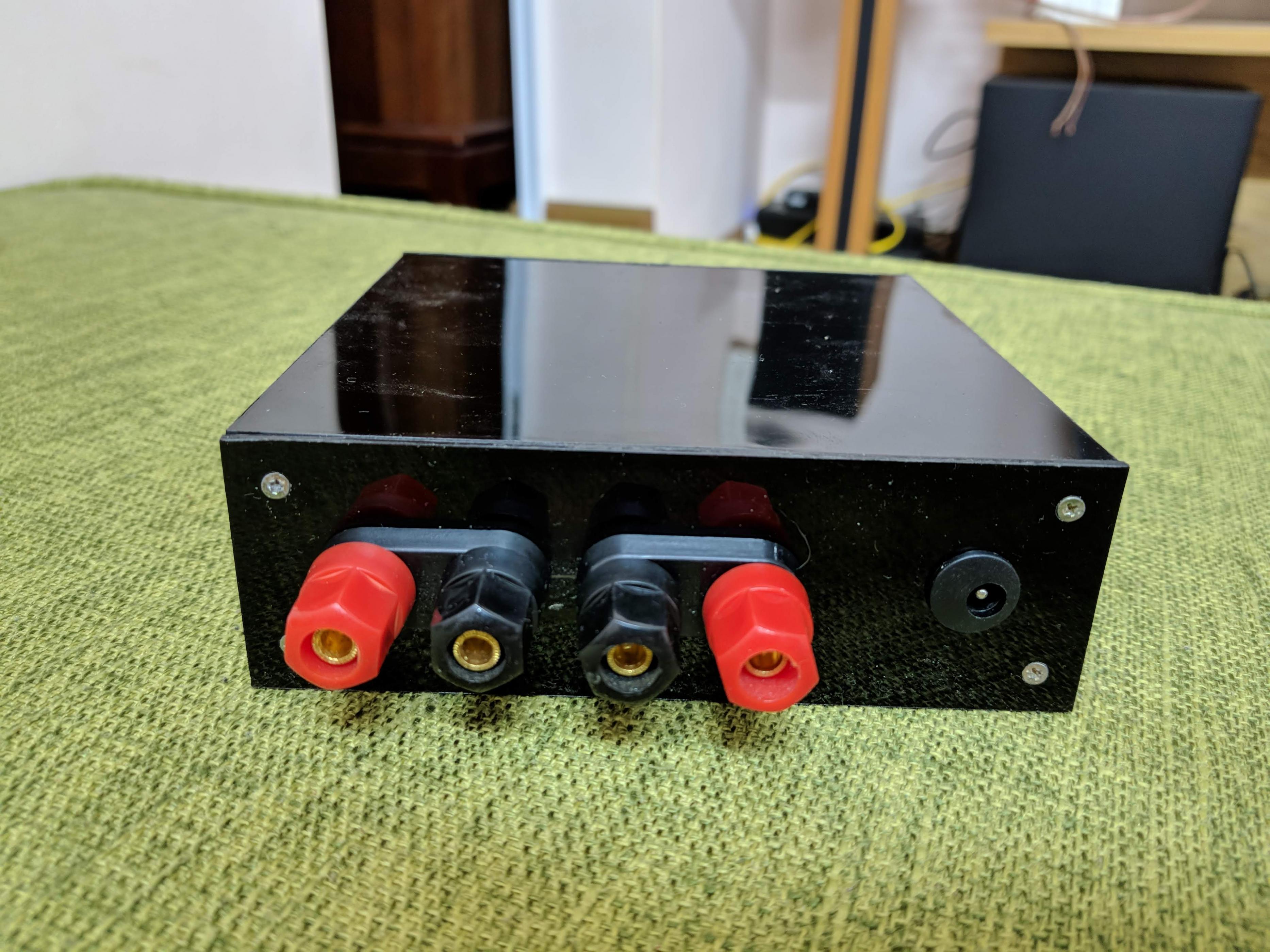

I want to build a simple, compact and cheap stereo system with this TDA7498 and 2 Denon SC-F1312 (6 Ohm-60W) speakers, so I made a chassis for it (as pictures). But this chassis seems too tight for this board, at least it's doesn't have enough space in case of upgrading the heatsink. I think TDA7498 is more thermally sensitive than TPA3116D2 I've used before because I'd put TPA3116D2 to an even smaller chassis 😛

Thanks! These pictures are taken when I just finish the chassis, now it has some drill hole on the top and bottom already 🙂

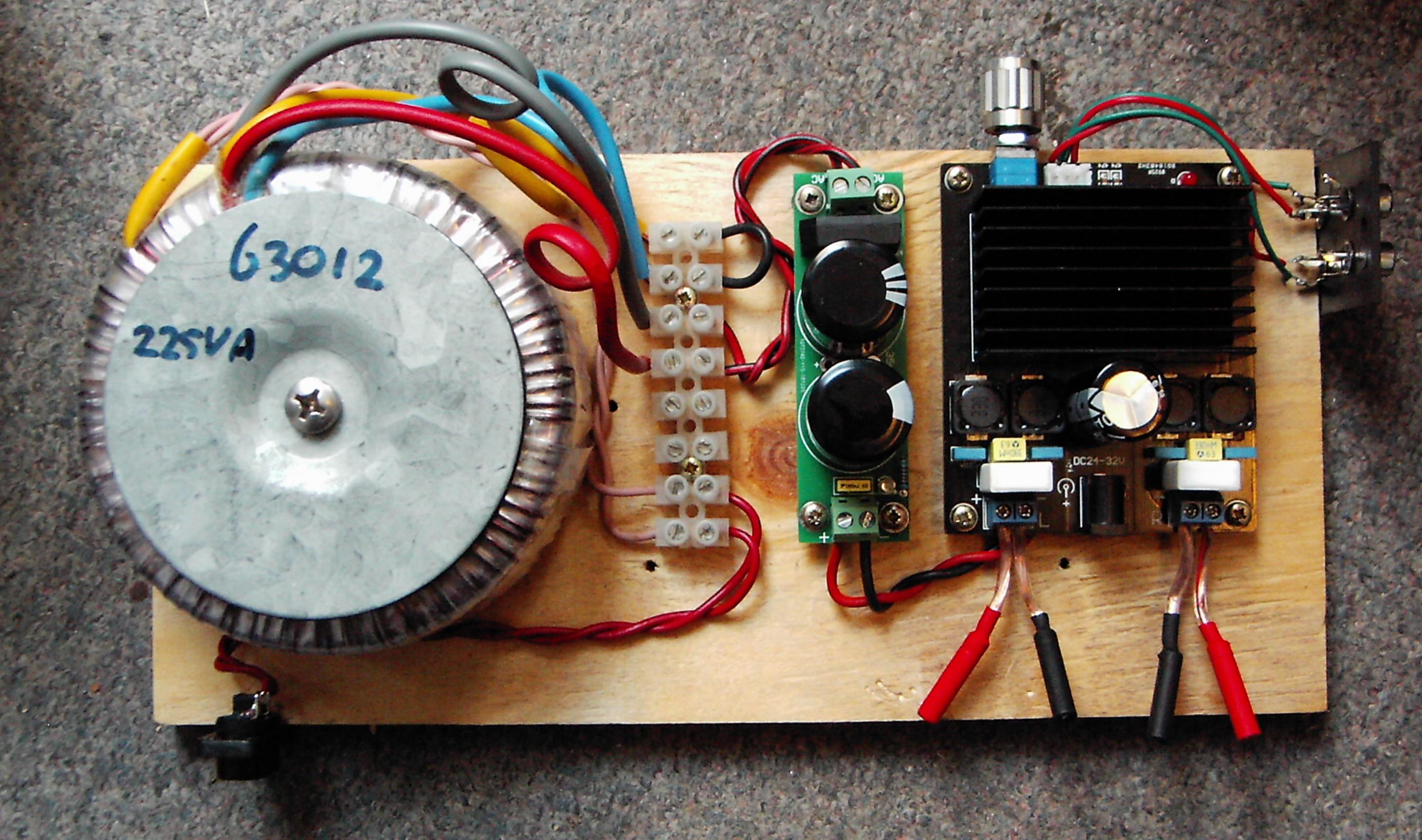

Not to polute my own topic; I also have one of these:
Replacement TDA7498 2*100W Digital Power Amplifier Board Class D Dual Audio Ster | eBay
Powering up this board is next on my list, but I'll use a switching powersupply (24V 5A), due to the 35V capacitors on it...
Regards, Jan.

To avoid confusion (I know I shouldn't have mentioned the 'other' amp board), I added a picture of my current test set-up.
The transformer is a 2 x 12V AC, secundairy windings connected in series for 24VAC and rectified to get 32V DC. (It's actually closer to 35V without load.)
DC to the amp board is soldered onto the back, directly onto the connectors of the barrel connector. With this Voltage I don't trust the tiny contact surface of the plug I'm supposed to use for it.
Same goes for the RCA inputs, as I don't have the proper connectors at hand, short of robbing a servo of it's leads.
Regarding the gain settings; when I search for TDA7698, I get several datasheets with different additions, the one I'm looking at is the TDA7498L (80 watt + 80 watt dual BTL class-D audio amplifier) on the ST site.
I'm not used to working with SMD equipment, (way too small at 66 years, magnifying glass only helps so much) but I'll manage if I have to.
This requires taking the heatsink off to gain access I imagine, any specifics I should keep in mind when doing that?
