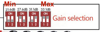

Hi Jan,
It should be 25.6db (according to the datasheet) and that is the lowest gain.
I have done similar when I changed capacitors on a board. No problem, the board just gets a bit higher.
Now I'm confused...It should be 25.6db (according to the datasheet) and that is the lowest gain.
At which setting is the amp at it's loudest? The most left setting, or the most right one?
So the 21,6dB is a typo and should read 25,6?
That actually makes more sense, as the steps between the settings are more equal, in stead of the 6 dB, 4,5dB and 2 dB the numbers in the link suggest.

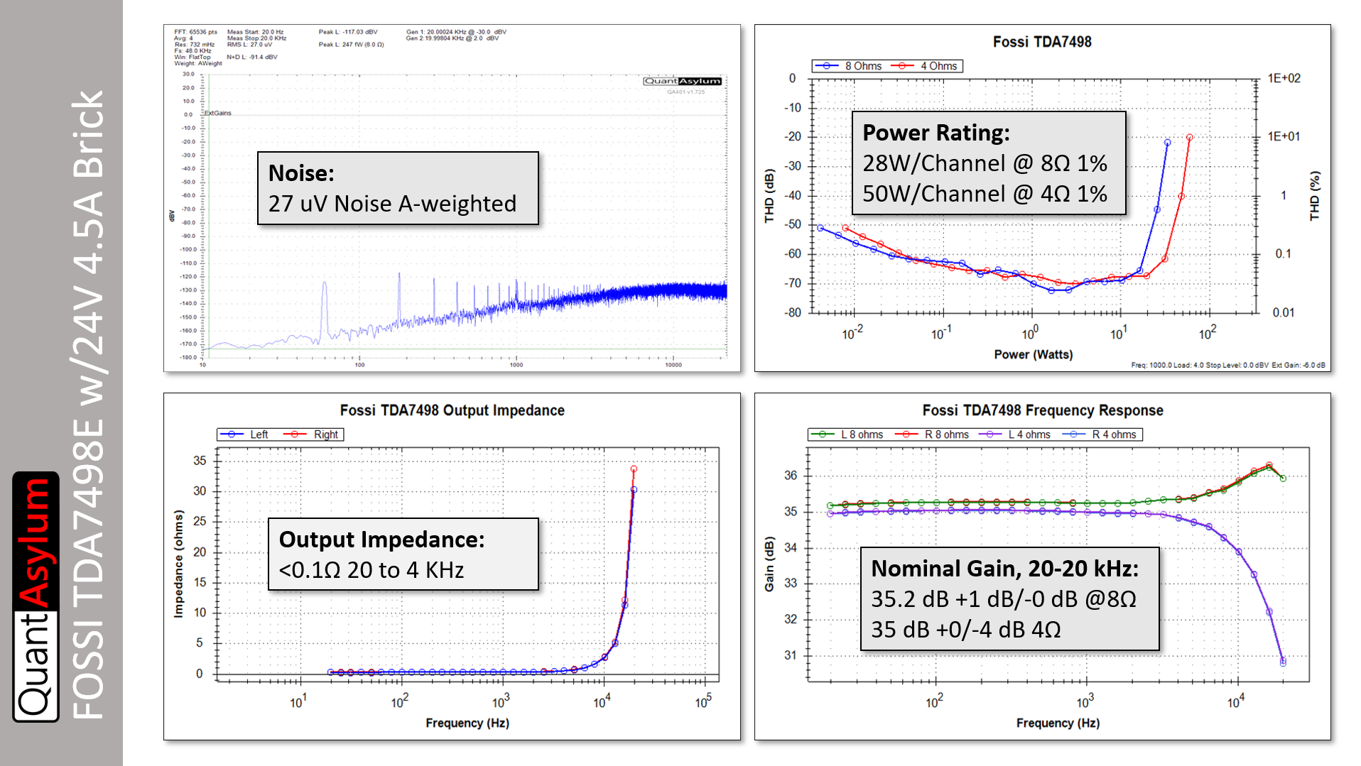

The noise output from these TDA7498 amps is really low--about -91 dBV A weighted on the highest gain. So, even if you are using really efficient speakers, you shouldn't hear anything from the speakers even with gain set to max and inputs shorted. 50W into 4 ohms means 23 dBV into the speakers, and so if your DAC can do 0 dBV max output, then the lowest gain setting would require full volume to get to 1% distortion.
Not sure about that ebay design in particular, but in the attached plot, look at the output rolloff from 10 to 20K into 4 ohms. The manufacturers have to pick if they are going to drive 4 or 8 ohms. But as you can see, the way to serve both is to compromise so that the 8 ohm load results in peaking and the 4 ohm load results in premature rolloff.
Min - most left, Max - most right.
Sorry Jan, the gain values on the board are some 4db lower than in the datasheet. Could be due to some loss (4dB) from the implementation.

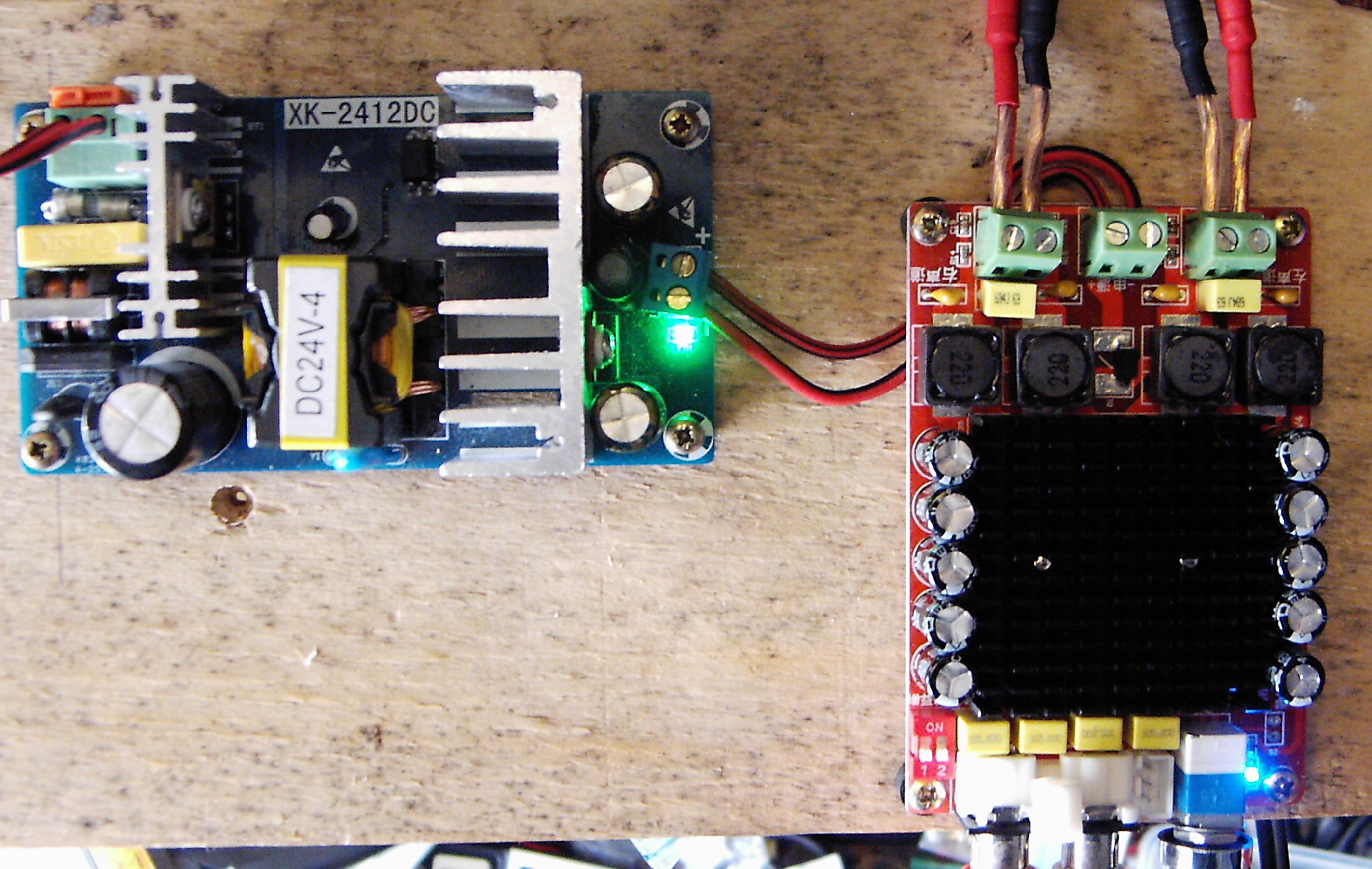

As I was still confused as to which was which, I hooked up the board with the 24V DC SMSP onto my PC soundcard and played around with the gain settings.
At the lowest setting 21,6dB (according to the link) the amp is the loudest, at the maximum setting: 33,3dB, the amp is less loud; I can turn up the volume all the way without getting distortion from the speakers (4 Ohm).
So: the lowest setting results in the highest gain and the highest setting is the lowest gain.
Glad I figured that out...
I wonder if I should replace the 35V caps for the 50V ones and go to 35V powersupply, as the amp is loud enough for the nearfield application I'm currently listening to.
Will the bigger powersupply make any difference in sound quality, or will I just have more reserve in terms of volume?
I added a picture of the set-up I'm listening to at the moment, the input has a Y-cable feeding the fullrange signal into a subwoofer filter, followed by a 200W IRS2092 on 50V, powering a bandpass sub under my desk.
Regards, Jan.

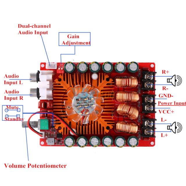

hi JAN
normaly the Gain is the Gain.
low gain = low voltage "swing" possible
high gain = higher voltage "swing" -- louder
i guess that the picture (zek) where you can see the red switches up/down is maybe not correct....maybe the "white" position is counting the gain...
but now you know which setting you need/prefer
chris

Hi
At your picture is see how you connect the speakers !!!
please make the cabel insulation once again- the blank copper is not good-it looks as a stiff cable but avoid the reason of a short cut !
chris
