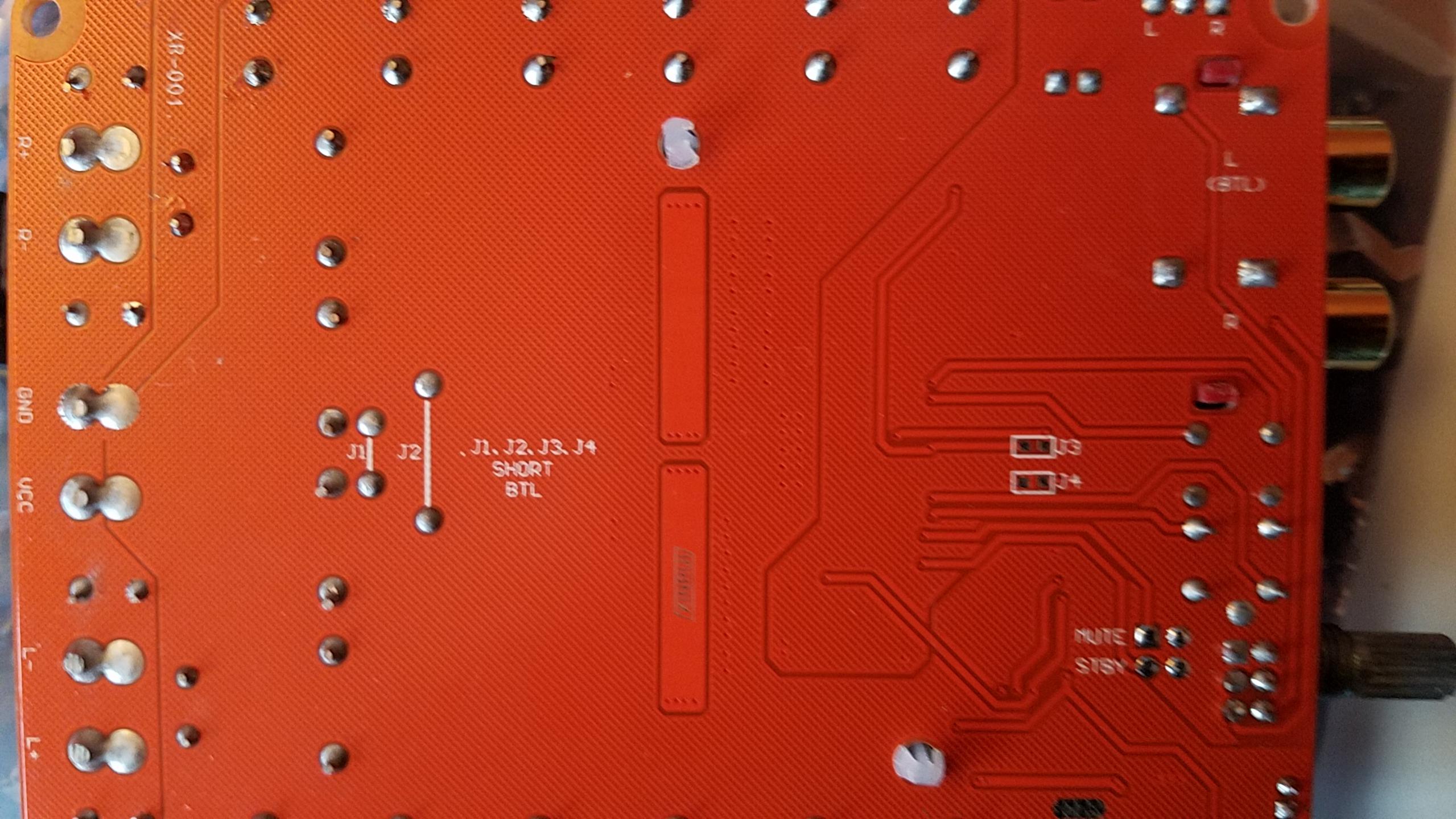

What is the final word on running these boards PBTL? I have a 4 ohm sub I'd like to drive with a spare board I have.
I know there was talk about it in this thread, some of which certainly went over my head. My understanding is that there is no consensus about whether chokes need to be removed, and also, it doesn't seem to matter which RCA connector to use for signal in, or which connector to use for speaker out.
Benefit of running PBTL is for the amp to be able to run 4 ohm loads, rather than doubling of power available..
Am I correct about all this?
Almost.
Consensus was for the past, now we live in societies with competition and conflict!
Sorry, I got carried away by the latest propaganda.
You should remove unused chokes because a choke with a signal may start resonating and build up a rather high voltage if not damped (by a load) and may damage components. I have a consensus with myself on this.
For that board, it does not matter which RCA input connector and corresponding output connector you use as long as you use only one. Once more consensus with myself.
PBTL leaves the same output voltage level, thus the same output power for the same load impedance. Advantage: the impedance of the output switches becomes half and the current limiter level is normally raised such that you can use a lower load impedance. Hat-trick on consensus with myself - I am brilliant!
There is nothing wrong with healthy discussion, or even flat out disagreement. Now If you had not reached consensus with yourself, that would have been troubling!
Well, I just had a look under the heatsink, and I don't believe I'm equipped to remove anything from there. it is too tight. my old eyes can barely see it...
Interestingly, my left input says BTL.
Your eyes are better than my memory - in PBTL mode it seems you can only use the left channel input. I checked the datasheet. I still believe you can use left or right output but not to complicate matters, use the left channel output as well.
I have to be careful not always agreeing with myself.
And the benefit it that you can run 3Ohm loads within spec instead of 4Ohm in BTL.
But Biggywizz (?) tested it on youtube and got 2x150W @2.67Ohm in burstmode, so it is pretty safe to use it at 2Ohm in PBTL and get 200+W out of it.
When asked to play sinewaves at full power into resitors, the chip seems to have heating/burning issues, but should be fine with music into speakers.
It is still unclear to me as the blue Feixiang board does it differently and the 7498E datasheet says:
"5.1") Stereo and mono BTL operation selection using the MODE pin:
The TDA7498E can be used in stereo applications or mono BTL applications. Connecting the MODE pin to the VDDS pin configures the device in mono BTL. The output of the two channels can be paralleled.
When the MODE pin is connected to ground or floating (pulled down internally) the device works as a stereo amplifier."
Which implies that there is no PBTL mode, just mono (1 input) BTL with 2 outputs, which can be paralleled at the outputs/ speaker connectors.

Figure 3 of the datasheet shows connection directly at the output of the TDA7498E chip. Seen in this context and on chip level, the statement "the output of the two channels can be paralleled" is valid in the sense that they are the two channels inside the chip. This configuration is what we call PBTL as the switches of two channels work directly in parallel before the filter.
If the switches are logically coupled to switch alike but actually not connected directly before the filter, the average voltage at the two outputs are at any moment alike and it should be possible to connect the two channels at the output of the filters. In such case, the inductances act in parallel with half the individual inductance and the capacitance with the sum of the two capacitances. Thus, the filter becomes more "heavy" to pull with higher circulating current. Such a more heavy output filter is typically used when the speaker impedance is lowered (2 Ohm). But, if the load is maintained at what one stereo channel can pull, I would use only one filter and traditional PBTL. Then, the chip losses are less from the PBTL coupling.
