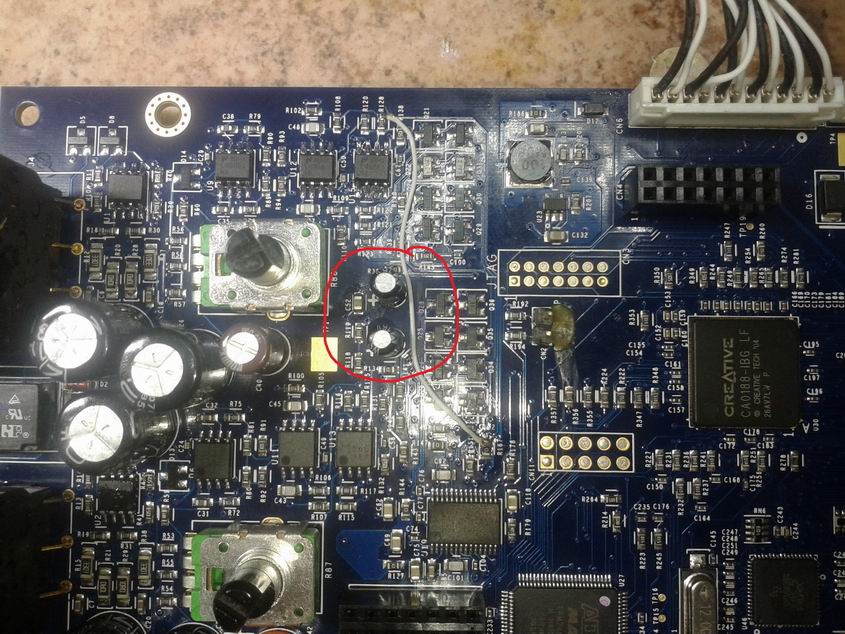

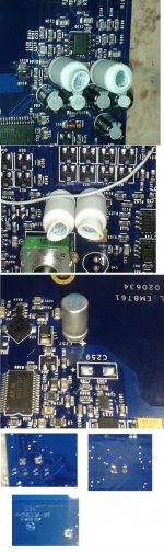

See pre-adc power caps on attached pic 'Resize of Photo-0078x.jpg'. They're for all input opamps power. One positive supply another one - negative. And zero-ohm resistors that connects this opamps group + this caps to 'global' power wires are near to that caps. In post 140 I didn't replace them with polymer caps, only added polymer ceramic. But I replaced them with polymer caps too in post 144. Photos with all power caps replaced is another attached pic: 'caps_replacement.jpg'. Note that there'is still empty placeholder named C259 - after taking that photo I soldered there another polymer cap as DC converter datasheet requires, but this didn't change anything significally.
About builtin headphone amp - I didn't care about it cuz I'm using external one.

"only added polymer ceramic" => "only added ceramic".
However one more thing about builtin headphone preamp. Those two 220uF caps that powers its output opamp are not bad. I measured their ESR - quite good caps, no strict need to replace them, unlike other caps that I replaced.

I used that capacity value because thats only polymer caps with suitable voltage that were on my shelf 🙂 I was a bit afraid that too big capacity can cause PWM instability - but everything works fine - I didn't notice any instability manifestations since made that mod.
And why I'm using polymer caps - because of their good characteristics to on high frequencies. EMU on-board PWMs work at 160KHz, but 160KHz - is a frequency of very short pulses, so actual spectrum of that pulses IMHO reaches to tens of MHz, so really good caps required to filter them and SMD inductors also useful on such frequencies, and also there'is so suitable place for them - dummy 0Rs🙂.
And that PWM's pulses observable almost everywhere on board - on opamps power pins, on outputs, and due to tricky board ground pathes - even between grounds of outputs and inputs. DAC/ADC powered from linear regulator and oscillograms of their power lines looks rather smooth and also on DAC's output only white noise observable, without visible pulses.
