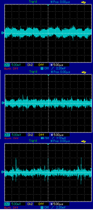

Also I use custom linear main PSU instead of factory one. While I didn't get rid of that on-board DC converters linear mains PSU still makes sense, at least when did all that things. I attached 3 oscillograms, taken from main output of my modded EMU. First - taken with EMU being powered off, but everything else around on - so there'is some noise coming 'via air' and may be via USB, but most probably its 'ground loop' interference. Second picure - board being powered ON from linear PSU. Same small spikes definately become bit bigger, but not critical. And 3rd pic - is when EMU powered with factory PSU. Small spikes much bigger + added new even bigger spikes reaching 15mV peak-to-peak that didn't present on first two oscillograms. Obviously - they generated by PSU, and they 'visible' much more than own on-board converters. I think again its againg coming to oscilloscope via ground loop, but not through board power modulation - there're lot of filtering stuff.. But anyway it doesnt matter much - this ripple noise can come to amplifier's input by same way.

Removing TVSes (D5, D8< D26..D31) noticable reduces THD on high frequencies when EMU used with hi-Z load, but almost doesnt change when working on low-Z (for example on EMU's own XLR inputs). However it also makes device much more vulnerable to static electricity, so I do not recommend do this if you want to use your EMU in hard studio environment, with all that long cables and people, running around.
Your inductors should be OK. Any will be ok while they can conduct enough current, and IMHO 200mA is enough. However 0805 inductors bit larger than 0-ohm 'resistors', but its still possible to solder them.
