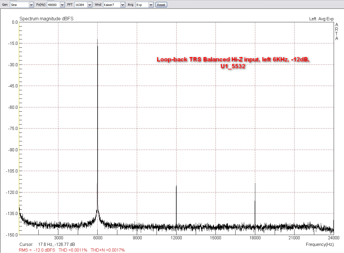

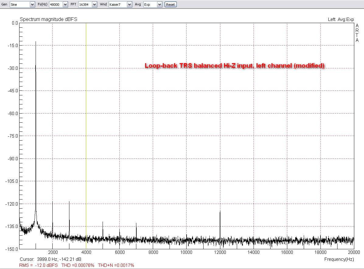

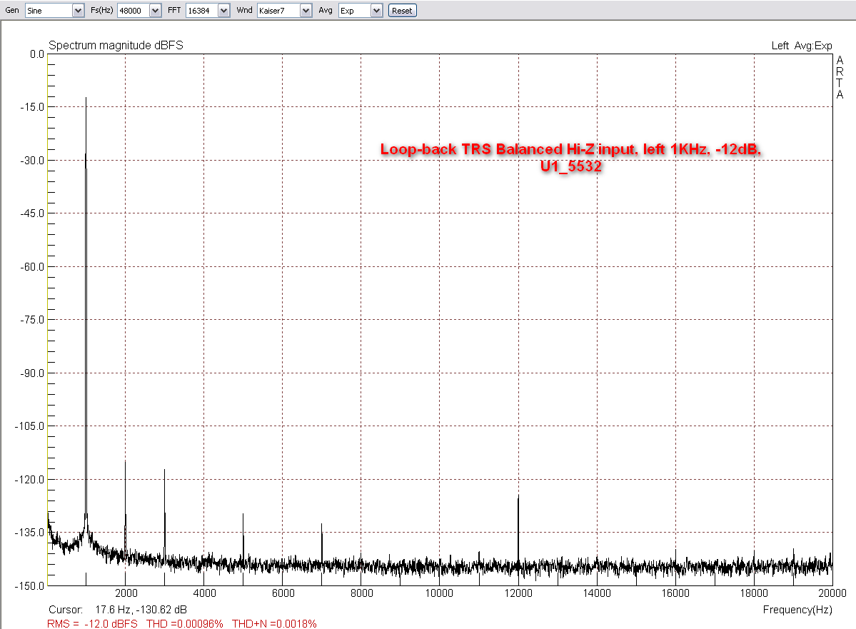

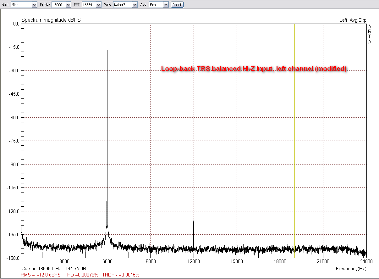

Today, I changed the U1 with the original 5532 opamp.
I done some THD arta measurements at -3dBFS and -12dBFS.
From what I saw, there is no any difference btw U1=5532 vs U1=49720 at -3dBFS, 1KHz/6KHz. All the measurements (thd, thd+N) are exactly the same.
There are some differences at -12dBFS that the LME49720, seems to have a significant lower 2nd harmonics.
The next will be the same test with OPA1612 at the U1 position and I think to play with the values of R89/R90.

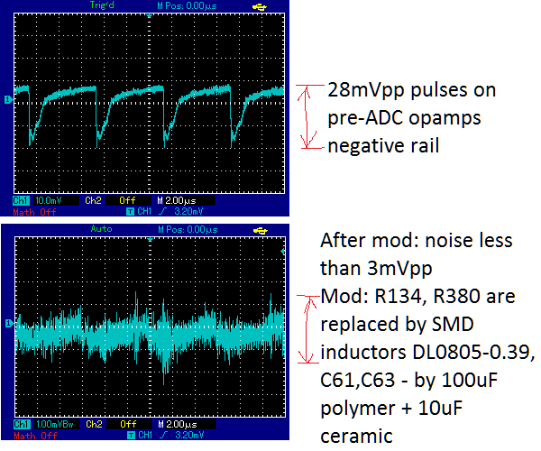

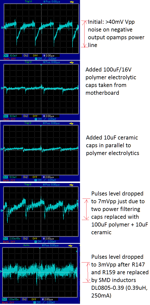

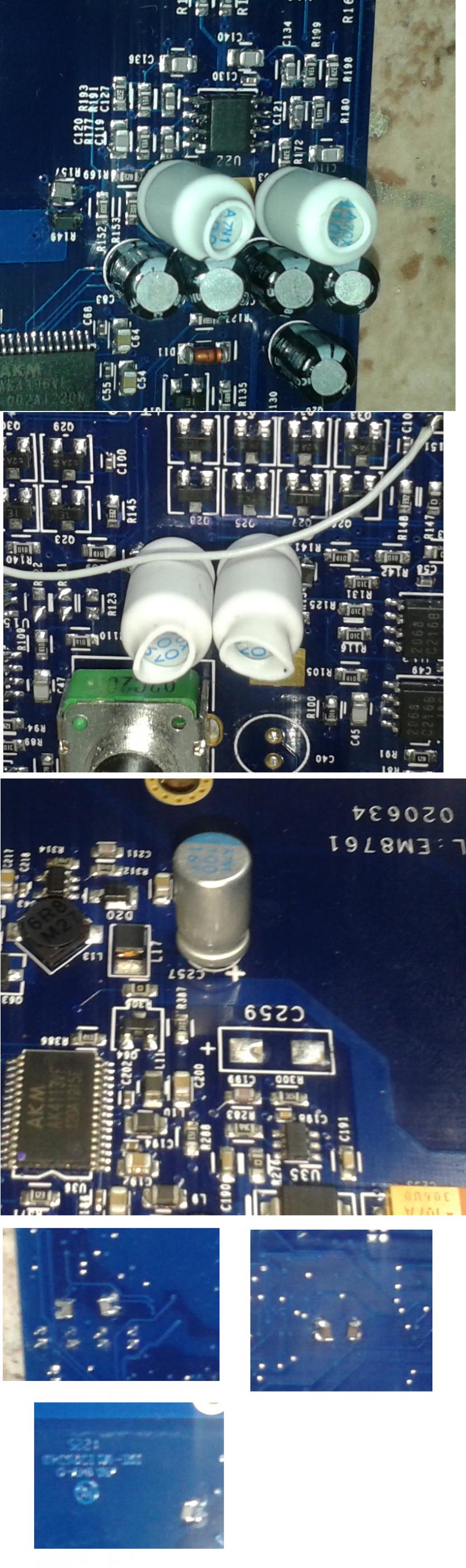

Today I got tape of 30 SMD inductors and continued playing with power 🙂 Inductors are FERROCORE DL0805-0.39 - SMD size 0805, 0.39uH inductance, 0.55 Ohm resistance and 250mA current capable. I replaced zero-ohm resistors R147, R159, R134, R380 with them. That resistors connects input and output parts with general power rails. Also like yesterday I replaced power filtering caps of post-DAC stage with polymer + ceramic, today I did same with pre-ADC power caps. Also I replaced C257 with single 100uF/16V + 10uF ceramic. I'm not sure which component power filtered with C257, I suspect that its DAC/ADC. Before this change there were saw-like 4mVpp pulses, after - no pulses on C257 at all, at least they're lower than noise. About results on other parts - see pics (post DAC pic is derived from yesterday's). And.. RMAA/ARTA still showing same numbers, and sound still very good on my taste 😉

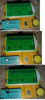

Now a bit of theory. To effectively filter such high-frequency pulses power-filtering capacitors should have lowest-possible ESR on that frequencies. And polymer capacitors are very good at frequencies until few MHz's, they even better in that than usual low-ESR electrolytics. The only caps that have smaller ESR are film and ceramic. Thats why I used polymer + ceramic. I also attached pics of ESR measurements of polymer caps compared to original caps I pulled from board, I don't know exact frequency at which ESR is measured, guess its 1KHz, but anyway difference is obvious.
About inductors: with 0.39uH inductance they have 0.4Ohm of reactive resistance (on 160kHz) and also 0.5 Ohm of active resistance. While these values rather small, being used with low-ESR capacitors they forms a good low-pass RLC filter.
However using of extremely small-ESR and big-capacity caps theoretically may cause power converter instability if it attached directly to its output, so that inductors work also as capacitive load decouplers for power converters.

As I wrote - nope. Exactly same numbers as with stock power caps. Both THD and even noise level not changed. DC converter frequency is 160KHz and its MHz-range products - far beyond analyzed spectrum, the only hope that this can affect some dynamic characteristics that are not measured by THD/noise analyzis. Also I want to analyze how other parts are powered. There're so many DC convertes... Another puzzling quesrion why negative power line so noisy by comparing with positive one that actually also powered by DC converter, this looks like some hidden design flaw in negative supply source..

About my power investigations. I checked negative supply circuit and (un)fortunately there'is already 100uF cap. Its that yellow cap that I thought was 30uF actually appeared to be 100uF tantalum just after shottky diode, as TPS6755's datasheet requires. Also in datasheet schema there is 47uF cap before the converter - it is missing in EMU, but there is placeholder for it named C259. I soldered there 100uF and.. oscilloscope shown no changes in noise at all. However putting 10nF of NP0 ceramic around yellow tantalum cap noticable reduced noise across negative power rail. And I found that 10nF NP0 better smoothes spikes than 10uF ceramics that I soldered yesterday in parallel to polymer caps, so I changed them all to 10nF of NP0.
Also one interesting thing regarding popular decoupling caps (C80,C81 and other 2) removal mod. DAC's analog part powered by single supply +5V and its reference output voltage is 2.5V. This means if output caps will be shorted then U22 opamp's inputs will go 1.25V at silent level leaving even less voltage room to the upper edge of common mode input voltage range. Thats not very good, taking into account that opamp is already has less V+ supply than V-. Some time ago I tried to short that caps, but this gave no measurable changes so I reverted that to original state.
