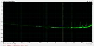

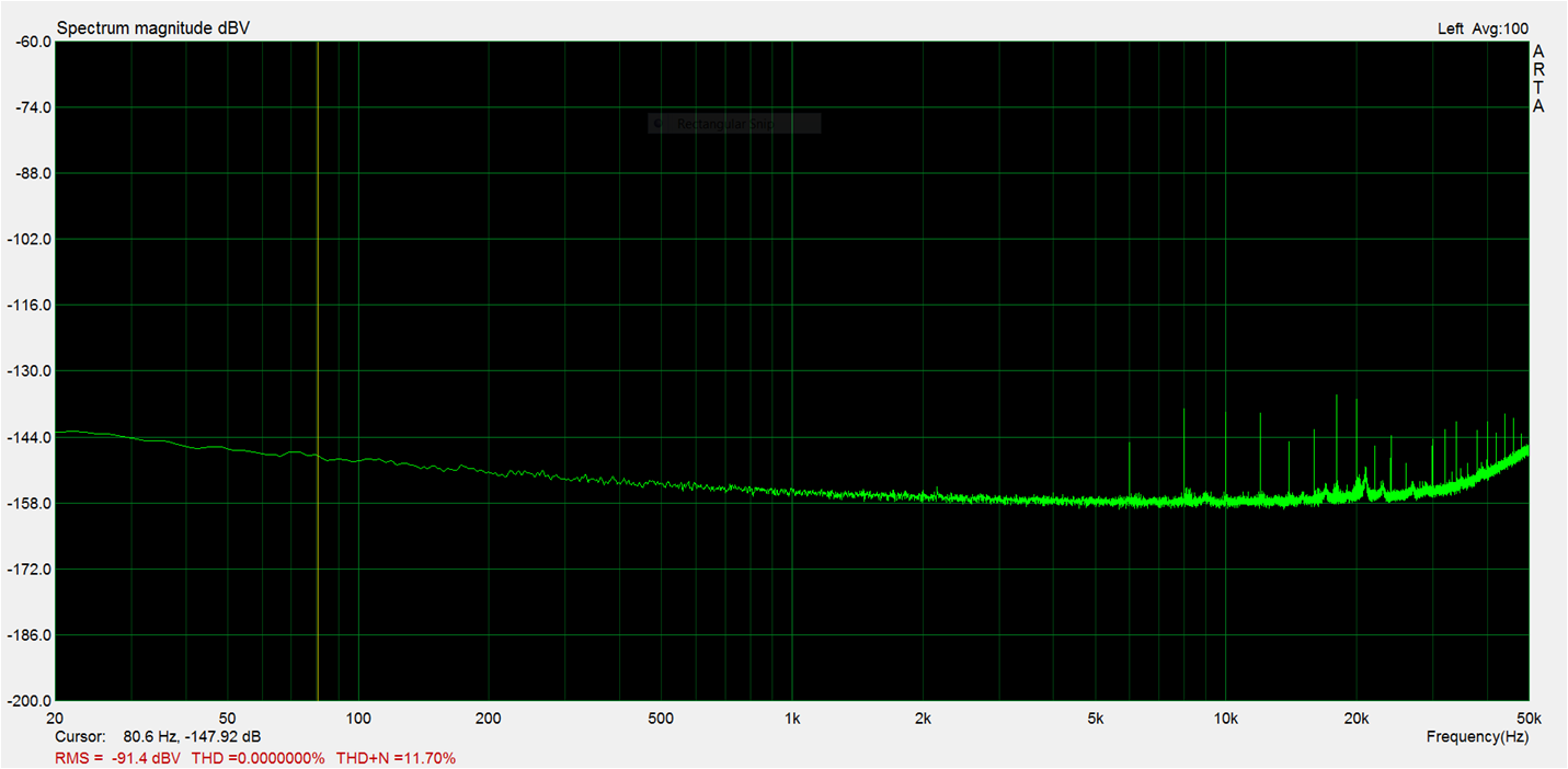

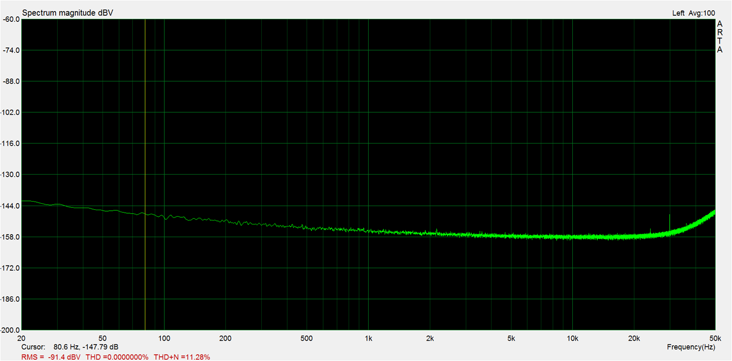

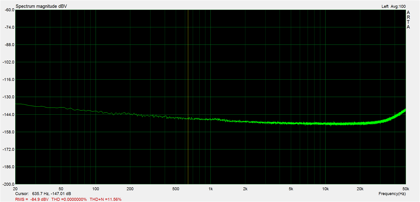

Just bought two units on Kijiji and modded them. Worked great. Thanks sidiy and everyone else who contributed.
In order:
Left 1 Before Left 1 After left 2 Before Left 2 After
Thanks again
Matt
