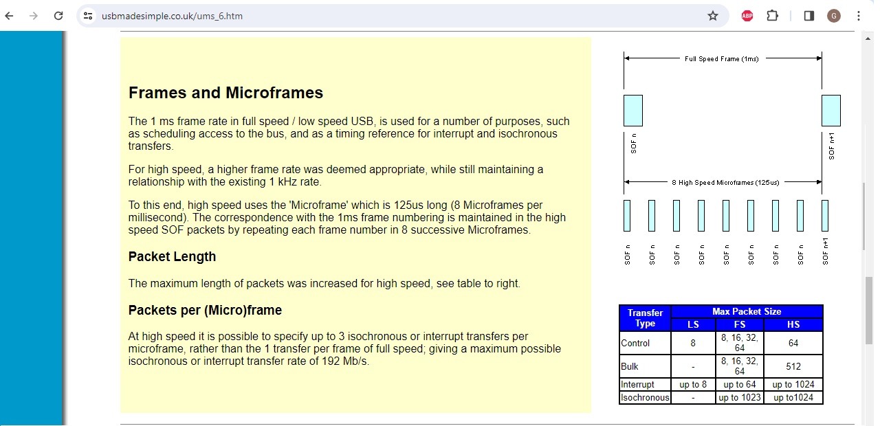

According to the link below, USB2 utilises 8 Microframes (125us) per USB1 frame (91ms)
https://www.usbmadesimple.co.uk/ums_6.htm

USB device (endpoint) specifies how often it expects/sends data, in USB descriptor bInterval. For USB2 highspeed (i.e. the E-MU) the value gives multiples of 125us microframes (125us, 250us, 500us, 1000us). Devices typically support several channel/samplerate/bInterval combinations - called alternate settings (altsets). When the driver opens the device it selects which altset will be used. Shorter packet interval means lower latency.
Linux lists these altsets for my E-MU 0404USB:
Please note that the device supports many combinations of channels/samplerates, nice. All combinations are available in 500us packet interval, those combinations that fit 1000us interval (adhering to the 1024 bytes per frame isochronous limit), are also available in that interval (to spare CPU and limit risk of underflows).
Linux USB driver picks the longest packet interval available, hence I cannot force the 500us interval for 48kHz. Likely your ASIO driver picks 500us (correctly, as ASIO focuses on latency) and therefore the artefacts of 2kHz in your RTA, IMHO. Exact details would be visible in USB packet capture e.g. via wireshark.
Devices using 1000us packet interval often have 1kHz artefact. For USB devices it's better to measure with a signal not exactly 1kHz, so that the measurement harmonics do not ovelap with the USB artefacts in RTA.
