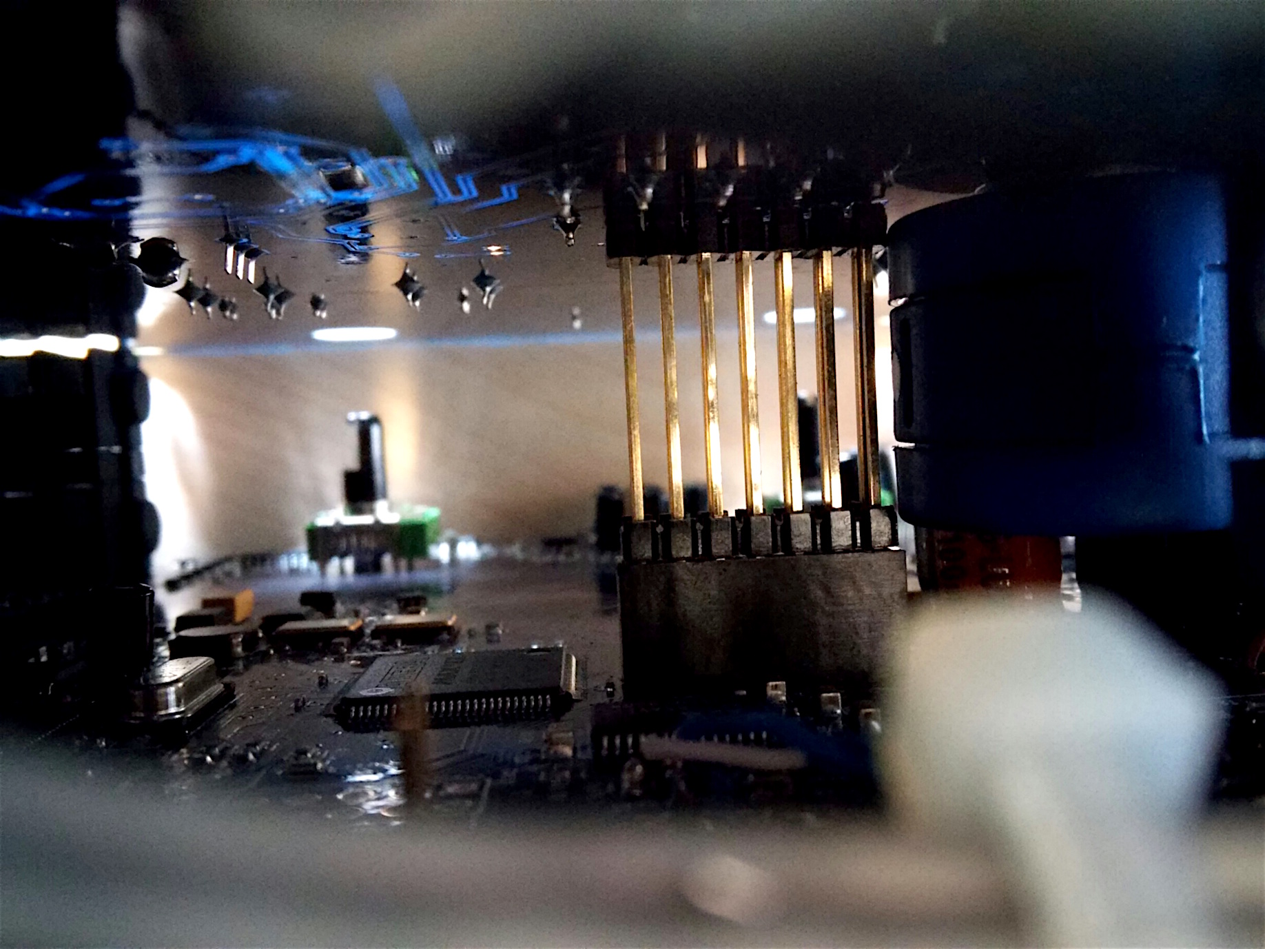

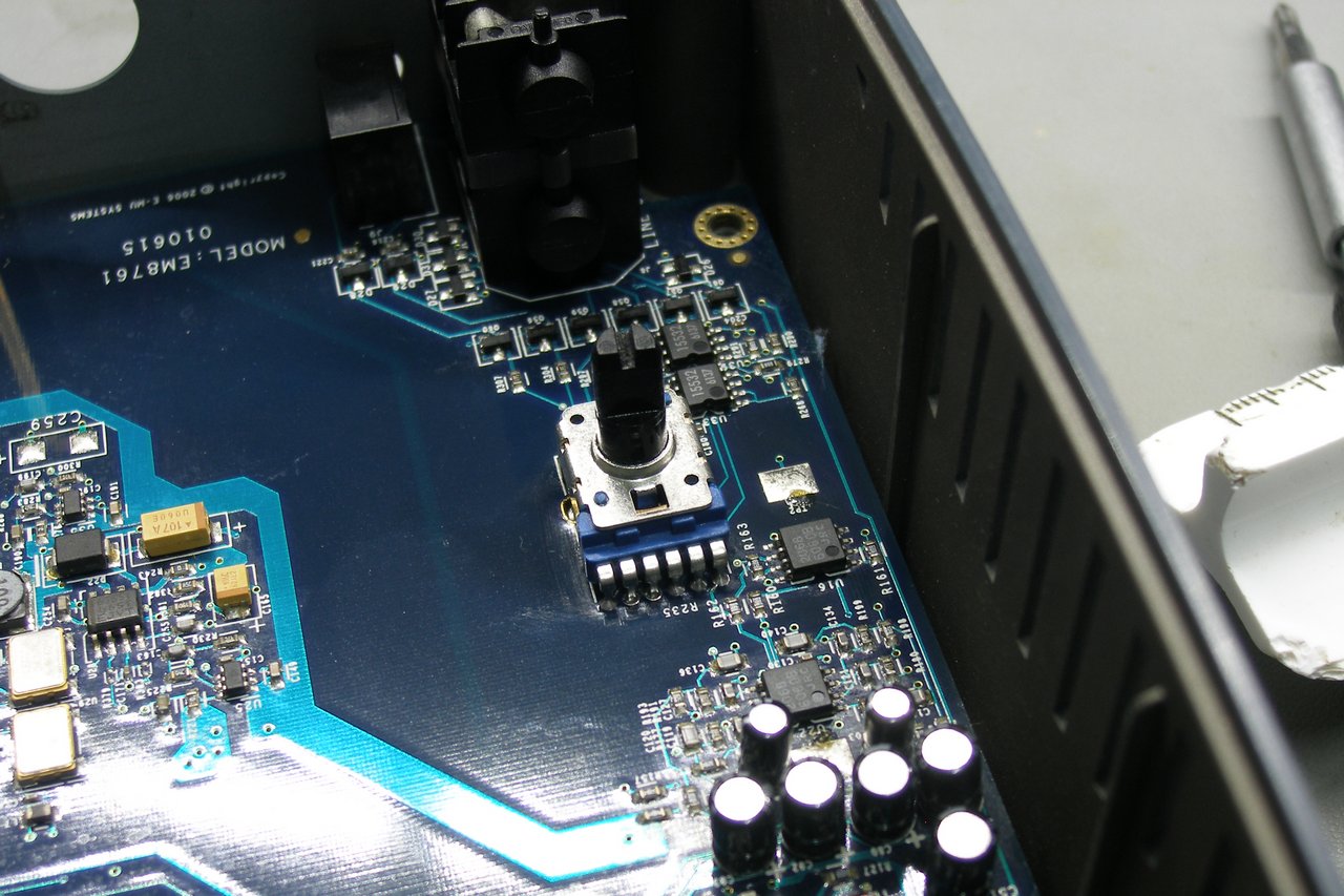

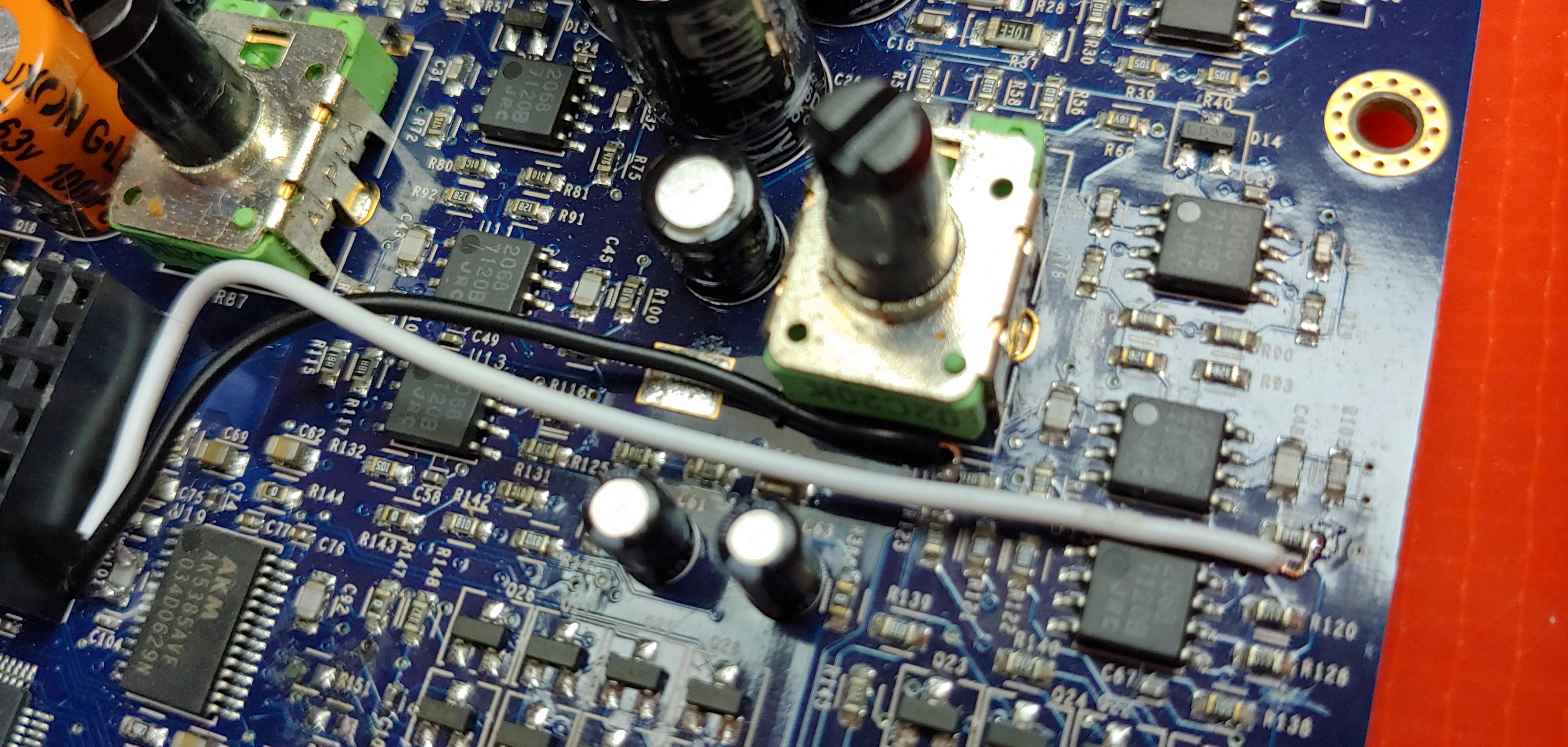

If you can't find the Alpha 10K main level pot, there is an equivalent from Bourns (PTV112-4420A-B103)
Here side by side by Alpha pot
Here it is, after change it.

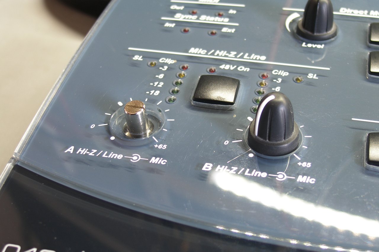

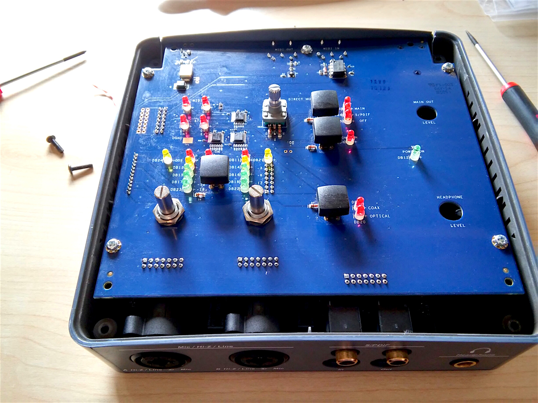

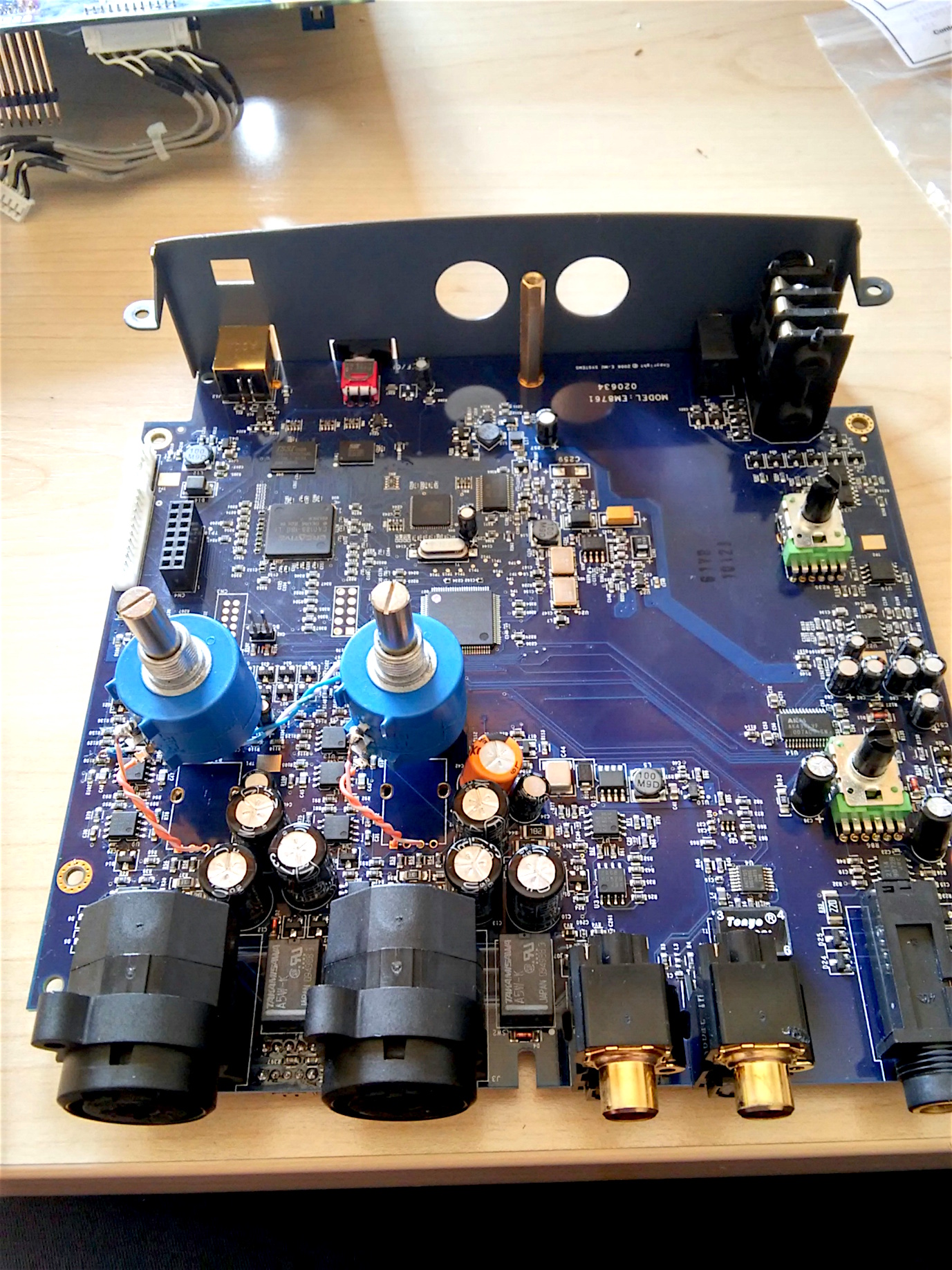

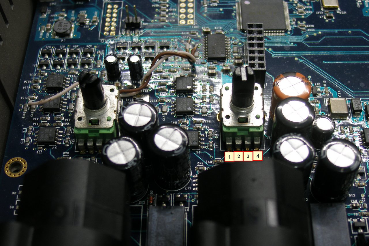

I would like to change the two inputs of ADC pots with the multiturn precision pots. They seems to be 20K with 4pins legs.
From what I have seen, the four legs from left to right, only the first three are operated, the last one not.
The combination of 1+3 and 2+3 gives the same (almost) result. I don't know well but it is related with xlr input (cold, hot).

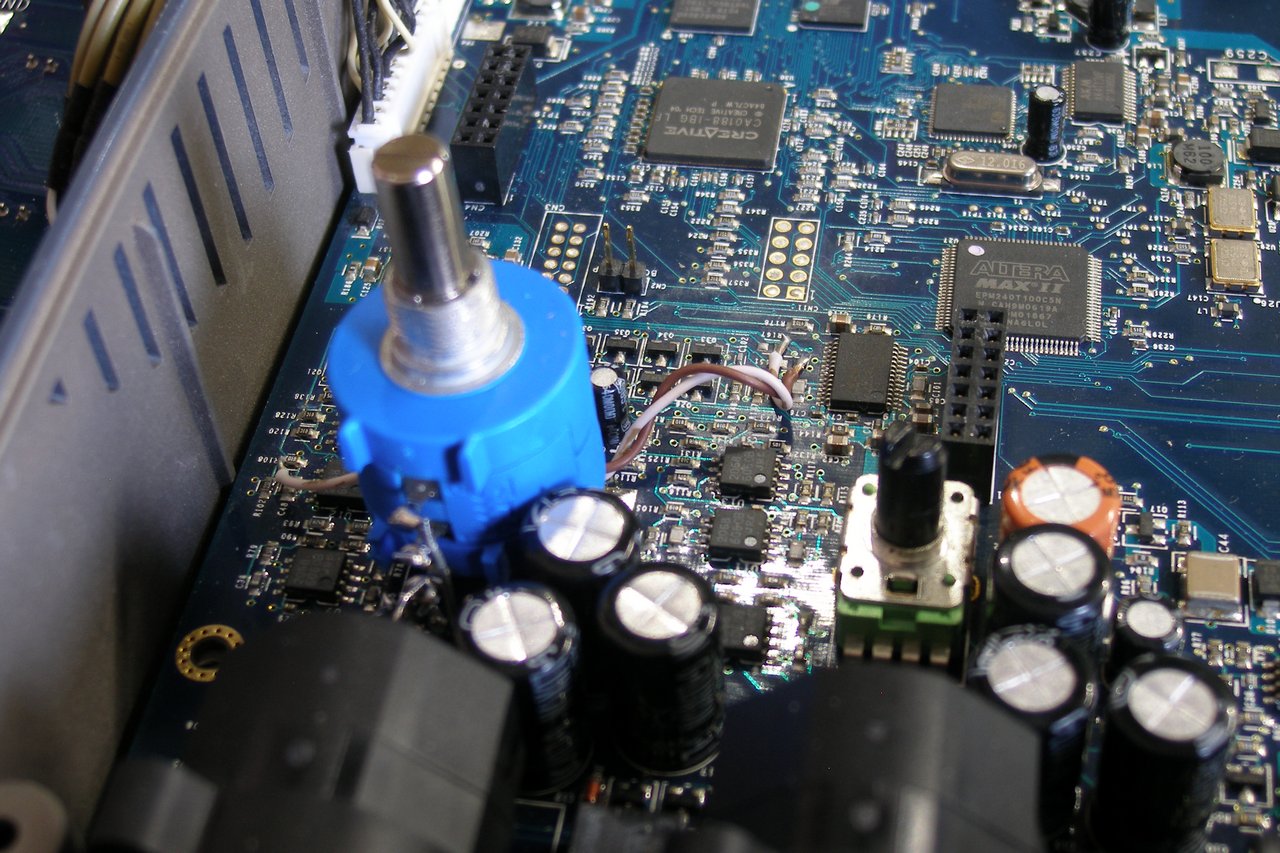

I would like to put a multiturn precision Bourns pot (3590S-2-203L) 10 turns, but it has 3 legs.
If I connect the middle leg of precision pot to the 1&2 position of pcb it will be good?

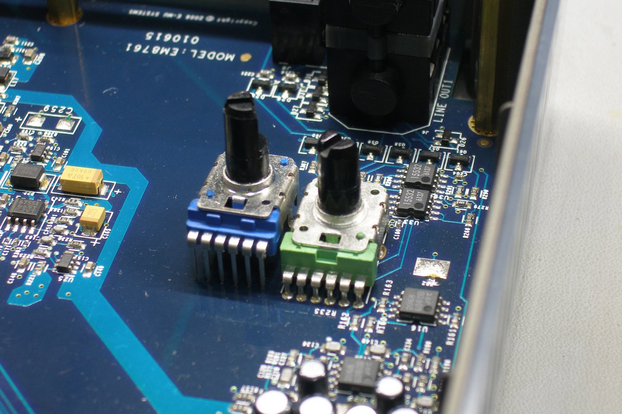

I was wrong about ADC input pots.
I removed them and the type is Alpha RV110F4020A02C20K 20K pot but measured about 3 Ohm - 17.6KOhm at the edges.
The pins are typical Pin1....Pin2(variable)....Pin3

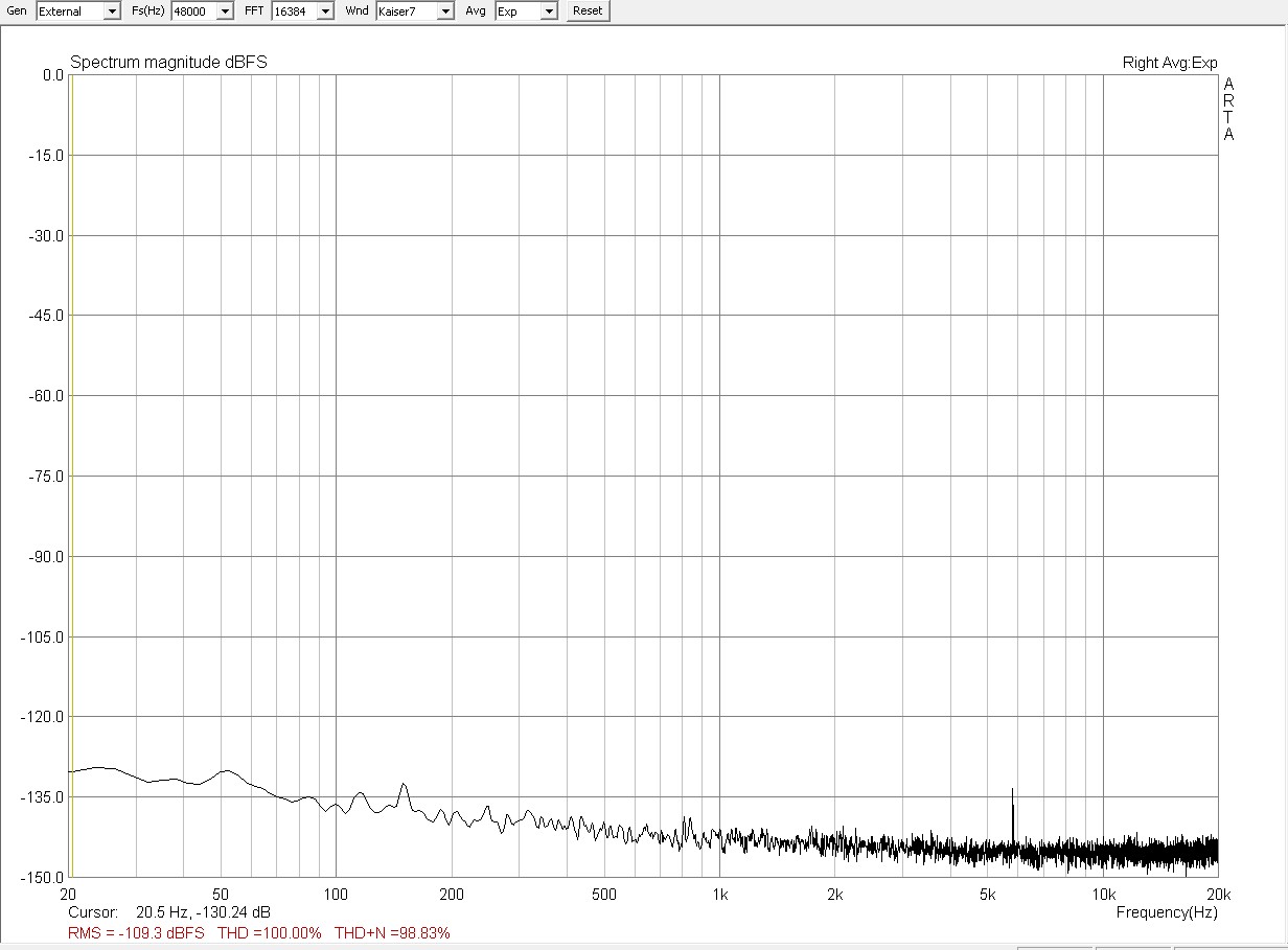

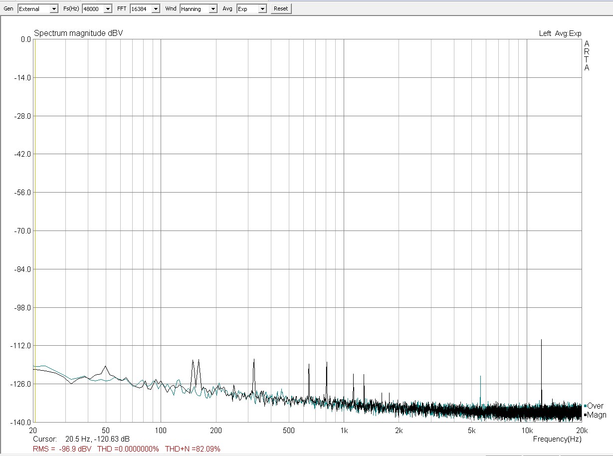

Unfortunately the Bourns precision multiturn rise up some spikes of noise, cause the length of cable btw pcb and pot legs. The sense of tuning for exactly level is marvelous!
I am searching for a solution...

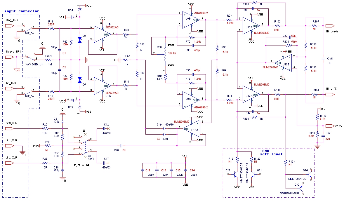

The EMU input circuit is differential and the pot functions as a variable resistor between two active nodes. You really only need two connections per channel to the pot but keep in mind that it works in reverse, the smallest resistance will be the highest gain (max clockwise).
One pin will most likely be grounding for the shaft. Its important because noise from either touching the shaft or intermittent connection to the shaft is quite audible.
The Bourns pots for the output are way better both in measured distortion and sonically than Alpha pots. I think that change would be well worth the effort. The wirewound multiturn pots may have higher "noise" when rotating but should be low noise when set. The internal inductance usually won't show in audio applications. The Vishay bulk foil trimmers are the best option if you can figure out how to implement them. http://www.vishaypg.com/docs/63055/Accutrim-1202.pdf There is a clip that will hold them to a panel and provide a thin shaft to pass through a panel. I found it!: Spectrol / Sfernice / Vishay - 6-1-1 - Trimmer Hardware - Mounting Adapter - Allied Electronics

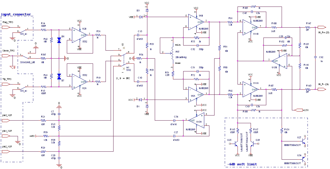

Hello again,

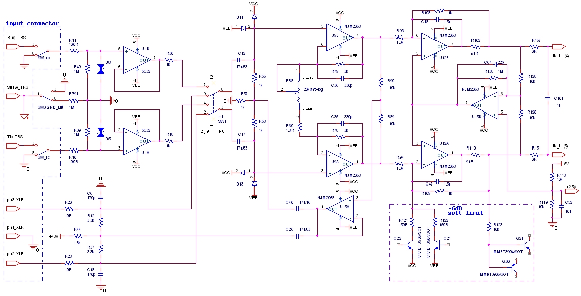

For those still interested I have some interesting schematics. Considering their quality, better never than later...😉! (I wanted to capture the whole screen ignoring that the RefDef's and values might appear too small). Anyway let's start with the inputs.
Considering the price point and the functions it has to cover I think that the circuitry is quite well designed. Many of you will recognize Bill Whitlock's patented bootstrapped input (not an expert but I will assume that everything was settled financially/legally – let's hope we're not upsetting anybody).
I agree with 1audio that the only worthy mod would be to clone a AK5394 pcb with or without optimized analog circuitry. The third attachment shows what I did to my left channel
About the Pot, I replaced the original anti-log 20k with a 10k linear (P110KH1-0F25BR10K, or 987-1290-ND at Digikey). Now it is easier to adjust and match the channels around “0dB” but not so easy at high gains. I also disabled the +48V dc-dc converter and removed most of the “pleasing -6dB soft limiter”
Personally I don't need the XLR MIC input (low impedance, carries also the phantom power). Only the TRS input is of interest for the type of measurements I'm doing (TS for single ended sources). Also the GND-Lift switch only works for the TRS connection.
For those interested to perform some of these mods it is very important to use close tolerance parts - I used 0.05% thin film resistors in most places. In red the parts that changed type or value, NI means not installed and you will recognize "our mod" the wire straps over R151, 167.

1audio thanks for the help.
Excelent work sidiy! Many thanks for these circuit captures!
I have the same think, that the best would be to clone a AK5394 pcb with or without optimized analog circuitry.

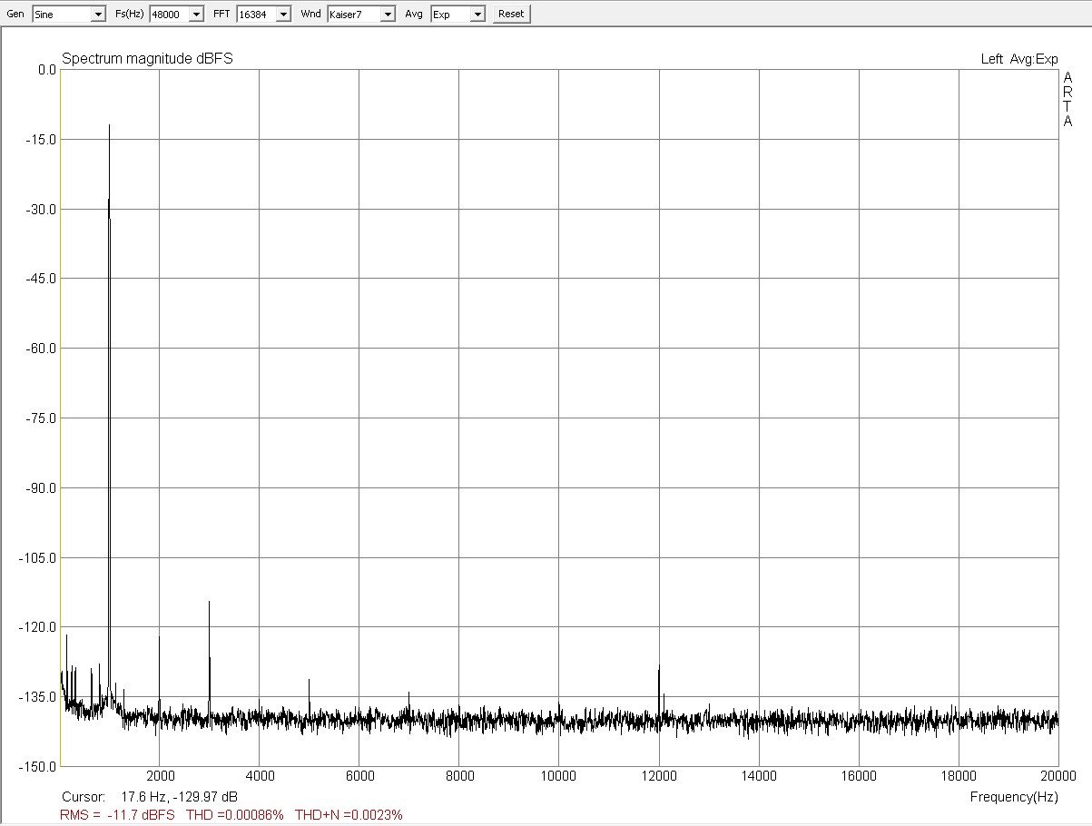

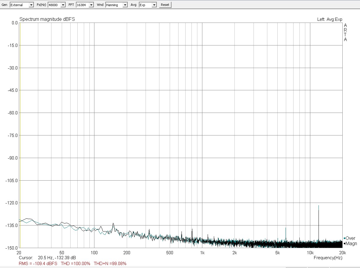

I don;t know what I do now! I procced with the 20K Bourns precision multi turn that I bought or put the P110KH1-0F25BR10K that sidiy suggest!
Look my installing untill now...
Start I used an utp cable with female pins to join with the pot (10cm approximately) but I had a lot of spikes, the circuit picks some noise (Long cables Left vs Right Ch, attatchment).
Then I used fixed wire from pcb to pot (Multi Turn Bourns1/2/3, attachments).
The spikes are less now! (Noise Floor Left multiturn vs Noise Floor Right, attachments).
The thd is fine.
All the measures are loopback.

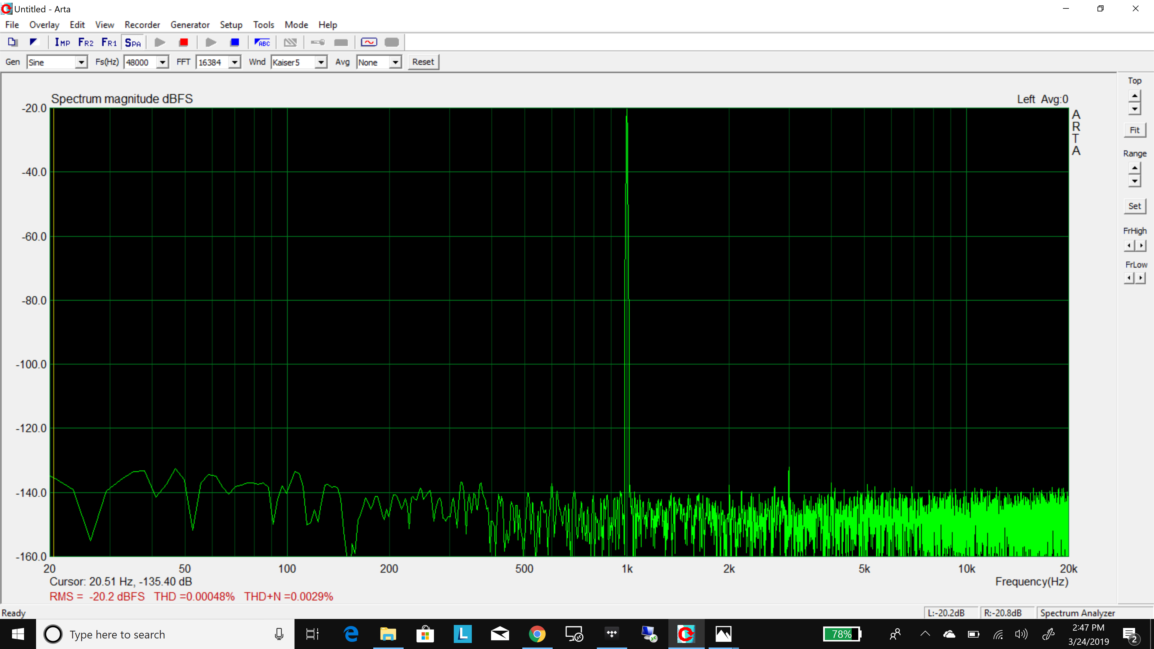

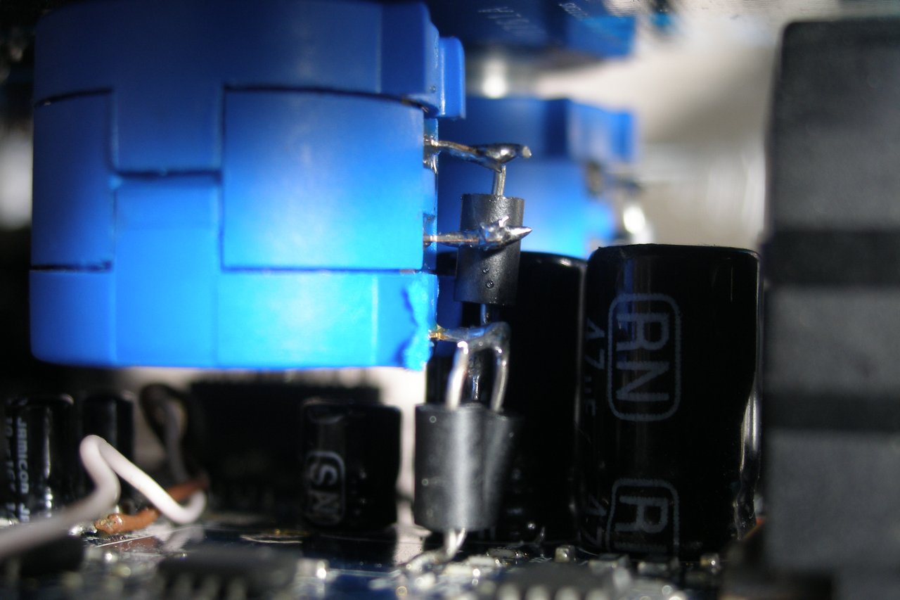

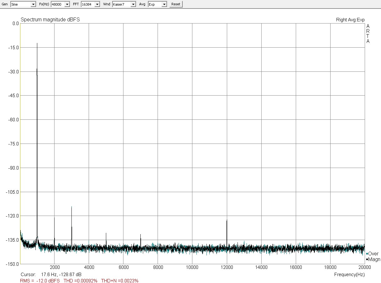

I think that I have a good result now...
I changed all the connecting wires from the pcb to pot and make the connection with the ferrites (see the attachment photo).
I was doing this to the two channels.
I think that the Noise Floor is good now and the spikes has 98% gone!
Here again a loopback thd and noise floor measures, both channels.

Did the Bourns multi-turn pot mod as well some time ago; the wire bypasses as well. No more cursing on those darn gain controls
Tight fit though; but works out fine 🙂
Very well Wirehead.be!
As I saw, you used utp cable. Have you any spikes at the FFT now (look my result with utp cables at #65 message) or everything is OK?
Hi lemon; no; I do not have spikes. I used solid wire, and twisted the conductors tightly together.
I proceed to change all the stock left input opa's and the output opa's of EMU with the LME49720.
My purpose was the THD improvement.
There is any significant improvement to THD, except the D2 measuring at the step test.

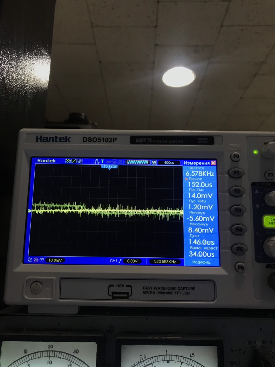

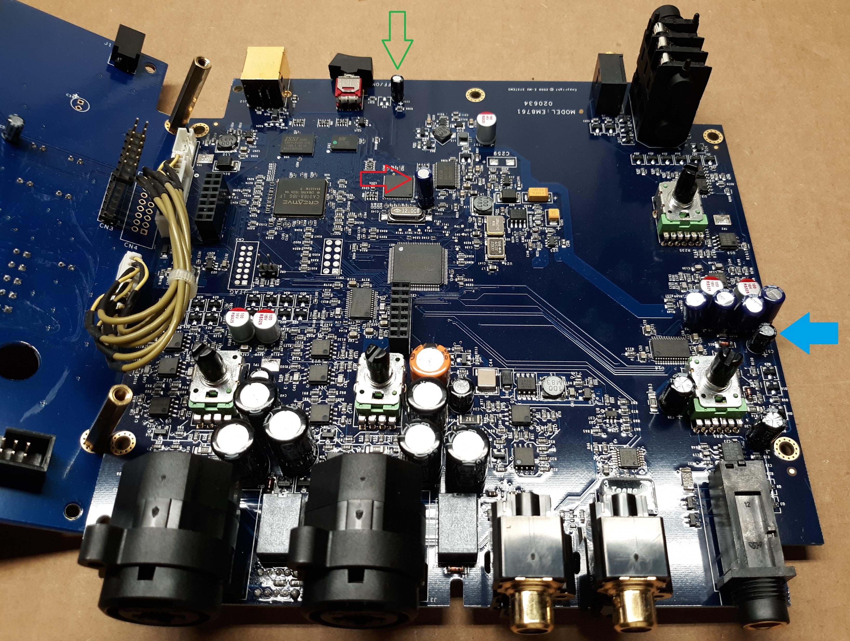

I cleaned the power supply oy (6v) with an example in the photo before and after, installed Sanyo low esr and parallelly shunted NP0 0.1 with ceramics. Pulsations of steel 1.2 mV (rms) (Sorry for my not always correct expression, I am writing through a translator, I am from Ukraine)
The photos (links) are dead in the "E-MU 0404 USB mod wiki" so I was wondering if anyone can identify the purpose of the caps marked with the arrows in the attachment. I think the red arrow marks the capacitor used to bypass the AK4113 DIR.
After replacing the DAC and op-amp capacitors the THD improved by about 2 dB. It still is not as good as my other E-MU 0404 USB. I assume that is just part to part variations?

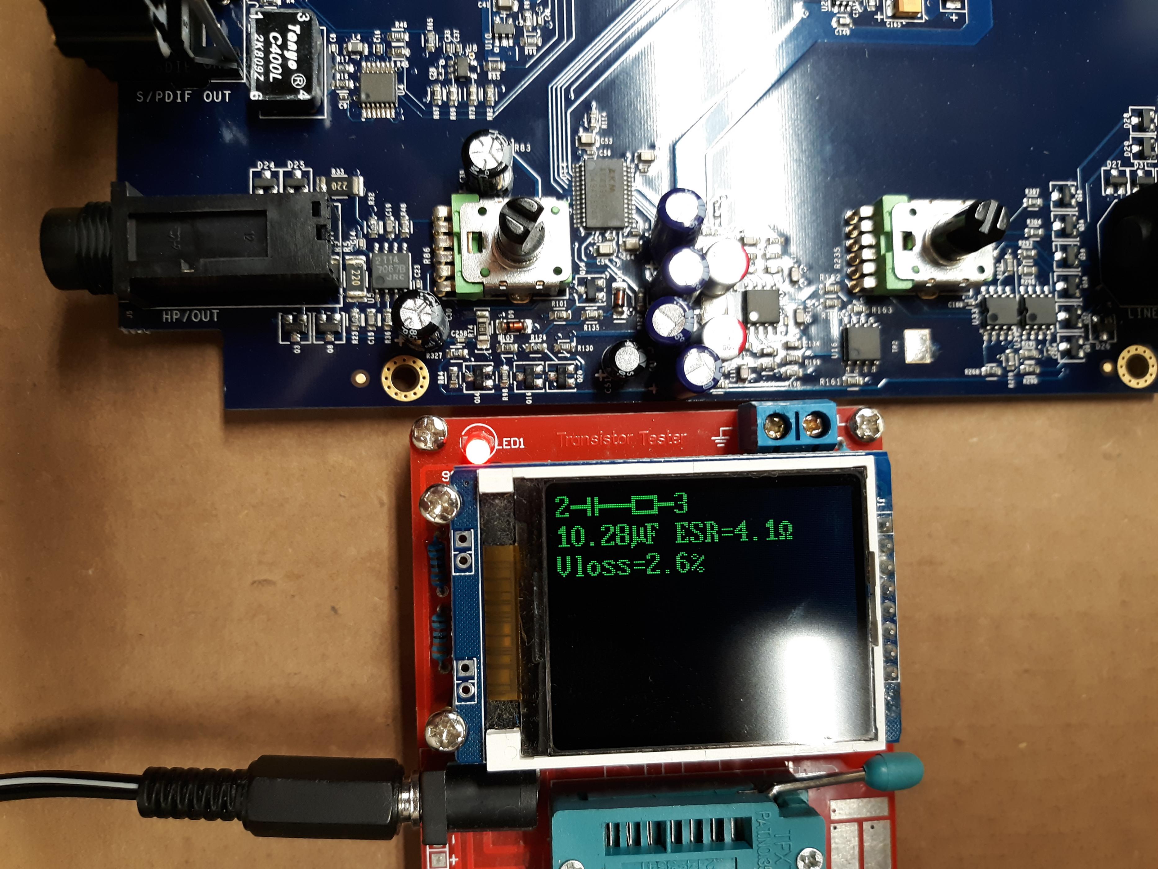

The 10uF bypass capacitors for the op-amps measured about 4 Ohms ESR when removed. Not great but certainly not as bad as the 1k Ohm ESR for the cooked capacitors I took out of the E-MU 1616m and 1820m microdocks.
I should have said "the left red arrow marks the capacitor used to bypass the AK4113 DIR."
I meant to change the arrow color but it is too late to edit the picture. So I have attached the picture again with a different color for each arrow. I would like to know the purpose of the capacitors marked with the blue and the green arrows.
