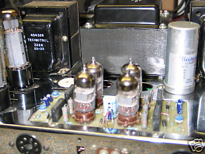

Hey Burnedfingers,
It looks pretty similar to a driver board I had and researched. Have a look at this thread and see if it is the same.

Burnedfingers,
If those are 6DJ8 or relatives, it looks like the first GSI board by Andy Fuchs. Probably a later version of the NYAL board. Andy worked there back in the day. I have a simple schematic of it somewhere. You might try Andy at Fuchs Audio Technology, does guitar amps now but still might help, at least with some info. If not I'll try to dig up what I have, I have lots of info on his second mod., 12AX7s and 6CG7s.

Burnedfingers,
Just pulled out an old 1986 issue of Audio Amateur, found the GSI ad and that is indeed the first GSI circuit, differential cascode using 6DJ8s.

Burnedfingers,
All I ever had of that circuit was what Andy drew for me years ago. There were a few part(s) values on the schematic and not much more, I'll dig it up, it may have some value to you. We were conversing back and forth back in '90/'91 when I was in the Gulf playing war. I got a few of the newer boards and was asking about the old circuit. Still have one set of the newer boards.

I got the amp today and guess what? The right channel is way low in level to the left. Upon checking the signal going to the output tubes is normal and then takes a nose dive. Any ideas?
This is where a schematic would be nice😉
