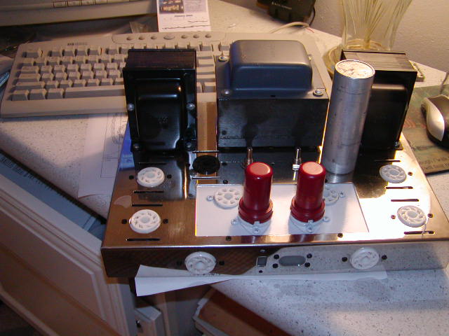

ST-70 Renewed - SWEET!
Yesterday, I received a new bare board from Tubedreams to replace my original PC-3. The old one was in very bad shape and it was very unstable. Two days earlier, I received a package with some ceramic octals and two new bias pot (the military ones).
So, last night I completely stripped my ST-70 and rebuilt it. Now, it's rock-solid and working beautifully. These things are so incredibly simple, I don't know why anyone would want anything else...
BTW - I found a company on the net that offers FREE SAMPLES of chassis and project boxes for the DIY-minded. They advertise a wide range of items and offer any item less than $75 as a sample. I asked them to send me one to start my tube preamp project. When I receive it, I'll let you all know about it and them. In the mean time - happy listenning!

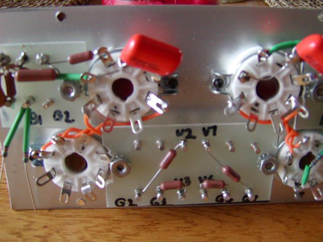

My Stereo 70 board is a tweeked Mapletree board. I have what I would like to think as better operating points plus I added a CCS to the long tail 6SL7. I generally use a 6Su7 in place of the 6Sl7.
The different resistor values plus the CCS make it sound superior to the Mapletree board in my opinion based on a side by side evaluation.
The schematic is online at Lloyds site. The values are not correct on his schematic however.
The board is not difficult to make at all. I made my own turret boards. There are three of them. The plate is a piece of scrap aluminum left over from a plate off a door.
Before anyone here gets excited about me making a similar circuit to what Lloyd sells the input portion of the circuit as well as the long tail can be found in several publications.
Picture of the board partially put together.
