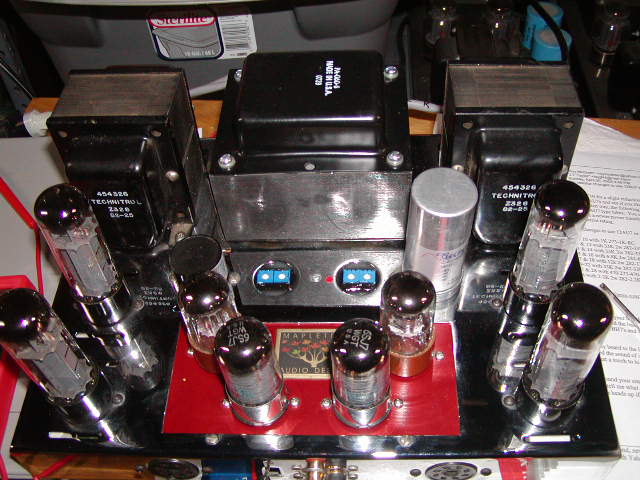

Picture of latest amp.
Unit was a recent purchase off eblay with a GSI board. The GSI board was pulled and I put this Mapletree driver board on today.
Only thing left to do is put a SDS cap board on it. With 6SJ7 input tube and 6SU7 long tail it sounds quite good to my old ears.😀
I like the Chrome chassis

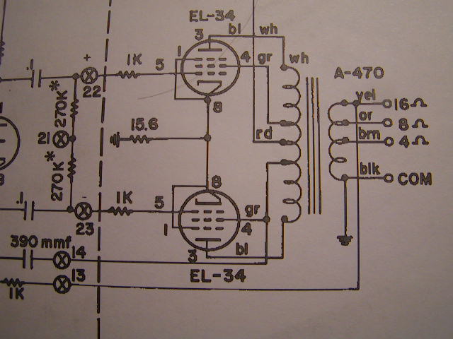

Feedback tap
Any advantage in taking the feedback off the 4 ohm tap for example if one has 4 ohm speakers hooked up verses the 16 ohm tap?
If so how does one calculate the difference?

I was wondering since I have only 4 ohms speakers that I drive with my Dynaco would there be any advantage to soldering the feedback line to the 4 ohm tap? I have been told there would be an advantage but I do not see how since the feedback would end up being a the same if taken off the 4 ohm tap with different sized resistor and cap.
I realize the resistor and cap size would change if the feedback were off the 4 ohm tap instead of the 16 ohm tap.
burnedfingers said:I was wondering since I have only 4 ohms speakers that I drive with my Dynaco would there be any advantage to soldering the feedback line to the 4 ohm tap? I have been told there would be an advantage but I do not see how since the feedback would end up being a the same if taken off the 4 ohm tap with different sized resistor and cap.
Hold on there... The feedback line comes off the primary side of the output transformer...and has a purpose all of its own. The segmented taps (4, 8, & 16 ohms) all come off the other side - the output side - of the output transformers. Don't link the two sides together.......that would be disasterous.
Now, if I have not clearly understood what you are identifying as a "feedback line" then I still don't understand. My guess is that you connected the 4 ohm speaker positive terminal to the 4 ohm tap on the output side of the tranny (as designed) and you connected the negative side of the speaker to chassis ground (the black lug). Is this correct? If so, no change is needed. If not, then I'm still confused...
Brian
Look at the schematic
You will see the feedback taken off the 16 ohm tap on the secondary side of the transformer.
My question is.... If I re-calculated the value of the feedback resistor which is 1K in the case of the Dynaco Stereo 70 driver board to a value of 500 ohms and re-soldered the feedback line to the 4 ohm tap would this be more correct than using the 16 ohm tap? I have 4 ohm speakers.
I also have a different amplifier which has a resistor and cap in the feedback loop and both would have to be re-sized.
Sorry for your misunderstanding as I did not mention anything about changing a thing on the primary side of the transformer.
I hope that you can see where I am coming from now.🙁
The stock ST70 has two feedback paths, one from the primary (UL tap) and one from the secondary (16 Ohm tap). What Burnedfingers is asking is if he moves the feedback from 16 to 4 what size resistor to use to get the same amount of feedback as the stock circuit. The signal on the 4 Ohm tap is much lower in level that the 16 Ohm tap, so a smaller resistor is in order. The whole idea of this is to get the speaker connected directly to the feedback. This may or may not sound better, but no harm in trying. I would get a variable resistor, adjust it until the output is the same (Watts wise) as the 16 Ohm, 1KOhm combo. Then read the resistance and replace with a resistor that is close.
Craig
Craig
In theory, it's better, but in practice, I haven't found a difference. Anyway, resizing is easy- the 4 ohm tap is actually in the center of the winding, so just cut the resistor in half. I think it was 1k, so use a 500R (470R or 510R will be fine, as will be two 1k in parallel).
