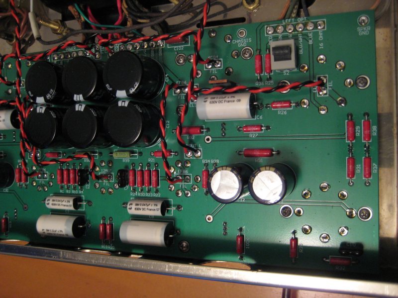

@scottw
The board in the picture is one I just finished designing and building. I'm working on a second revision that only uses one standard FW rectifier in place of the two damper diodes, and makes a few fixes to some of the little things I didn't like with the first revision like the placement of the bias adjustment and a few other things.
I didn't like the huge boards that sit above the chassis, and I didn't like the small boards that sit below, so I measured out all the holes and tube locations and made a board that covers the whole bottom of the chassis and has PCB mount tube sockets.
I think it looks much cleaner than the usual spaghetti mess you see under ST-70's, and it allows better parts placement and layout since you're not confined to the tiny space of the original board.
If you're interested drop me a note and I can send you some details on it.
Owen
Yes, nice looking board. I hadn't recalled ever seeing an after-market board that covered that much chassis real estate and had the octals mounted to it.
Maybe some of those high voltage SIC schottky's?
If I had a "real" ST70.....I ended up with a Series II and I don't think the mounting holes match up. Dang it. I'm stuck with the series II front end, 6gh8/6u8/7687, a while longer.
Thanks,
Scott
