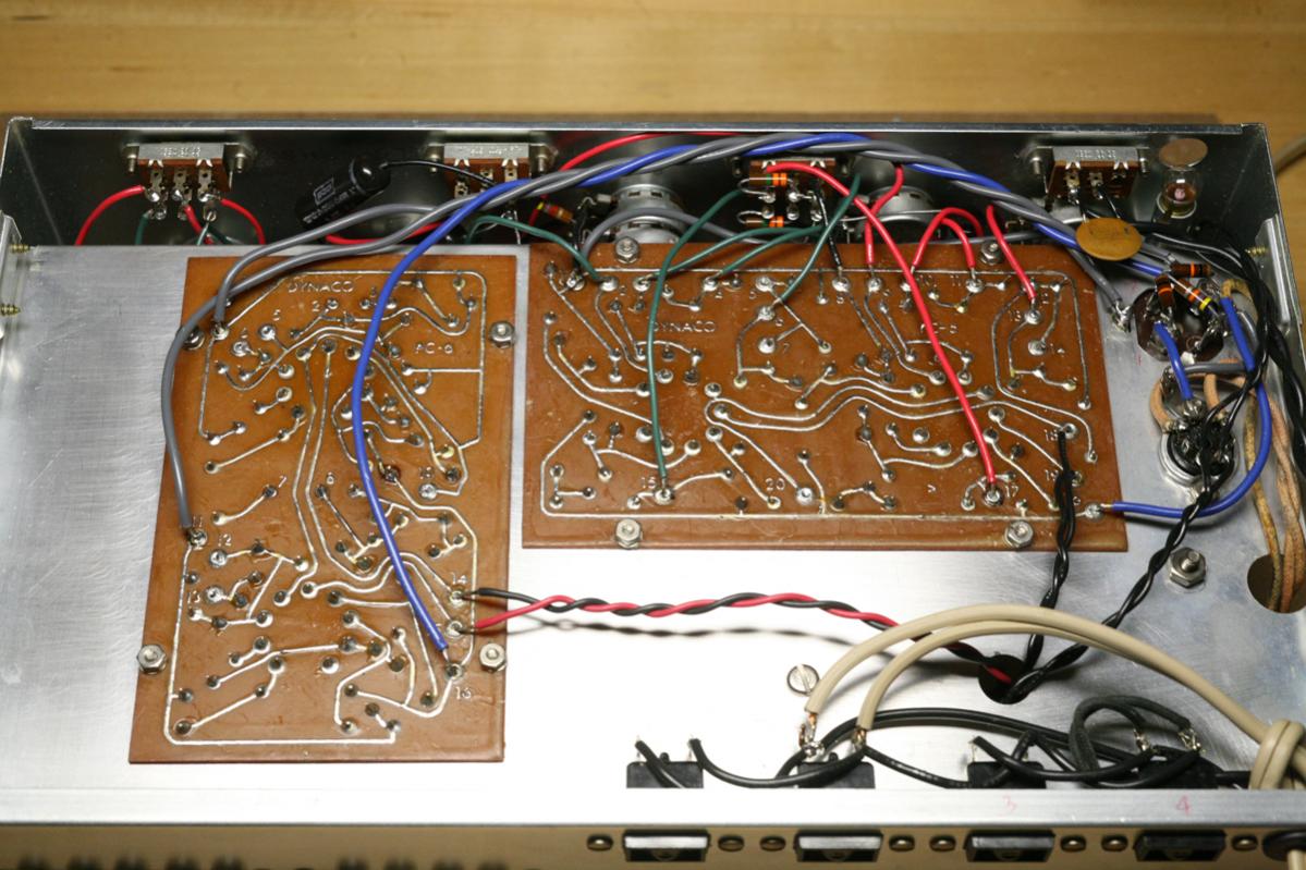

I powered it up slowly plugged into a home-made dim-bulb tester which is plugged into a variac/isolation transformer. No sparks, smoke, etc.
Taking readings with a multimeter here is what I come up with (the first measurement is reprinted from the PAS Voltage Chart)
PINS
12X4
1_____(335 V AC) 330 V
2_____(0) 0
3-4___(10.5 V AC) 10.3 V
5_____(0) 0
6_____(335 V AC) 330 V
7_____(405 V DC) 390 V
12AX7 / 12AX7 (PC-5)
1_____(175 V DC) 151 V / 153 V
2_____(0) 0 / 0
3_____(1.45 V DC) 1.5 V / 1.46 V
4_____(LESS THAN 1 V) .2 V / .3 V
5_____(+- 11 V DC) -11.4 V / +11.5 V
6_____(200 V DC) 178 V / 183 V
7_____(0) 0 / 0
8_____(1.25 V DC) 1.29 V / 1.2 V
9_____(+- 5.5 V DC) -5.7 V / +5.7 V
12AX7 / 12AX7 (PC-6)
1_____(115 V DC) 94 V / 96 V
2_____(0) 0 V / 0 V
3_____(.7 V DC) .65 V / .68 V
4_____(0) 0 V / .005 V
5_____(+- 11 V DC) +11.5 V / -11.5 V
6_____(135 V DC) 117 V / 116 V
7_____(0) -.09 V / -.04 V
8_____(.8 V DC) .75 V / .76 V
9_____(+- 5.5 V DC) +5.68 V / -5.7 V

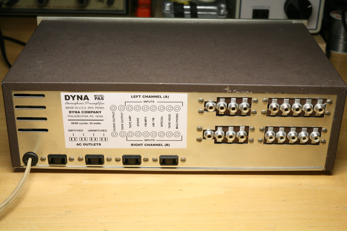

Really good, and you have the later machined aluminum knobs, instead of the cast ones.
Thanks. Yes, I just noticed the difference between the PAS knobs and those on my FM3 which have sharper edges.

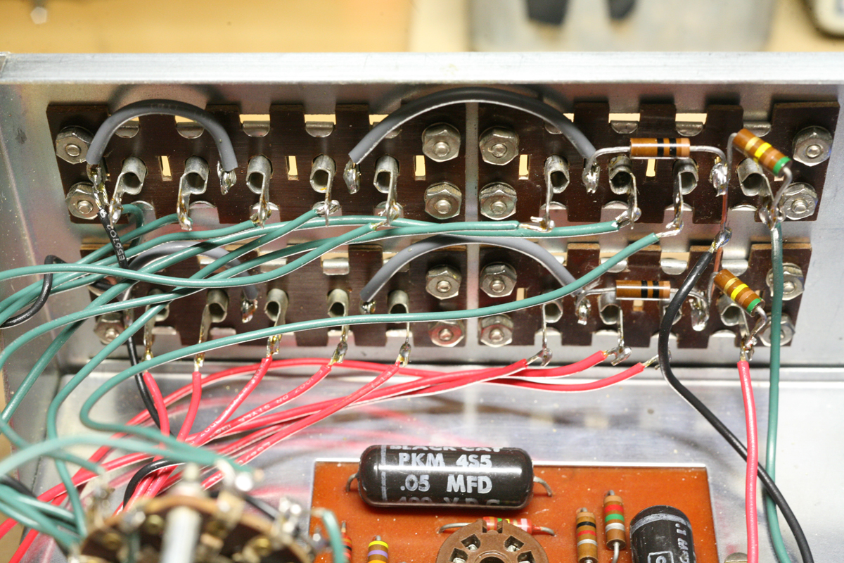

Been listening to the PAS for a couple of hours now. It's very quiet except when switching to and from PHONO and TAPE HEAD, there is a pronounced "thump" when doing so.
That's what happens when the eq feedback components are hot switched. Most would not need to do that.
It's best for current users to relocate all the RIAA parts to the board, which gives 3 phono inputs instead
of a mic, a tape head, and a phono input.

The hump when switching to phono comes from the exit caps on the phono board, they have no load whatsoever when not selected. Thus they may (and can) discharge the exit caps leaving the output a few volt above ground.Thanks. Yes, I just noticed the difference between the PAS knobs and those on my FM3 which have sharper edges.
A resistor of 470k mounted at the underside of the board will keep them at ground voltage. ( eyelet 1 and 7 on PC 6)

Can the "Tape Head" input be converted to "Line Level" ?
This shows how good those "black cats" really are.
I don't plan on using the "Tape Head" or "Special" inputs as-is so the noise won't be a problem but I would consider converting the "T-H" to something more useful if possible.
I don't think the Dyna selector switch can do that. Unless you replace it with a more standard switch,
about all you can do is have three phono inputs, by not switching the eq parts.
I see, I don't need another phono input so I'll just stay away from that part of the dial.
I have a couple more PAS preamps that need work, one of which I intend to do some mods to so will probably get a new selector switch while I'm at it.
In that case, mount the two 750pF capacitors directly on the board, where the wires from the switch usually go.
Also, wire the two phono inputs directly to the board, using twisted pairs.
Also silicon diodes for the filaments, and film caps instead of electrolytics for the output caps.
