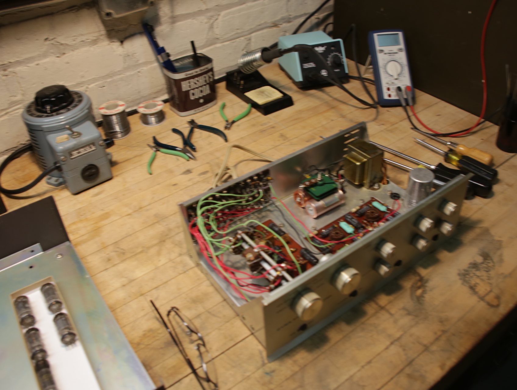

This is my first attempt at re-building an electronic component. It was partially inspired by the late Bill Thomas over at audiocircle and his PAS 3 and SCA 35 projects which he very meticulously documented. I've done some minor repairs in the past but not anything of substance.
My goal is to restore this PAS 3X with minimal if any mods. The exception is the replacement of the selenium rectifier with a pair of diodes as recommended by Curcio Audio Engineering, but I'm open to other options if anyone has any suggestions. Again, I'd like to keep this PAS as close to the original design as possible. I have a couple of other PAS preamps that need work and if all goes well here, will attempt to bring them back to life and with the help of this forum, hopefully improve upon the original design.
So, with a little extra time on my hands yesterday and today, I completely stripped the preamp of all of the gloopy solder and spaghetti like wiring from the chassis and got everything cleaned up.

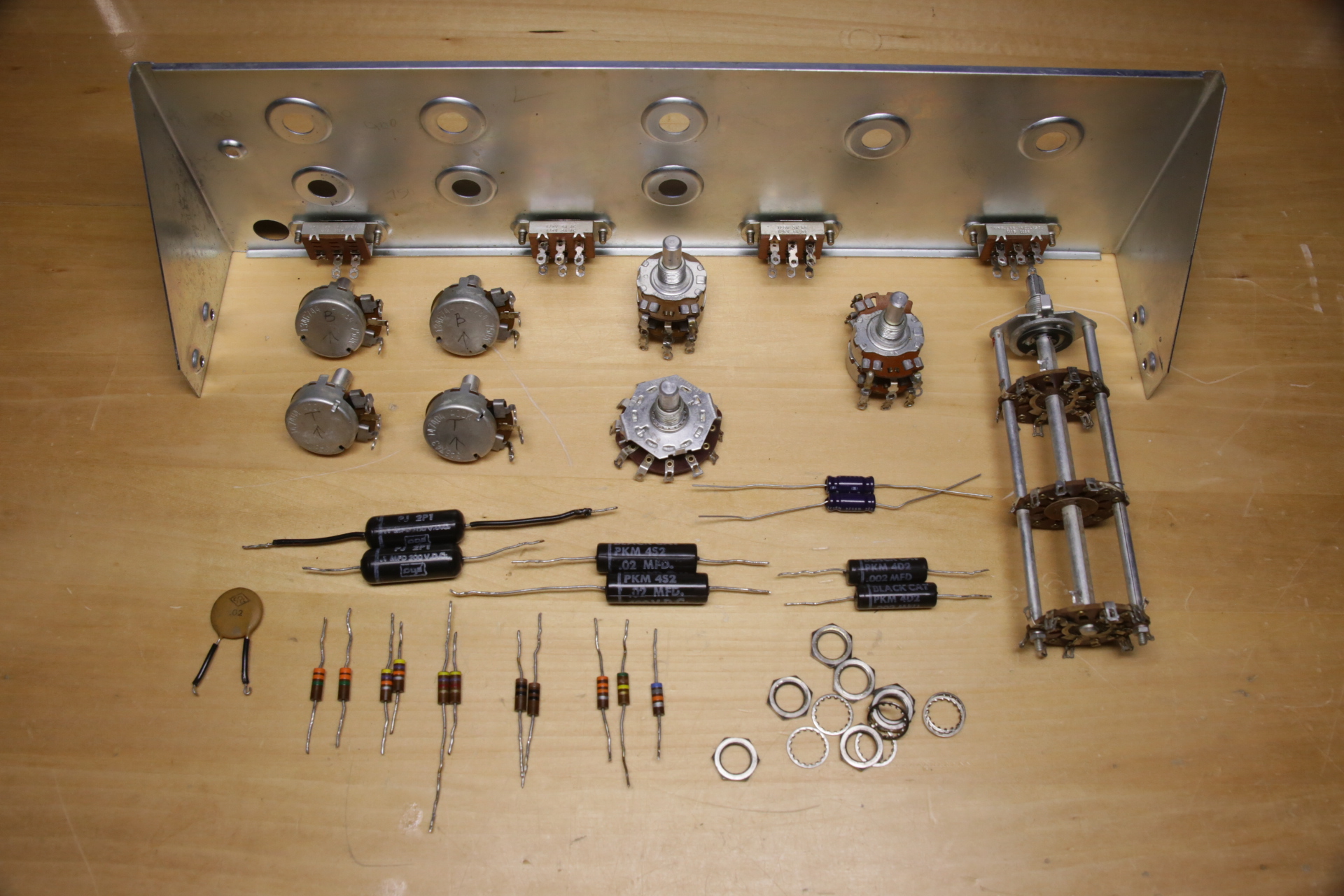

Here is the front panel and components ready for wiring. With the exception of the two 1 mfd capacitors, all of the components tested good.
You are in luck your GI paper capacitors are sealed. I had one burned open by the builder, who hid the burn on the bottom. It didn't prevent moisture from getting in and changing the value. I changed the .020 uf capacitors for .022 uf MKT, which made it sound weird. Very trebly. Unfortunately the one with the burn was the last one I changed out. Have collected some .018 uf and .0018 uf Polypro caps for the 2nd attempt but my op amp disco mixer is sounding so good I haven't bothered. 1/100 th the power use.
On the schematic I have, which is not original, there are a couple of 100 nf capacitors and no 1 uf ones that I see. 1 uf was very expensive in 1960. Also huge, about 2.5" long x 1" diameter.

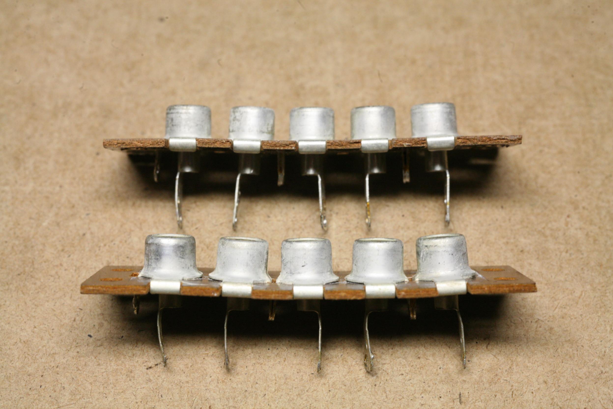

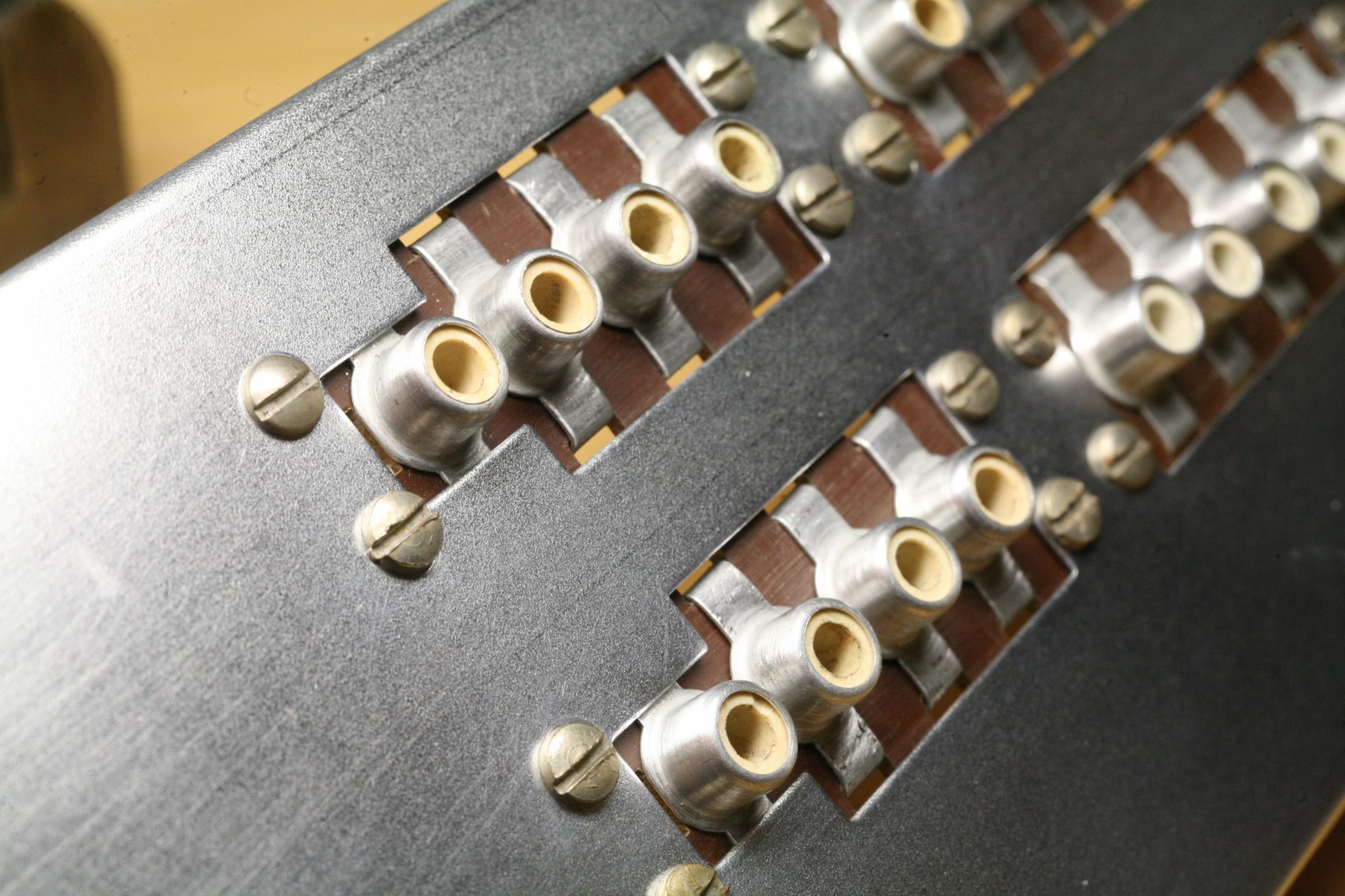

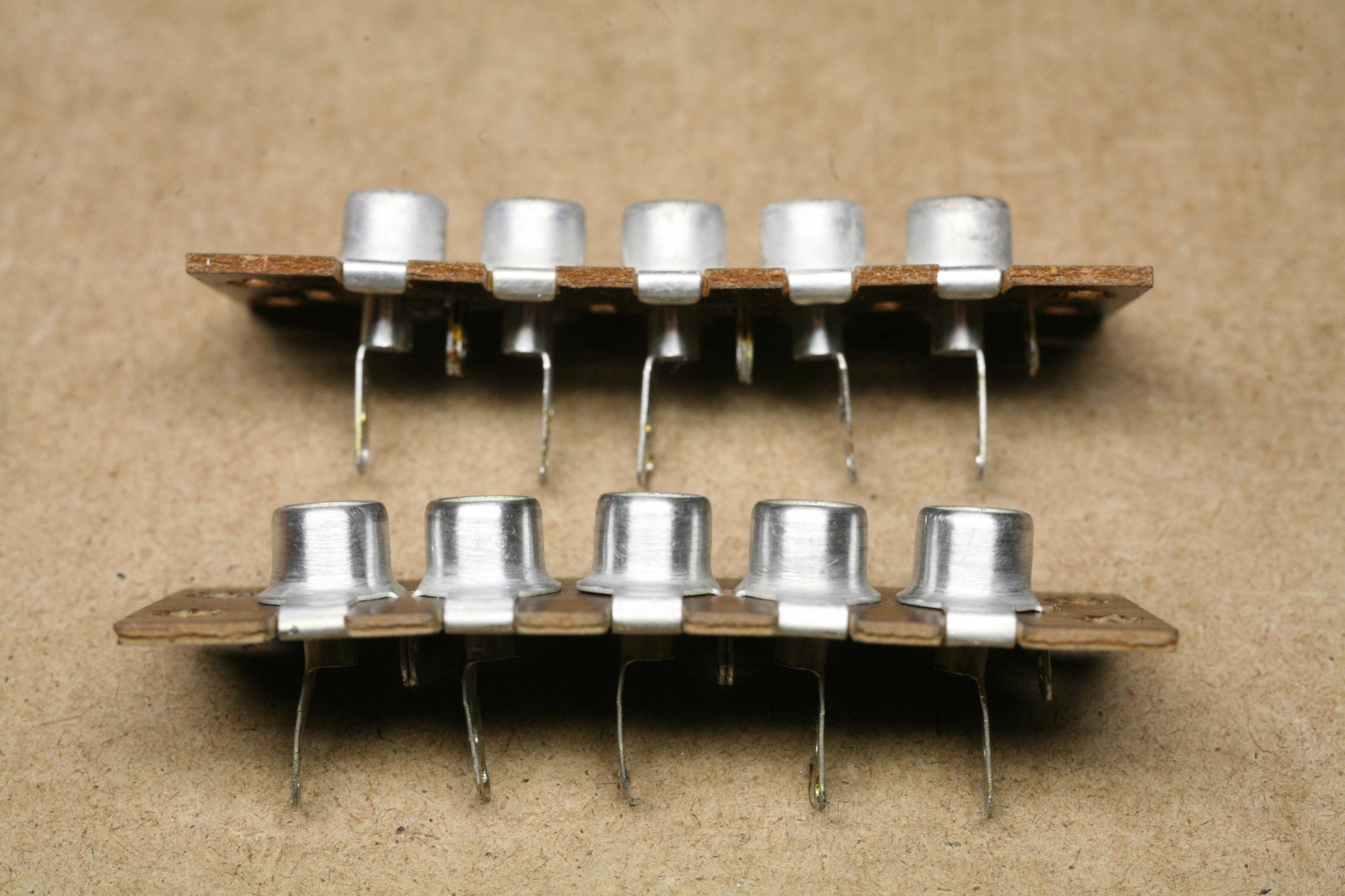

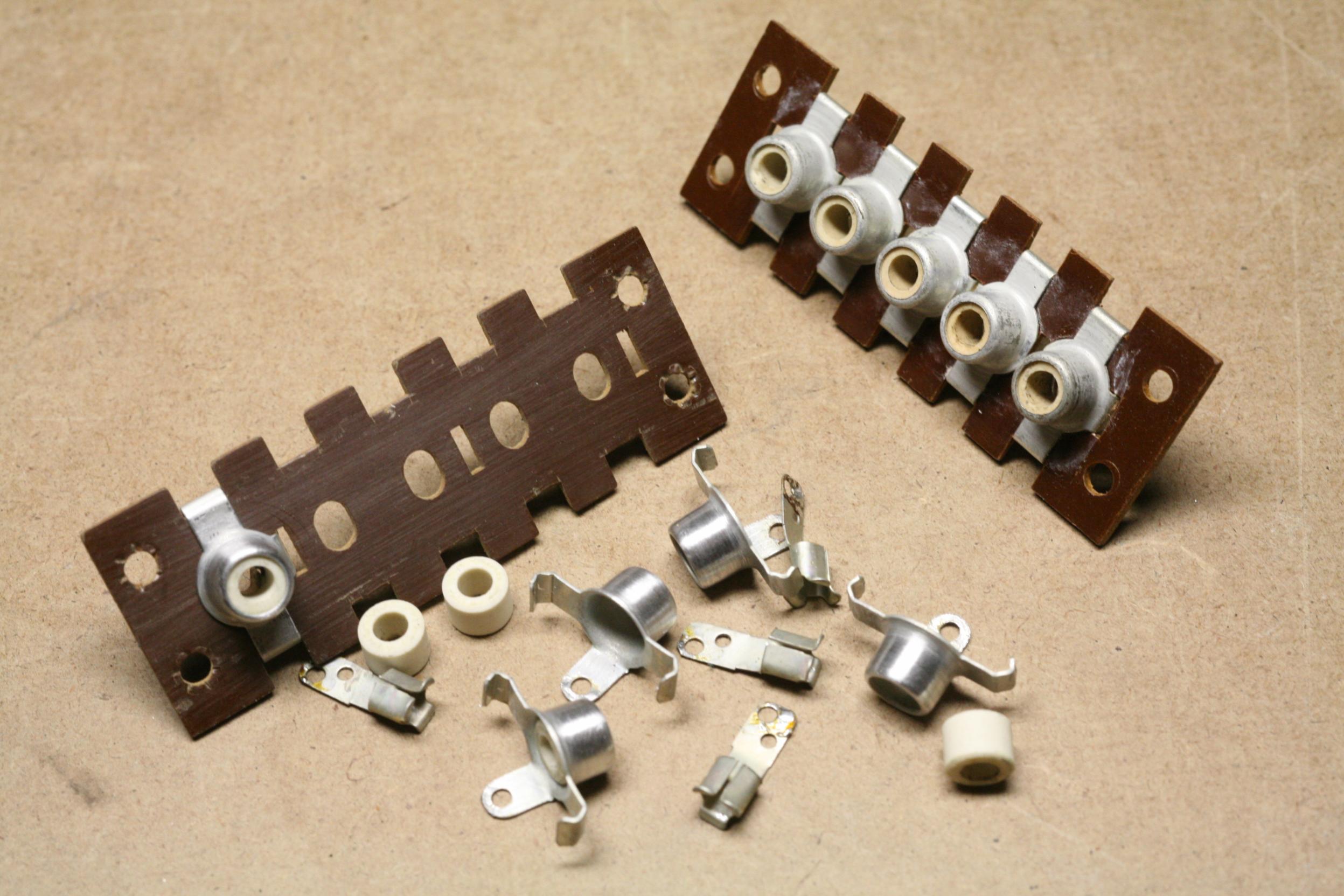

The RCA jacks on this PAS have always bugged me because of the inward curvature of the phenolic bases.
I considered after-market upgrades but they are out of stock at PAS Modern RCA Jack Kit - Dynakit Parts.
After considering other options, I decided to try to restore the originals, reversing the phenolic so that when installed, the chassis would flatten them out.

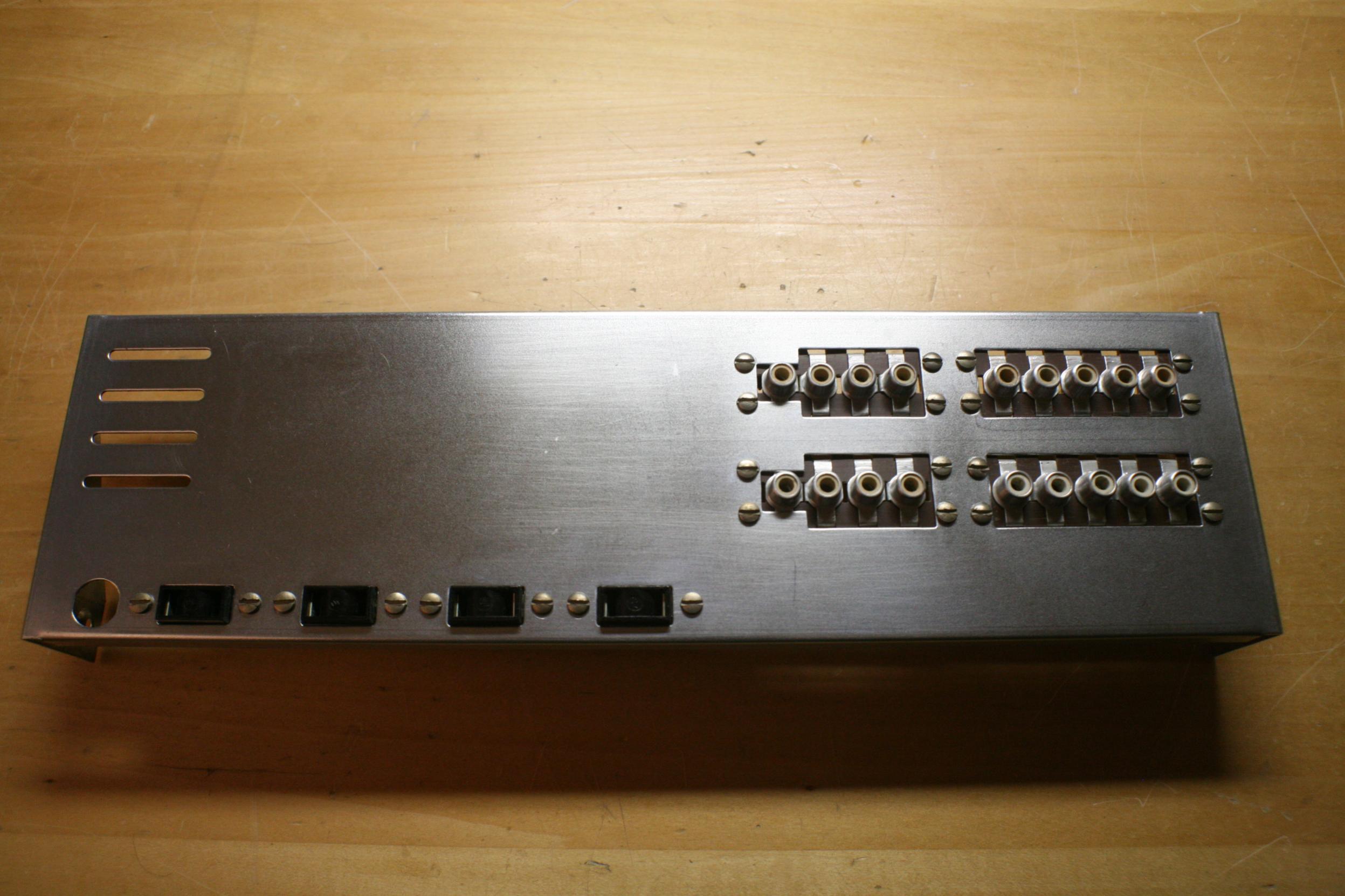

Very tidy, keep up the good work.
Thank you.
Had I bought new components it would have been a cleaner build but I want to keep this as original as possible.
