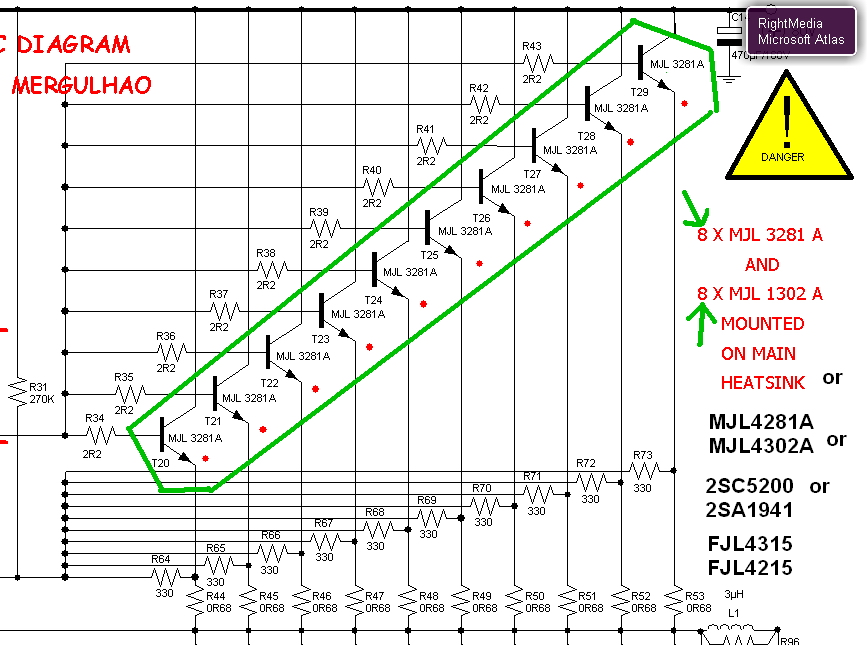

I am lowering the supply voltage to 80V symetrical supply
Because this is the real voltage i am having while using low impedance loads.... this way, i cannot guarantee the amplifier will survive if the user manage to have steady 100 volts each rail (SMPS).
It is possible, because reasons pointed in that thread by several forum members, the amplifier will not survive to very low impedance loads when the supply had not voltage drop.
In the name of more safety to Dx amplifier builders, keeping the traditional reliability, i am going backwards, suggesting from now on, to you to use 80 volts supplies.
A matter of fact, as i told you folks, it was tested, but not unders steady 100 volts as i have not that huge supply....so...untested under this voltage and i cannot guarantee it gonna survive to heavy duty under this voltage.
So, Eesbiboi and other folks interested, i am removing the guarantee i gave the amplifier will be reliable using 100 volts supplies and i am dropping down to 80 volts, as this is the voltage i have tested and proved i can trust.
SOA means safe....does not means the transistor will be destroyed if instead of 1 amperes under 100 volts you make it drain 1.1 ampere....in the reality it can hold much more than these graphics shows.... these graphics shows the guaranteed maximum operation current related the voltage... but there are more room because the transistor manufacturer safety room.... means the transistor can hold more, but the specify this way to me more safe the them.
Also 64 volts condensers can hold much more current.
I am going backwards not because i do not believe the amplifeir will survive.... the real problem is that i fear the use folks can give to it, some may install lots of speakers in parallel, some passive crossovers...long lines of wiring to speakers and these speakers can have a lower impedance compared to the indicated impedance... and this can kill almost all amplifiers.
Going to the safest side of the crowd..... now guaranteed till 80 plus 80 volts only and safe lowest impedance to 4 ohms...... so...it is not a kilowatt amplifier anymore.
Maximum output power, to 4 ohms will be around 650 watts... this means the amplifier is now 1.3 Kilowatt amplifier when stereo was assembled... and a half of that at 8 ohms..undistorted, unclipped using continuous 1 Khz signal at the input... tested with 4 ohms resistive load and 1uf in parallel.

[snip]SOA means safe....does not means the transistor will be destroyed if instead of 1 amperes under 100 volts you make it drain 1.1 ampere....in the reality it can hold much more than these graphics shows.... these graphics shows the guaranteed maximum operation current related the voltage... but there are more room because the transistor manufacturer safety room.... means the transistor can hold more, but the specify this way to me more safe the them.[snip]Carlos
Carlos, your doing it again, being very irresponsibly. The SOA curve means just what it means, that there is NO GUARANTEE that the transistor survives beyond the curves. So DO NOT design outside of the curves!
If you do not know how to do that (and there's many who don't, it's not a shame), ask someone who does. That is also a function of this forum.

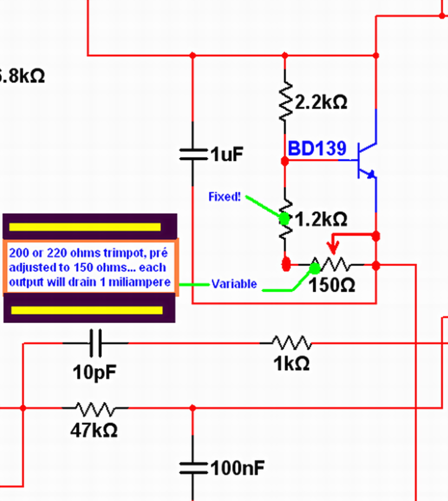

Dear Alex mm, please reduce R5 to 680 ohms and reduce the supply
voltage to 80 volts in the schematic.
Thank you Alexandru.

Carlos,
I do (edit) NOT want to give the impression that I am against you or against high-power amps. I am not. Maybe to clarify the issue with SOA. Contrary to what some people belief it is NOT about power dissipation, it is not about V * I, it is about the combination of V and I.
As you saw in the SOA graph I posted before, as an example, at 100V across the transistor (Vce) it can only carry 500mA. That is only 50W for a 200W transistor, but as said, it's NOT the power. The problem is secondary breakdown: at that high Vce, the current trough the transistor tends to concentrate at a spot on the chip that is a bit hotter than other spots. Because of the concentration, that spot gets even hotter, and you see what happens: runaway, local overheating and destruction. Poof! Gone.
Back to the amp. If I have 80V supply, then I only have 80V across the transistor when Vout = 0, right? With Vout =0, Iout (which is Ic) also = 0. So what's the problem? The problem is real-world speakers. Real-world speakers have phase shift between I and V, depending on the frequency, and depending on the xover filter. That phase shift is the cause that at the Vout=0, the Iout is NOT =0, so the transistor is still required to give output current. It's even worse: you get the situation that for instance with negative Vout, it still is the UPPER transistor that has to deliver the output current! So in that case, Vce across the transistor is even larger than the supply voltage and the current can still be relatively large. This is when the SOA comes in and when the poof! comes in.
How do we avoid that? First you decide on what you want this amp to drive. For a nominal 8 ohms speaker, you should be prepared for a minimum of say 4 ohms. You can draw that 4 ohms into the SOA curve: if you have 80V supply the line goes from point 0V/20A (80V/4ohms) to the point 80V/0A.
If this line does NOT cut the SOA line, you're OK. If it does, you can double the output devices which is the same as saying the min load is now 8 ohms, this 8 ohms line goes from 0V/10A (80V/8ohms) and 80V/0A. This line is lower in the graph and if the SOA line is not cut, you'r OK. If it still cuts the SOA, add another pair output devices and adjust the apparent Rload. Etc.
BUT we've not included the 45 degree phase shift! What that does is make the Rload line (which is called, unsurprisingly, the load line) not straight but with a bulge in the middle, an ellipse! And that ellipse of course cuts the SOA line quicker than the straight line. That means you need to add more devices than you thought looking only at the load resistance.
So far so good?
jd

Understand MJL3281 as "modern power transistor"...so, you can replace for other models you find as good or better.... they are in competition, so, they are not so different once compared to the other.
J4215 and J4315
2SC5200 and complementary
MJL4281 seems to be one of the best ones with this case...so... this is the best option...but dear builders can make better choice if they want.
I am testing once again, to have fun, feeling the heat over the load power resistances, the ouput transistors used in my prototype are J4215 and J4315.... matched units, sent my Anonimous last year

I am adjusting and changing things here...just for fun....i love that.....and i have found the bias a little bit dangerous...if the one install a 2K potentiometer than he will be able to overdrive the output stage...and the amplifier may drain all power from the supply while the man goes adjusting or tweaking...this may be dangerous if the one forget the rail protective resistances....so... thinking in these possibilities of human failure, i am asking you dear Alexmm, to try to make a change in the schematic and in the boards.
The VBE multiplier need some tweak to impeach folks to misadjust into dangerous values of current... this way they cannot make hard mistakes..the trimpot in both extremes of resistance will not be harmfull to the amplifiers.
So, there are images that explains and will be attached dear Alex mm...i will be glad to have an email from you to colect your email adress once again, as many format where made these last years and i have lost some of my adresses...also my email adress was changed and the other ones, older ones, had my order to be blocked.

There's a small mistake....i think mine, in the schematic..... we have 10 pairs printed in the schematic and wrong indication of 8 pairs in the rigth lane text...also these transistor options should be printed, as i have tried all them and all them worked and faced full power without problems.
The VBE multiplier has now a fixed resistance and a variable...i hope you find room to change that..i am sorry, i know it is a little bit late to make such kind of modifications.....i am asking your patience with me....my failure discovered when testing again....the former way was good to me..but maybe not good for people less skilled...and we cannot control the ones will be interested to build...i have to make it more safe.

I like the limiter in the Vbe multiplier.
Keep improving the schematic like this and us detractors might have nothing to say.
But, the values shown do not give an appropriate range of adjustment.
Use arithmetic as your friend, not foe.
Alexmm made the modifications i have asked
I have perceived the danger in the VBE multiplier fixed resistance adjustment..someone could remove the fixed resistance and substitute by a trimpot and misadjust in a very dangerous way.
This new way.... you will have 200 microamps in one extreme and 15 miliamps to each power transistor in the other extreme of the trimpot resistance.
Suggested resistance adjustment, the preset, should be 150 ohms.
