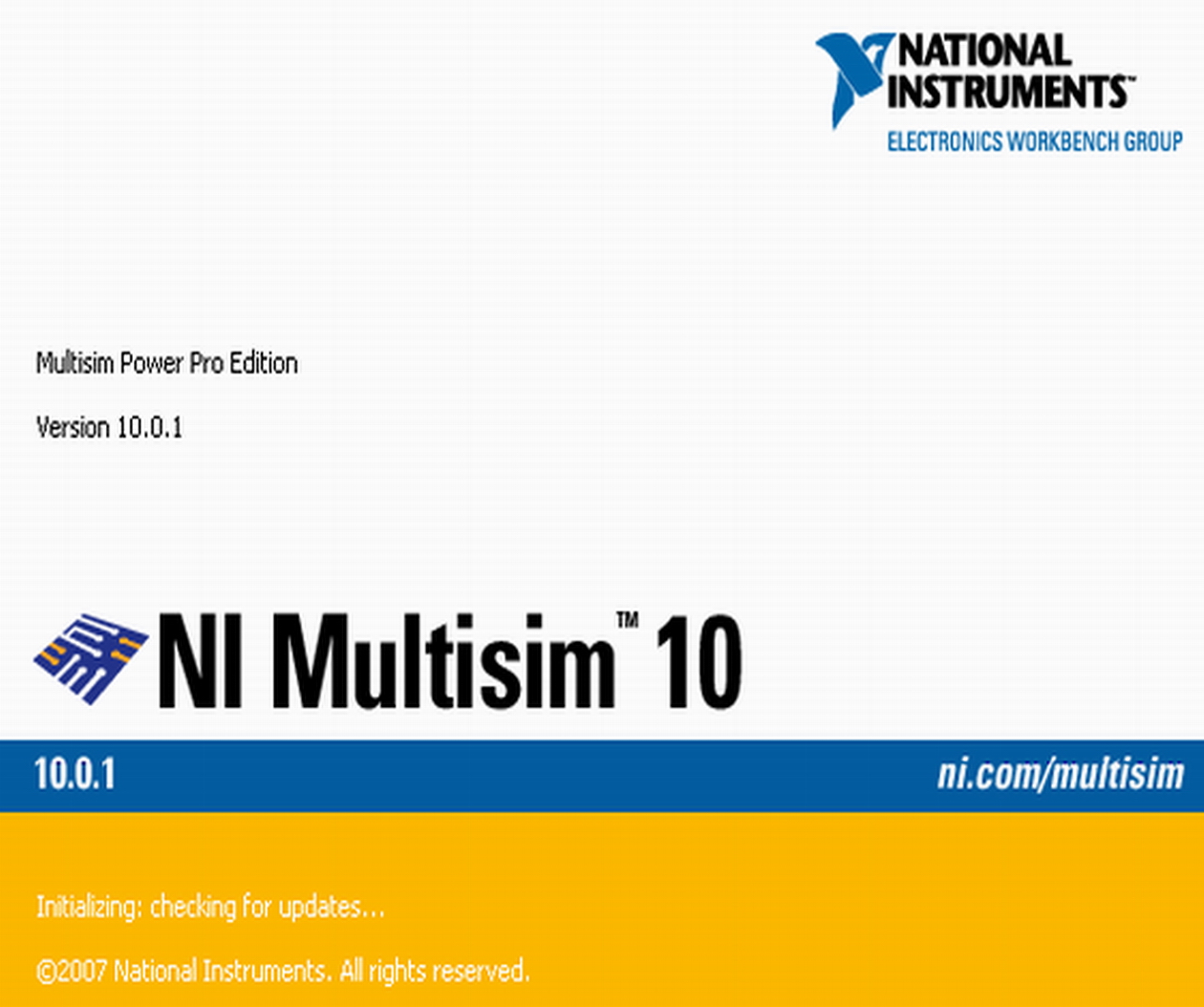

BC818-40 was removed...was used only to simulations, to check
distortion dear Sakis.... check schematic and observe all transistors can manage to face the swing we have in the stage.
The amplifier is operating, full power and over 4 ohms loads....not suggested to operate, the way it is now, the way shown in the schematic, with 2 ohms loads.
