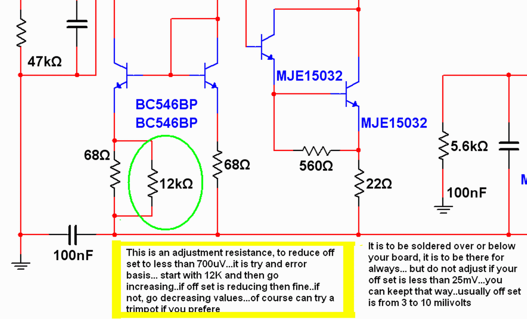

The misunderstanding was caused by my mistake.
The schematic does not show the correct part really used in the prototype...i have always used MJE15032 transistor for first and second VAS.... my intention was to replace but i have not another transistor for that position...soon i will have, as Evette from Canadá is sending me hundreds.
Old pictures posted in this thread may show you the second VAS big heatsink and you may see the MJE15032 in the first VAS position.
This was the trouble.... the prototype was using MJE15032 and i made the first mistake, posting a schematic from my simulator (generated by simulator and converted in pdf) showing the BC840.... this unit was just to make tries to see if i could find a transistor that could help me to reduce THD in the simulator analisis....i knew it could not face the voltage....was a try only and by a mistake it was shown in the schematic diagram.....gladly no one have built.... that transistor would not work there..it is a low voltage unit.
Then i made another mistake.... i have replaced after someone pointed the error,by another wrong one... the 2N5551 also cannot do the job...it can face the voltage but not the power.
Another mistake in the schematic, the first VAS emitter resistance is not 50 ohms.... it is 560 ohms....this is what was designed and assembled in the working prototype...almost 500 miliwatts iddle is the power in that transistor..without signal.
So, as people have not the prototype, or an assembled circuit, only watching the schematic, found these errors and complained...... and me....by my side, having a working prototype, could not accept the amplifier was not working..that would explode or be damage.... was working.... and working for monthes long.
Some small adjustments are being made...first to make the schematic a good copy of the reality..also some small tuning will be made...i do not like the 25 kilohertz square wave...i think we can make it better....also the limiter adjustment resistances will have a trimpot to adjust clipping simetrically.
We still have a "more real" schematic,but will have small modifications..so..i is provisory only.

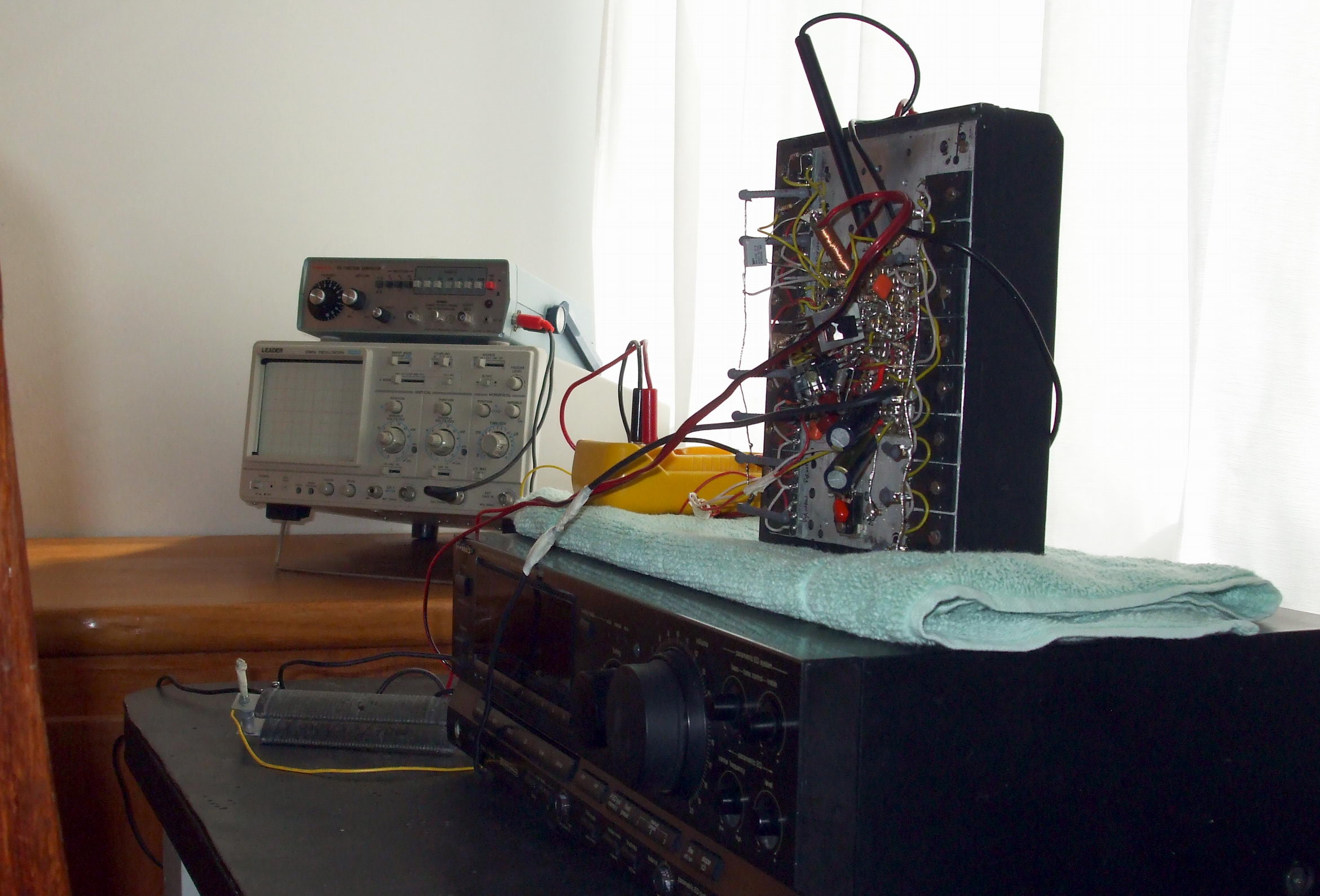

I have made tests with 3.5 ohms load...inductive+resistive load..and the amplifier survived, using only 5 pairs (this is the way prototype is) in the ouput... and because the supply i have used dropped the voltage to more or less 70V.
I believe it will work fine with reactive loads when using the 10 output pairs suggested...and soon i will test that...sadly will not be able to test with 3.5 ohms because my supply voltage drop.... as i will not have 80 volts..but i will be able to test with 8 ohms.
As i could not test to lower impedances.... and because of that i cannot guarantee the amplifier survival under these circunstances..under these conditions, them i would like to say the amplifier can work with 8 and 4 ohms only.
I have made some videos.... not only explaining these things, the main differences between the schematic and real life prototype, and some testings made.... i hope you enjoy.
Sorry by the bad image...i have two cameras..one has good video and other has good audio...i have not digital camera that has good audio and video.
Troyan amplifier is not guaranteed to work with speakers, or output impedances, lower than 4 ohms

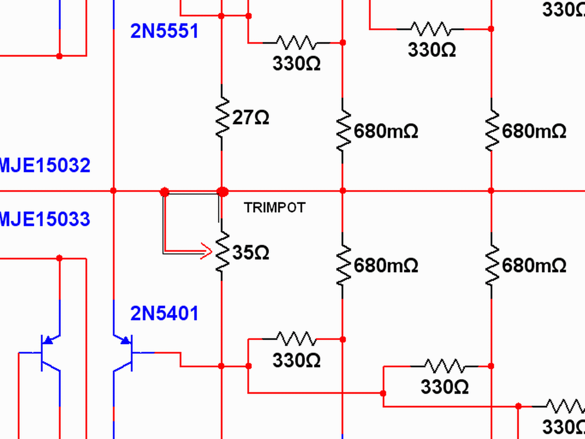

This is the updated schematic and layout from Troyan amplifier
Thank you Alex mm by your help.
I intend to open a new thread.... builder's thread...for builders only, this way we gonna have only the needed informations.
This amplifier schematic, layout and so on will go to Greg Erskine pages too..but i want to refine it first...also i have not part's list and Greg will ask me the BOM..also adjustment instructions and other details.
In advance i want to check how much interest people have to build big amplifiers...this one may reach 650 watts each channel, unclipped, 4 ohms loads, with 80 plus 80 volts supply (huge one or SMPS one) and THD will be around 0.021% to 4 ohms.... and of course smaller to 8 ohms.

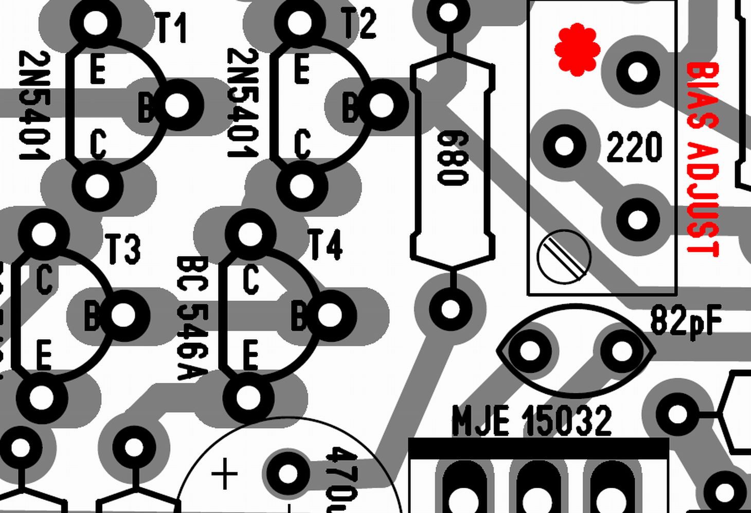

Alex mm, Dx Corporation European Layout Laboratories
have made nice X Ray vision...but too much big.
Then i have splitted in two parts to show you... soon i will learn how to manipulat layers and will have images by myself.
This board made by Alexandru, looks alike the Enterprise Space Ship.... wonderfull..not nice!..just wonderfull!

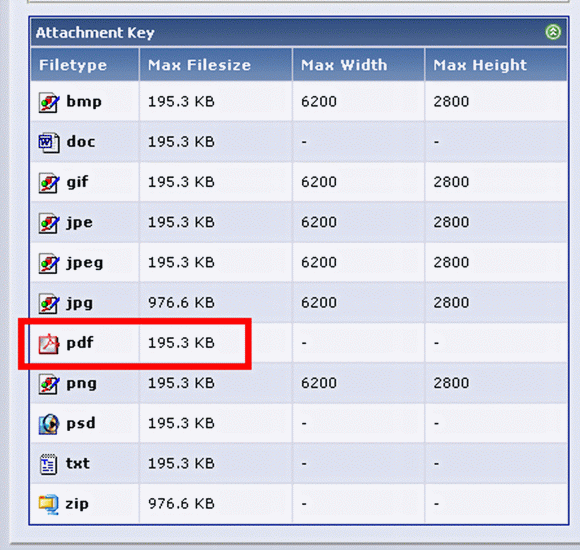

Builders!....please, write me and i will upload to your email adress the full size pdf file:
Use direct email....forum PM cannot attach images, goto:
carlos.eugenio1951@yahoo.com
regards,
Carlos

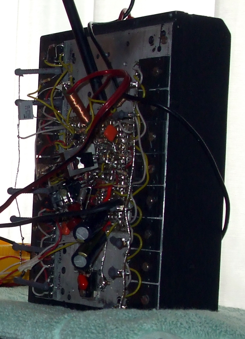

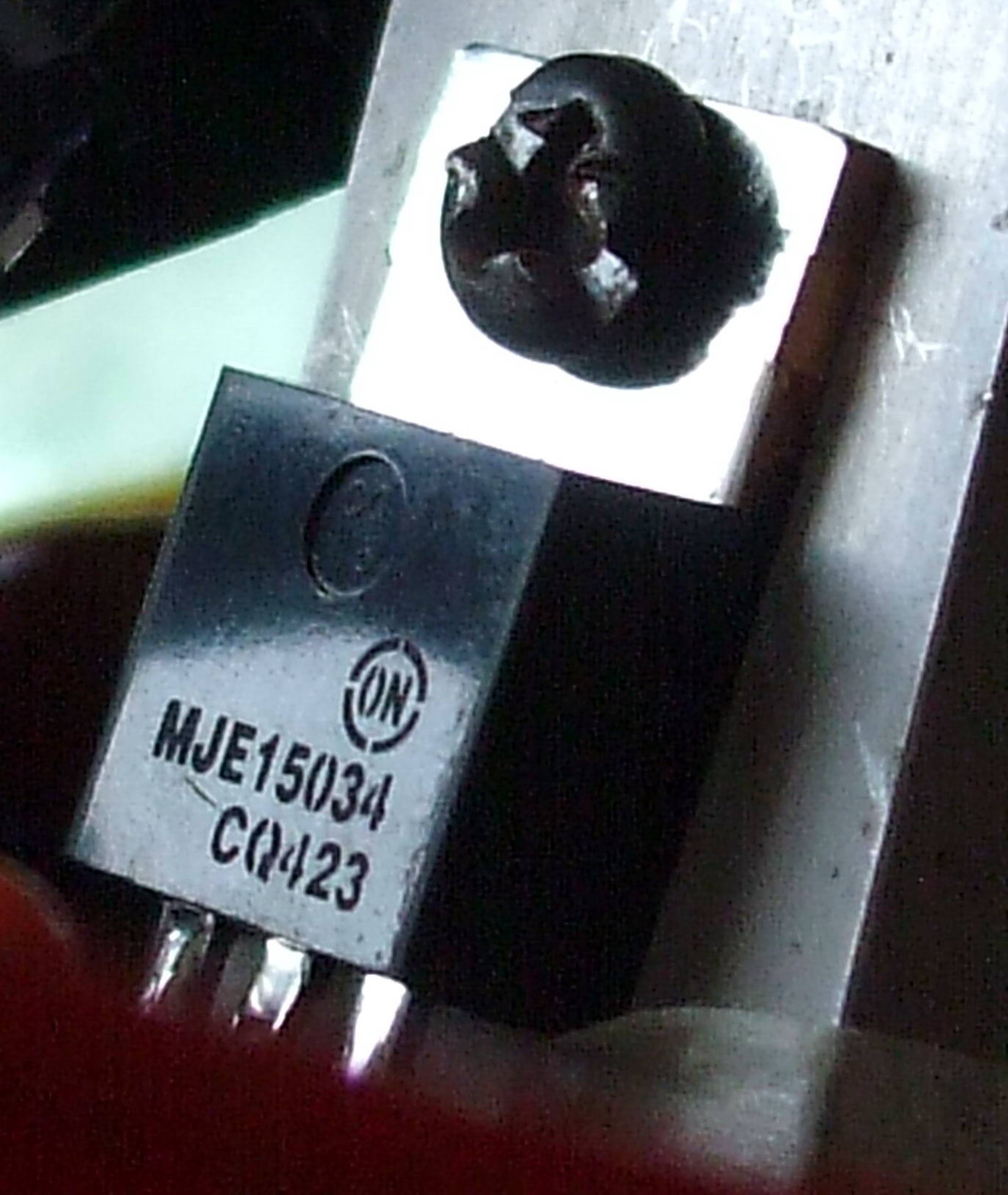

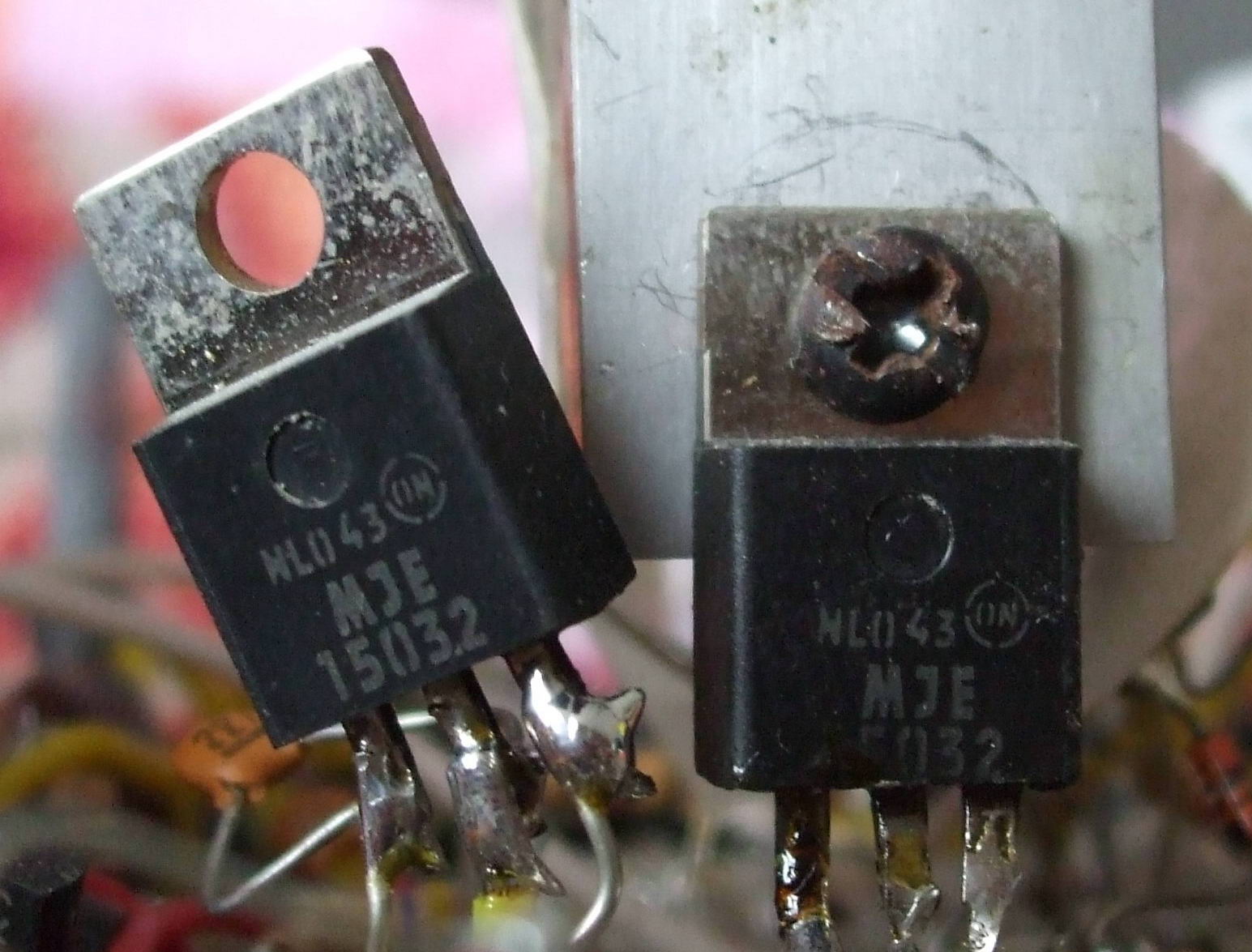

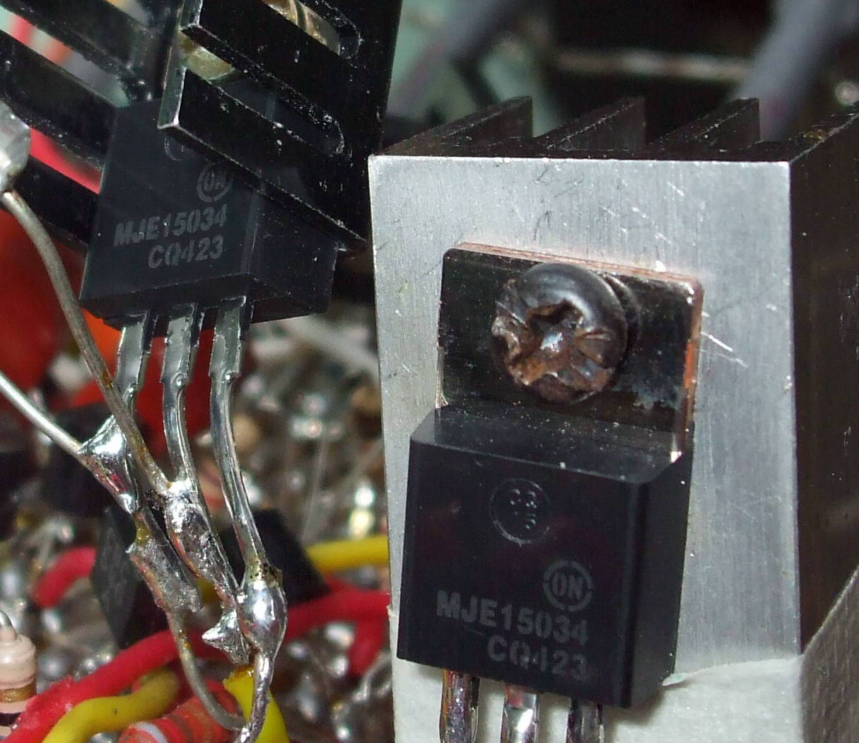

These pictures shows you the VAS stages...the way it was since the first day
the Troyan was built, and that was there working till yesterday when i have removed them and substituted by MJE15034 (from Evette - Canadá).
I had colector lead broken in the transistor case..could not solder anymore... this is the main reason i use to cut leads short..this is to avoid "mechanicall advantage"..... Alavanca (lever) in my language, to avoid broke the lead in a easy way.
regards,
Carlos
regards,
Carlos

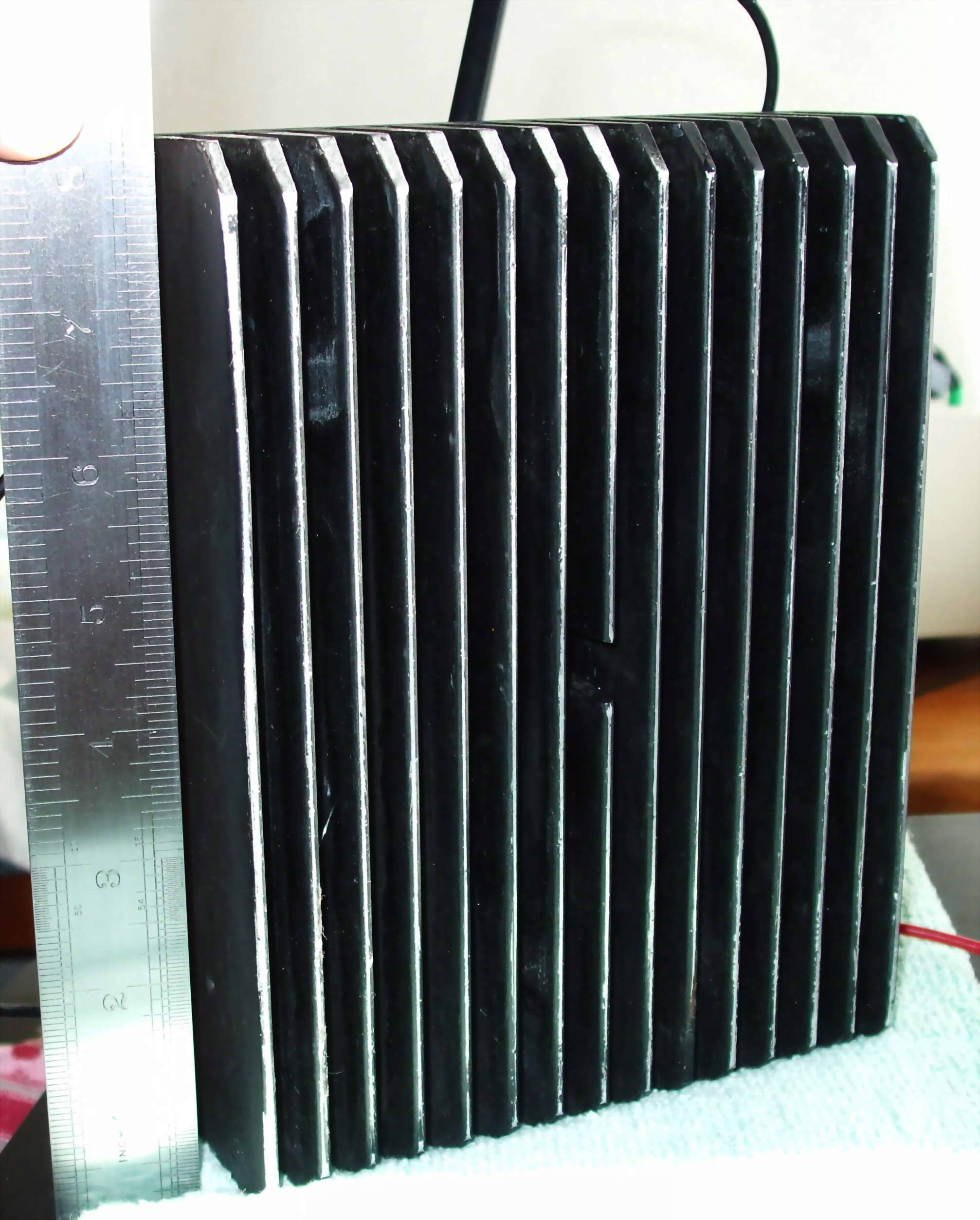

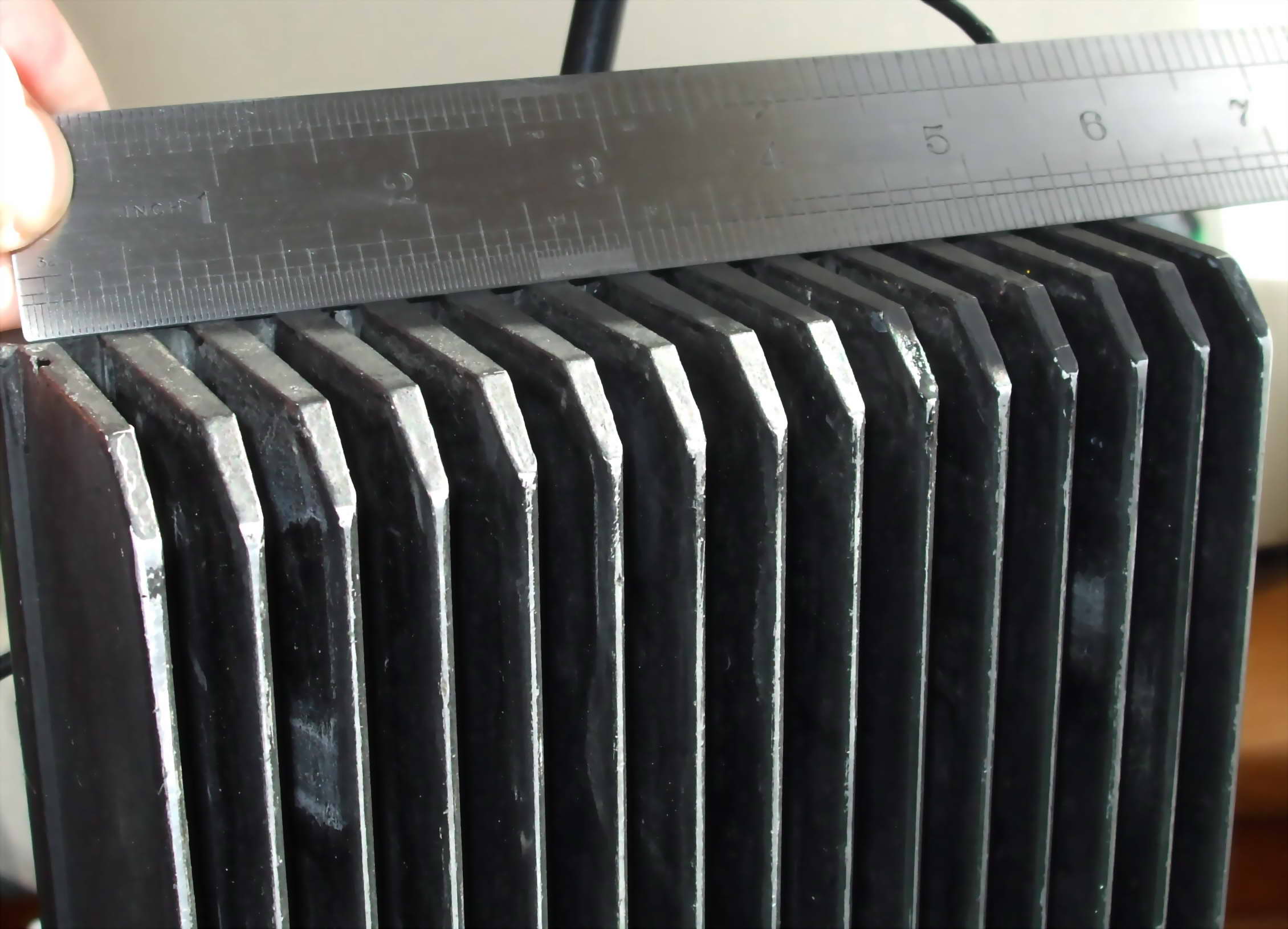

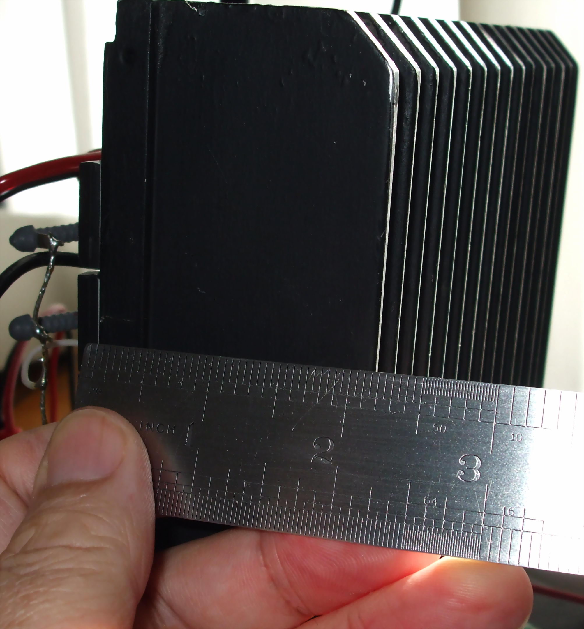

The heatsink i suggest to each channel should be big as this one
Then you will be able to use full power without troubles...but use a low speed fan blower (8 volts supply, an LM7808 may help to reduce from 12 to 16V)
2 of these ones to each channel..one for NPN and other for PNP...or equivalent to this area exposed to the air..do not worry about thickness, it just produce a delay in the heat transference..the heat exchange is made by area exposed to the air.
The images have dimensions in the place of identification names.
This one proved as not good enougth using only one to a single channel...so, i think 2 units, using fan blower may be good..or the equivalent in size..i am not absolutelly sure...but i can sniff that because of long time practice and i really think it will fit.
I will study, once again, fuses values and supply condenser values..will inform you as soon as i see several folks interested.
regards,
Carlos

The Troyan was made by a male.... the ones likes girls above all and everything...
the ones girls like....the amplifier wasmade to be strong and not to be kind with speaker..to give them a hard time..to punch with strength... to kick them without mercy.
Was made this ugly macho way to work, this is just a working prototype.... i had not the concern to make it nice...i had not spent a second with worries to make it pretty.
But you have Alexmm beautifull boards if you like them other way...Alex board layout looks alike the "Enterprise space ship"...long and beautifull.
Male does not use makeup...also let the beard grown..also hairs..usually they do not shave ..the voice has low tones ...and so this amplifier is...the beard was there, keept to scratch speaker girls and to say:
- "Me Tarzan...you Jane!
No intention to be kind with anyone of them (speakers in this case)
here is the picture..the rude and monstruous male Amplifier!
Are you a real male?...then build one!
regards,
Carlos

The monster!..this time recorded with digital camera
well..not a very good sound...camera does not register low tones..also the tiny speaker had received 40 watts...twenty to each one of them..the power amplifier in less than 10 percent it's maximum...what distorts is the speakers and the camera recording.
other recording uses stereo high quality electret condenser microphone..this is digital camera noisy trash recording.
Feel the emotion!
YouTube - Distorts because powerfull!... the Troyan monster
regards,
Carlos

Alexandru found a small mistake and fixed.
I will be checking resistance wattages very soon...in my unit all resistances are 1/4 watt (prototype)...of course not the power emitter resistances, but the other ones are 1/4 watt.
But it is possible i'm having one of more hot...and this may be fixed soon.
Forum's maximum size allowable to attach images is also informed down the pictures.
regards,
Carlos

The PCBoard fixed is too much big to forum maximum size
reason why i have posted in three parts...soon i will manage to operate a viewer, then i will be able to fix these things.
For a while, dear Alex, you could send me smaller files...maximum 190 kilobytes for pdf files.
If a builder wants the big file, then write to my personal email adress and i will provide you:

Here you have voltage chart and also some informations about current
Images shows details about symetrical clipping adjustment that will be included in the schematic (fixed) and a resistance to reduce off set that will be included in the schematic as optional.
Much more than other amplifiers, this one drains a huge current and will have external series protective resistances to allow you to measure the stand by current.... these resistances are a little bit big... reason why i will not include them, this time, below the circuit board... the resistance selected will be 100 ohms, as this will limit the current (under short) to something around 0.8A amperes...this resistance power should be a 64 watts resistance to sustain that short for long time....this is too much big..so we gonna use 100 ohms and 10 watts only... to test the amplifier very fast.....
Observe that having a correct assembled amplifier and following the instructions to adjust and trimpot preset value that will be informed, then you will have only 100 miliamperes crossing the 100 ohms resistance and this means the correct current will be 100 miliamperes, and this will have the reading of 10 volts and the power dissipated will be 1 watt only... so... 10 watts to the power you suppose you will dissipate under normal conditions is more than good....also will sustain shorts in the board (mistakes) for some time.
Keeping the 100 ohms we go to some kind of standard...easy of mind calculations without the need the aid of portable calculator machines.
So, because of high power over that series resistances, i will publish resistances measured from positive to ground and negative to ground, allowing you to check your amplifier before powering it on... and also trimpot suggested preset value.
Of course other resistance values can be used..some other values can be even better and cheaper....and you can select the ones you want...i am just keeping some tradition, where Dx amplifiers (alike great Aksa machines) uses 100 ohms series resistance.... a standard of tradition.
regards,
Carlos
regards,
Carlos
