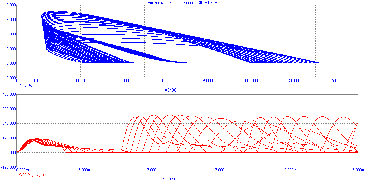

I do not want to make any intervention, as this is Carlos thread and he might take it different than I mean it.
Anyway, the crucial are number of pairs (known type of devices), type of load, supply voltage and SOA.
If the design is able to withstand 2 ohm complex load, i.e. it has enough reserve in the SOA (enough pairs of rugged devices in other words), I would not care about the V/I limiter. However, DC monitoring and protection is highly recommended to save expensive speakers.
SOA might be verified like in the attached image, for the complex load. All the curves in the upper graph must lie under device appropriate SOA curve. The lower graph shows instant power.

I have simulated to 1 ohm...someone asked that once
and i am surprised with the THD...very low (0.008%) at 625 Watts.
Each transistor will dissipate around 60 watts.... it may be possible.
Supply is 50 volts symetrical but 11 amperes to each rail... a very huge supply.
I am unable to check that...no dummy load to this power...no power transformer..i cannot do it..only simulate and check in the datasheet...looks good..but guarantee?.... this i cannot give you...as i give guarantee to tested amplifiers.
Modification is only to switch off protection removing the transistors and tweak the gain resistance that gonna be something around 1200 ohms.... it will put out minimum of 625 watts..in the real world will be able to produce more power.... depending, of course, as always, from your supply... a kilowatt supply to each channel is needed to produce 600 watts of audio in this amplifier (aprox.)
regards,
Carlos
