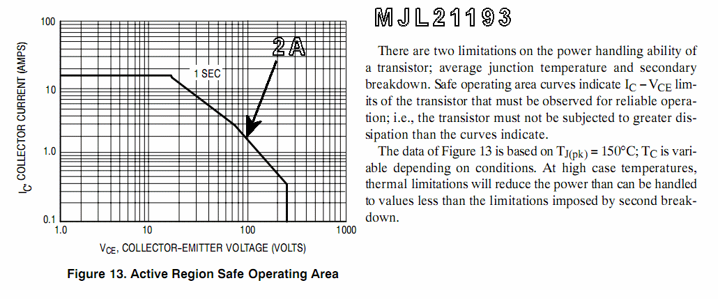

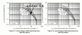

TOTALLY wrong advice , those devices are as different as cars and trucks , night and day.
MR. SOA = "This is only a starting point, because we must have a safety margin. Remember that the peak dissipation into a reactive load with a 45° phase angle is almost double that calculated above, about 1900W. If the transistors can be maintained at 25°C (not likely), that's fine, but we need to add more to allow for elevated temperature. I have elected to use 9 output devices, with a tenth device used as a driver. This maintains worst case peak dissipation at 212W - not much of a safety margin, but it should be ok in practice - in part because the supply voltage will collapse under load. "
quote from Rob elliot - ESP audio

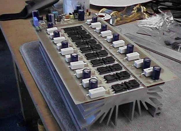

This is not a toy amp , like DX original this is a BOMB!!

Having built and tested a design more than 20 years ago that had plus and minus 120 volt rails, I am finding it hard to understand what the danger is here.
Is it the DESIGN or the voltages being worked with?
I used TWO Dunlap Clarke transformers to develop the voltages above.
I used 6 GE caps, three for each rail that where rated at 150 volts and either 20,000 or 40,000 uf each, (sorry my memory is not what it used to be).
This was for a SINGLE channel of a 746 watts @ 8 ohms design using mj15003 and mj15004 ( do not trust my memory on this) but I used 9 driven by 1 on each rail of these devices.
I knew the dangers, but practiced safety and used a 25 amp variac.
IT worked then and I am going there again soon, I hope.
Dangerous? YES, doable YES, but so is driving down the street and going to a airport to climb on a plane to fly across an Ocean at night with one engine. THINK Lindbergh...
I encourage ALL to LIVE LIFE and BE CAREFUL....enjoy the results...

Funny how we agree on number of devices, I wrote my post while you were posting yours and did not see your post first... Thanks
The outputs transistors where MJ15024 and MJ15025 what ever 250 volt devices available at that time where. The total swing was 240 volts plus a little.....
Both ... this is a butchered linn topology amp using drivers in the voltage amp to avoid using a proper triple output stage. VERY crude.
It should have a low current precision VAS (6-8 Ma) with at least a capacitance multiplier for and a proven current stage (triple with MJL21193/4's or TO-3 devices)
The voltages are VERY lethal , I am more experienced than some but even I treat voltages as low as 77-0-77VDC (my amp) as I would a BOMB.
My issue is that a hobbyist's who do not know how to determine the suitability of transistor substitutes should not listen to someone who tells them all transistors are the same. 😕

Those are REAL output devices ... lower Ft as well (less prone to oscillation), the only plastic device I would even consider is the MJL21193/4 with over 2A Mr. SOA per device.

Some will believe that all transistors are the same (example ; mje340/350 , Bc546) , I do not. The fact that they do trust that statement is scary indeed , as well as not knowing how to assess a suitable substitute using datasheets. Should you be advising them to build deadly amplifiers ??
You could of just copy/ pasted the SOA curve of the device instead of posting the whole datasheet. (below) you would need 15 pair of your OP's !!!

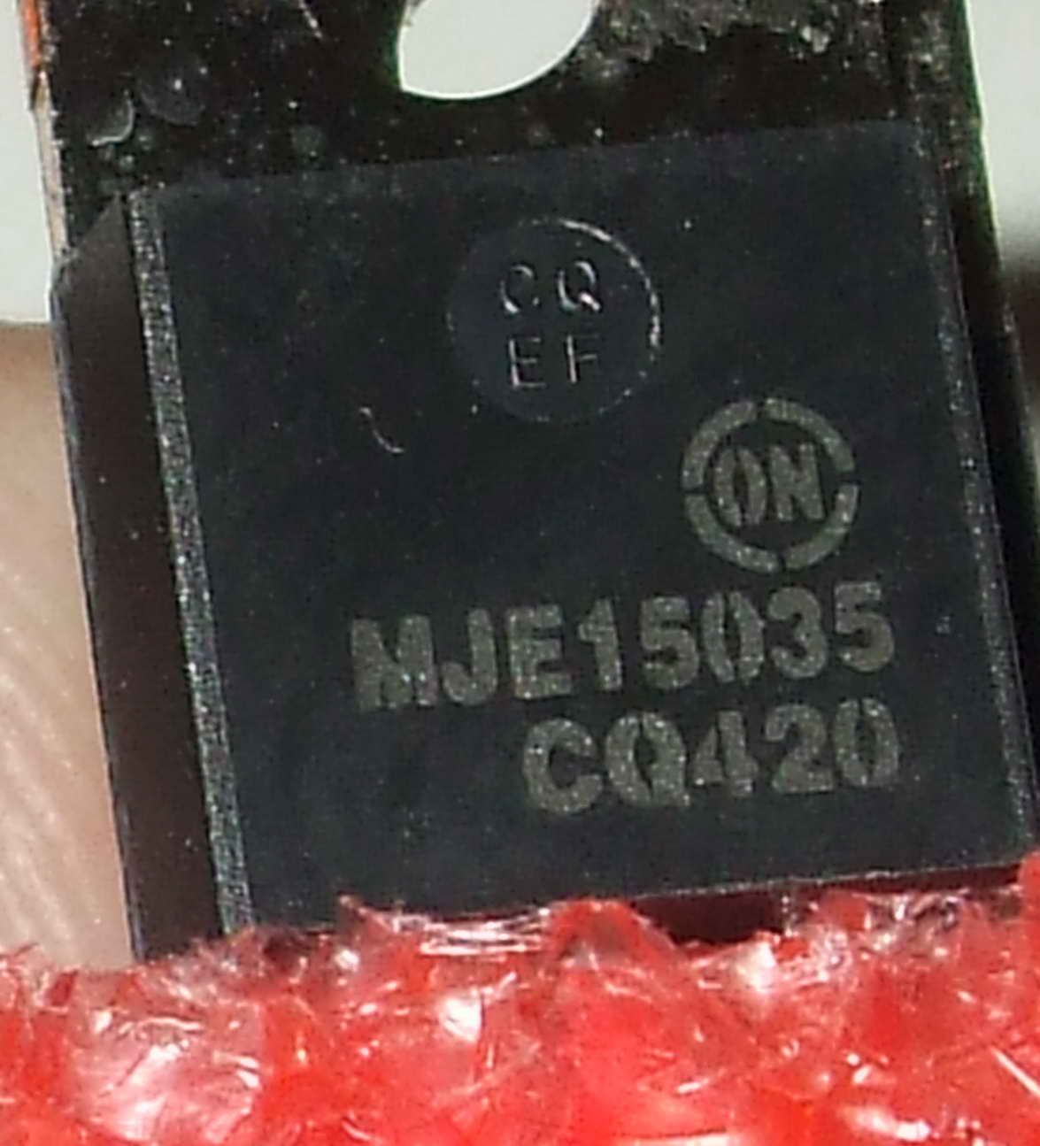

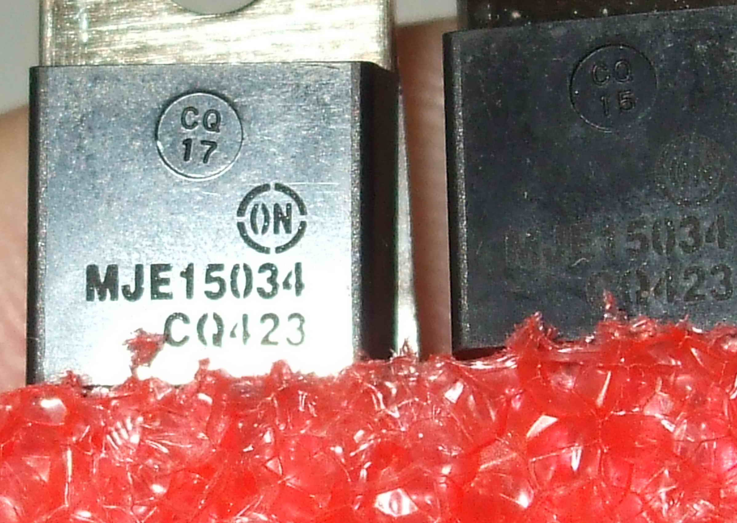

Dear Eesbiboi, ask these ones that criticise my design, the transistors they
would use if they would build the unit... and you should use their instructions as you matter for me....builder's matters.
I am sorry not to make it myself.... i am sure some folks are not real friends....and i dislike to be behaving fake being kind with them.
If tjese substitution i have pointed are under suspection, and i cannot test what i have suggested, as i have no more these units to use...i think it will be more safe to you, to use the original parts, because i have tested them and i can guarantee what i have found in real life...if not...if you cannot find the original ones, then try the ones suggested by the critics.
They are ringing the alarm because they want...as i told everybody, i have a working unit and had not problems... real life test has much more value in my point of view.
If something strange happens after you accept elsewhere suggestions, despite i believe anything wrong may happens, you know what are the untested parts and to wich one complain.
I have doubt about the BC840 substitution only, and i have not units to try... i have soldered and tried the MJE15032 in it's place and worked fine...but you said cannot find these transistors in your place.
MJE15034 and MJE15035 may work fine too..but same problem to find in your place if i understood correctly.

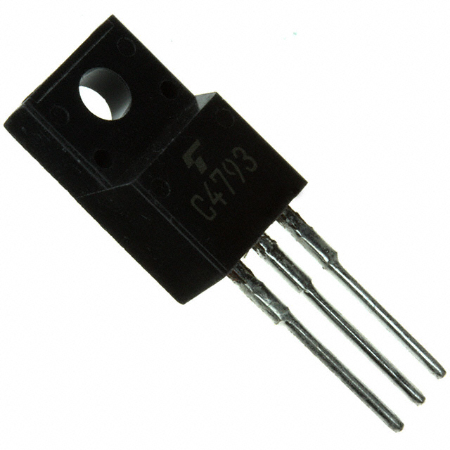

sir,...
in my previous amp build, i have replaced mje15032 with c4793... will this tranny be suitable enough to do the job for BC 818-40 ???...
as for here in our place mje's are really very hard to find...

That being said, It is a very good design amp that will work for years at a much more reasonable supply voltage of +- 65 volts
4 output pairs is plenty for 8 ohms. this gives an easy 200w RMS which would require 2Kw to double the sound volume.
if more power is required for subs, use multiple drivers
