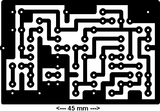

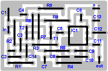

carlos,
sir the design posted in post #50 is not that clear...it also doesnt have the pcb layout itself...it only has the parts placement guide...
i'd like to have them like this...
sorry for bieng so demanding...😱😱😱
tnx...
regards...

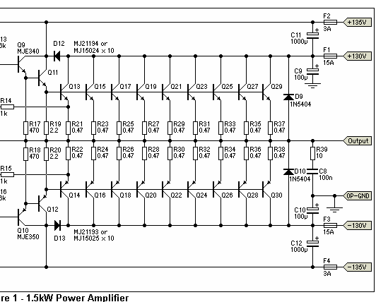

all files you need to build your own TROYAN amplifier
.... eesbiboi ,you have all layers ,here to build ,this powerful amplifier , a lot of components and expensiv also ,but with great satisfaction 🙂 check first if PCB was layout acording to the schematic . Sorry my bad english .🙁
Regards Alex.
Regards Alex.
Thank you Alexandru! .... but dear Eesbiboi.... this one is dangerous
not only for the poor speakers sentenced to death, but also put your heath under risk..... voltages are harmfull...also your home wiring will be submited to stress.
I hope you really know what are you doing...i have to say that i felt myself scared using it.
Take care man!
God bless you....and protect you.
regards,
Carlos

Good warnings destroyer.
And personally I can not understand why make such amplifier.
There are almost no speakers that can survive 1000 Watt. Not even 500 W.
And if a loudspeaker needs 1000 Watts, then better get yourself a good and better speaker.
Normal people will never need this. It is crazy 😀 😀
Professionals Arena events at Wembley Stadium maybe ....
Regards, Lineup

I really can't believe people take this amp seriously. The MJE's CAN NOT take that much current, especially at 4R. The output section will "droop" at 16A .
Use a dang triple with output transistors as the drivers. And why the hell would anybody use the MJE's for the VAS ????? 😱😱😱
A very, very poor design , goes against every major manufacturer's scheme. Even Rod elliot (ESP) says so (below - triple) 100v is not enough for 1KW/8R , unless you drive 4R , THEN you will really get "droop", or the MJE's will burn up
Even 10 pair of the MJL3281/1302 will not survive 16A , maybe MJL21193/4's would just "squeak by". READ UP ON SOA !!!
For a get down and dirty amp like this , use 5-6 pairs IRFP240/9240 vertical mosfet's to get your 1156 watts ....CHEAPER, since this is no audiophile amp anyways.
To advise forum members to " play" with this deadly voltage using such a sloppy design is against better judgement and could be fatal and/or expensive.
This is the one time I feel moderation is in order.
GET IT TOGETHER , MAN. Read project 117 - ESP audio pages,Doug Selfs book... something.

Not unkind at all , you lead your followers off a cliff. This has to be the worst design in forum history.
Look up the SOA of the output devices and drivers , I am right and you are WRONG !!!
At 100v , the MJL's can't even sustain an amp. So you would need 16-18 pair to do the job. 12 pair of MJL21193/4's might do. Even worse the drivers can't even do 100ma SOA at 100V. These are truths , not ill will. I did not make these parts , I just report what is real.
As far as the design , it is bad ... it will NOT sound good at high power levels, and IS dangerous.
It is a VERY expensive way to get 1000 watts as well (over $130).. just for outputs that will burn anyways (with that design).
You fail to listen to reason , I would use the MOSFETS personally (Church amp I really built for $$$) only $35 .. no SOA issues.
OS

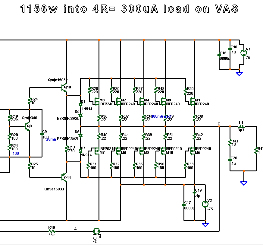

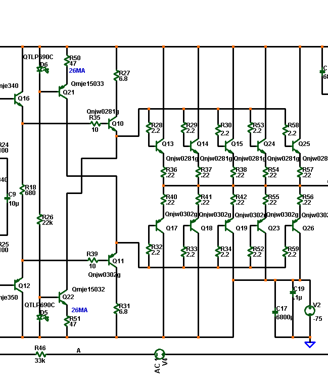

I suggest you redesign this.... for safety's sake. What is below is the real way to do it. I did notice you started using "suckout" CCS's (self type3) and other tricks soon after I did anyways.
Output stage below works .. no oscillation , just trickier to thermally compensate.
I don't need that much power , so keep the design , you could power 50 pairs of mjl's off of it. 😀😀
OS
OS
Not all is true.
You forgot that the device only conduct 50% of the time,
letting the remaining 50% to his symetrical siblings.
Thus , with 100V vce and one ampere , the said device
will dissipate 50W , which i think is within his SOA curve..
Since the maximal dissipation occur when the output voltage
is at half value (averaged in case of a sine ) , and this amp s
PS is +-100V , maximum dissipation will occur when the output
is at a mean value of 50V.
With a 2R load , that translate in a 25A output mean current.
Thus , the disspation of the power devices will be equal to the
power dissipated by the load, that is 50 X 25 = 1250W.
At 50W/device , this mandate the use of about 12 pairs as
a minimum value.
6 pairs who do it with a 4R load , although it would be more
cautious to go to eight...
For the rest, i more or less agree that the design is not
enough tweaked.
Wahab, SOA is not about power, it's the combination of Vce and Ic that is limited, even when it is a lot below the 'official' allowed power. The max dissipation is a DC spec. Check the SOA curve.
But hey, who am I to recite the data sheet. It is everybodies own choice what he wants to build, but if you lead people to a certain path, you also have a responsibility that goes further than trying to get the most followers.
