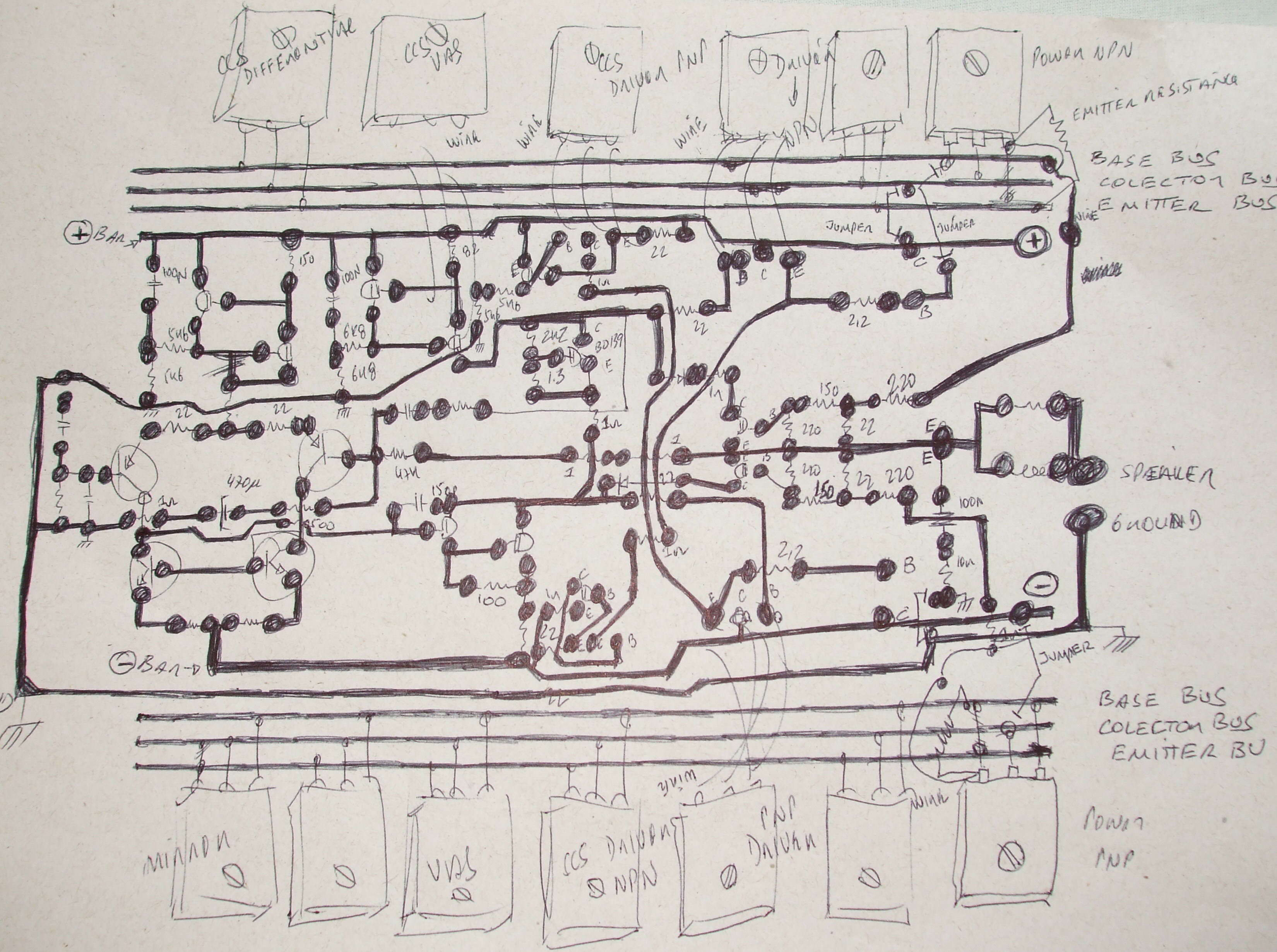

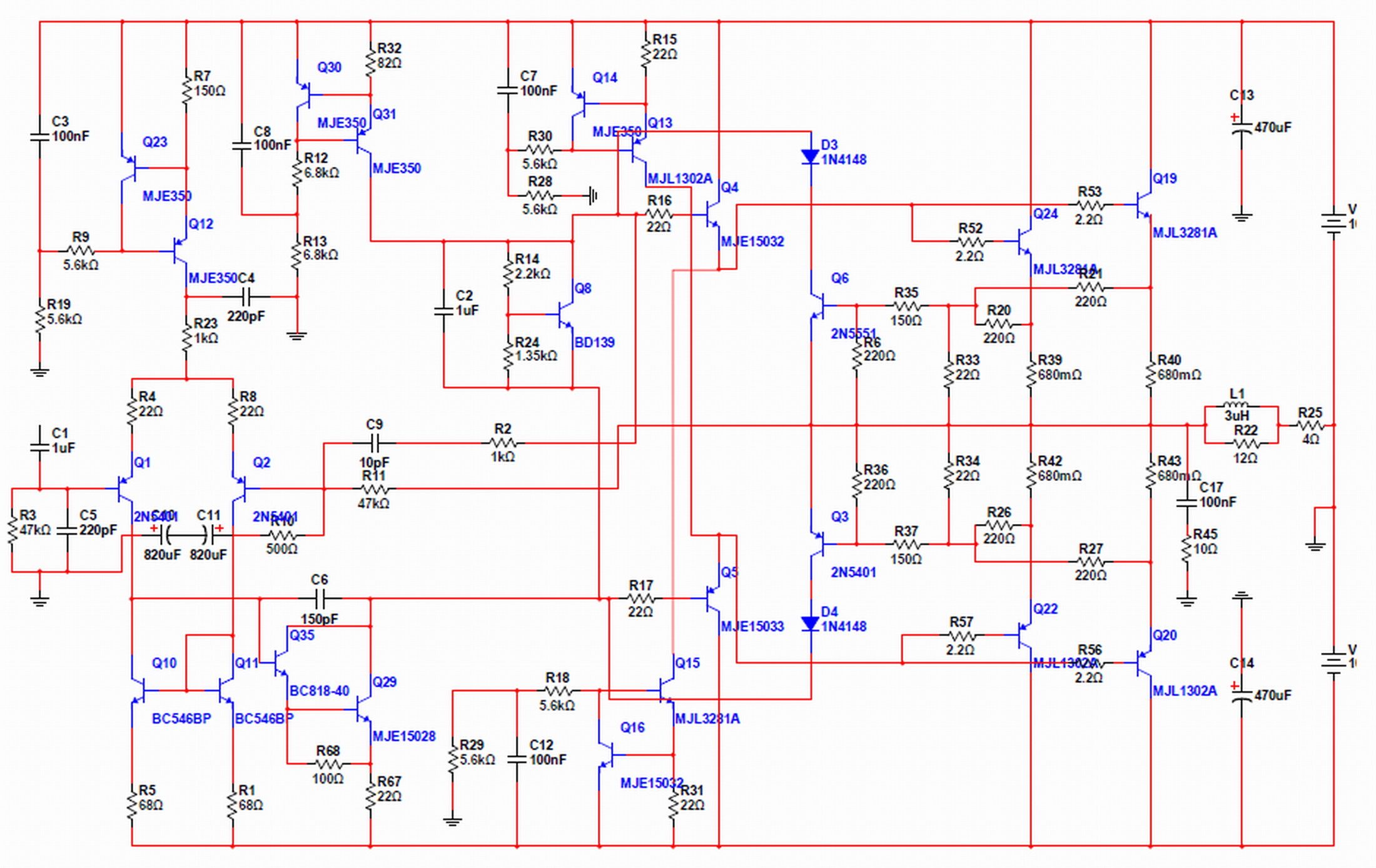

Dx Troyan, a 650 watts channel amplifier.
This is you can criticise.... it is terrible!..awfull!...ridiculous!
🙂🙂🙂But this is a helpfull hand.... a movement of goodwill..... an intuitive, old style, hand sketch, the board made using pen and paper... an idea..a suggestion, something may help...and... WHAT IS BETTER... people will try to make it better (not difficult to do it better..it is awfull!) and this gonna be good to everybody, including me.
Can you, dear friends.... make better than me?
Errors?....of course there are..always have...humans does that....me human..so..i can do that too.
regards,
Carlos

I have already posted the schematic having part numbers on it
:Popworm:was a pdf file published in post .
Here you have once again.
But i think i will change the Darlington Vas to a single transistor VAS... seems sounds better and waveform is also better.
You see the way i use to learn..doing!..... i found two stage VAS better in several amplifier..in this one produces more 3 volts in my output without clip...but only power...the waveform is worse with the darlington VAS...and exactly the opposite compared to our spectations, the old, ancient and not very modern single transistor VAS, in this amplifier, is performing better...i will check this all day long.
And then come the theorists to say the double transistor, naturally other than mine double VAS, sounds better... that a " correct implemented design works fine "...ahahahahahah!.... their designs naturally!... i cannot appreciate them..they go out from the reality... simulator minds they have.... despite can have good intentions and be skilled (have studied a lot of theories and memorized them)..they are enemies of good sound reproduction..as goes believing without test their beliefs.

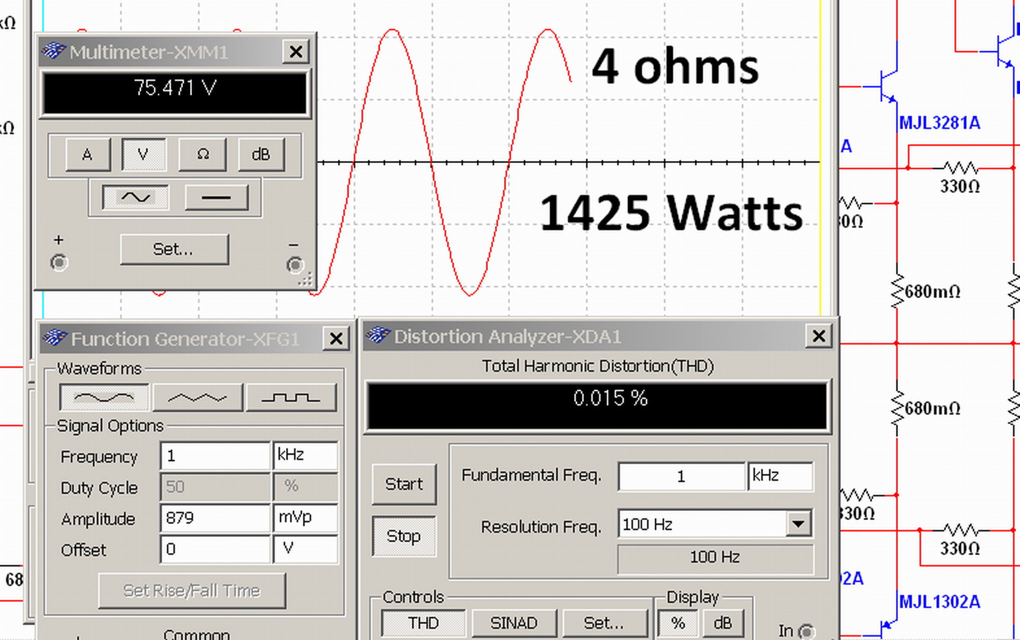

The Troyan can operate from 12 volts to 120 volts symetrical
So you will have power going from a very low level, around 25 Watts to 1450 watts rms each channel.
This allows you to assemble with the supply you have and power output transistors will depend the supply voltage, and this will be reflected in the ouput power.
Distortion can be low as 0.004% THD when operating with 100 volts..... go to 0.015% when operating with 120 volts ... so...you can have more than 900 watts each channel with a very low distortion.
It is using CCS to the differential, CCS to the VAS, using darlington VAS and using CCS to the drivers, one CCS to each one of them.
This turns the amplifier a monster of power, delivering enormous peaks of current, that will drive your speakers (I hope you have more than one) to maximum excursion, not matter how hard they are to move.
This amplifiers was assemble and playing for a long time... it is stable and produces amazing sound... 20 kilos speaker enclosures, even having rubber feet, is moving in my room, so huge is the speaker vibration in high power.
This the real "Universal" amplifier...because can work with the supply you have, the supply you found, the supply you like.
CCS to drivers was used in Electrocompaniet amplifiers... what does?... makes bass punch huge, more controlled and reduces distortion.

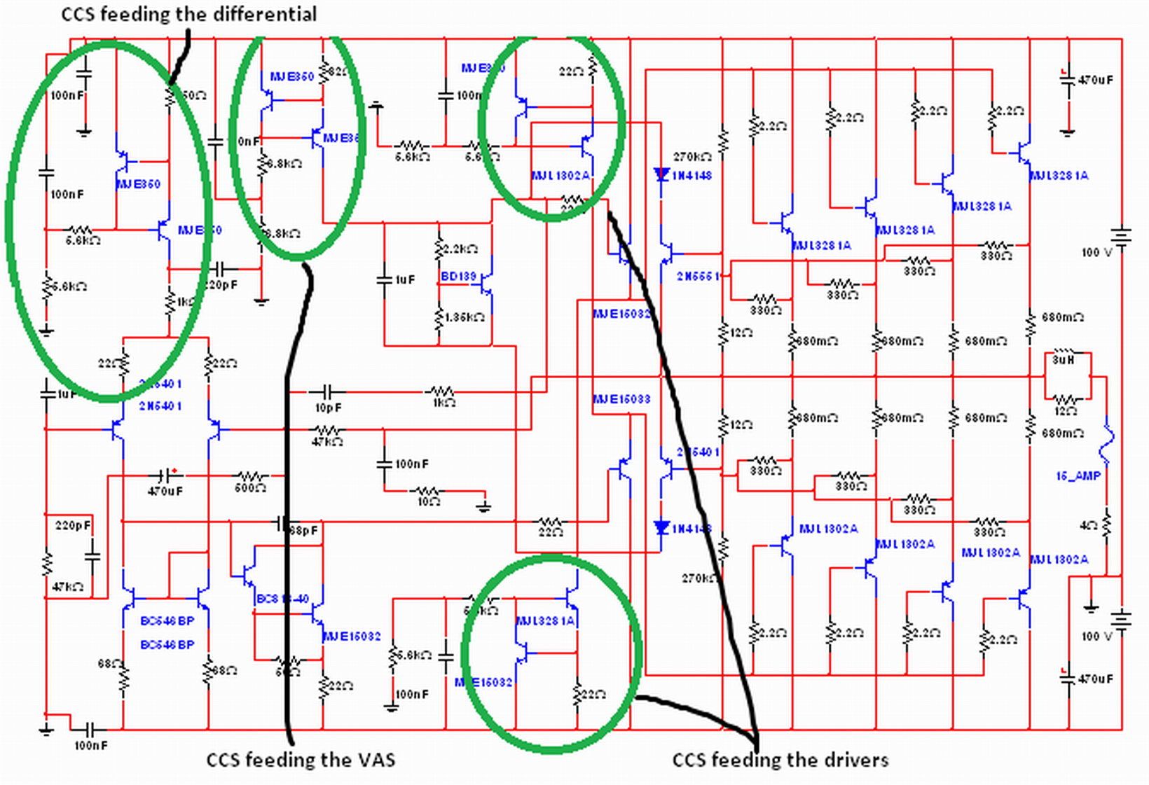

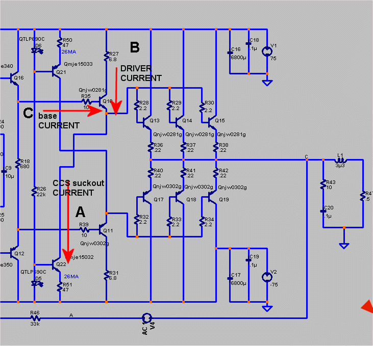

Reason why i am using CCS to the drivers
Main reason why is that Electrocompaniet have used.... and they are very good designers... and i use to copy the good ones to be one of them (one day!)
Technicall reasons in my understanding:
Speakers use to have impedance valleys...in some frequencies, they use to offer to the amplifier a very low impedance and this is helped by the passive crossover.... also you may want to connect your amplifier into 2 ohms impedance and want it not to loose too much power compared to 4 ohms speakers... you want the opposite..you want to have more power.
The main idea is to provide more current to the drivers, a reserve of current, much more than needed, to face extraordinary sittuations.
We can increase driver current reducing it's emitter resistances, beeing floating ones or beeing the standard two resistances, one to each emitter and connected to the output line.....BUT this creates a problem too..when you have increase of current (dinamic operation and iddle operation) you have increase of voltage drop over these emitter resistances.
This increase of voltage drop will decrease the voltage from colector to emitter, reducing the voltage swing and of course, the consequent current swing sent to the output transistors.
The use of CCS, having 20 to 30 mA,will provide a fixed and much more stable voltage to feed the drivers...not having that resistance there, as we do not use resistances anymore, the voltage drop will not exist..so...all voltage swing..and current swing (or almost) will be sent to the drivers.
We perceive that as more punch, in special in low frequencies and in low midrange frequencies where you have drums and some voices....more power to the amplifier, more stability in the operation.
Test this by yourself in your amplifiers..this is good to all amplifiers... Electrocompaniet solution

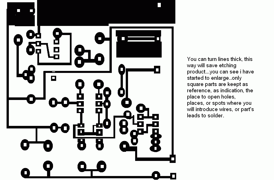

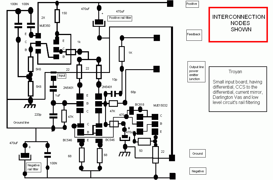

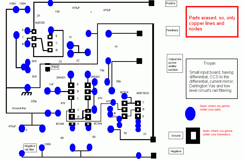

I am producing a board layout to offer.... will be constituted by modules
The first one, i will present now, have the differential and the voltage amplifier...next module will have the VBE multiplier and last module will be the output...i will try to arrange CCS assembled in a pile style, one transistor above the other.
The sequence of images, will show the easy method to produce boards at home, a craftsman style, with a pen painting the board.
I know now a days people loves to produce professional style..but DIY means another different thing, and some guys in this forum are really good ones to produce boards at home.
Final work will show how these modules connect one each other..using wires... to be assembled above a flat heatsink, or a flat surface of a multi finned heatsink.
regards,
Carlos
Observing the schematic, watching it and at same time looking at these images
in the sequence, you will perceive this is the schematic...exactly the schematic in positions..what is left in schematic is left here..what is top is top here..what is low position will be low position too....no secret, no trick and no magic..just the most simple possible thing.
Observing you will notice the method is very easy, and that takes much less time than produce boards using software.
It is less pretty, but has more pleasure..as you did..not the software.
This last image..i have just started to join lines in big islands of copper..only the top was made to present the old style to the ones does not know..but the invitation to you, to do it by yourself, producing these "islands" the way you like is registered here.

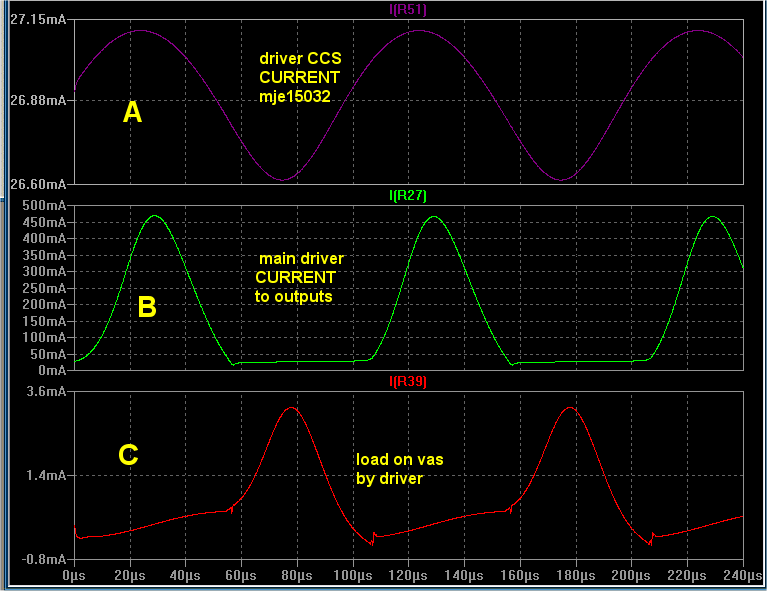

I will not discuss theories
Hey , these are just amplifiers... calm down 🙂
I just don't want anybody to get hurt :flame::flame:
I will not discuss theories , I will show you.
In the 2 attached pictures , A - B - C are the currents. A is the driver CCS . At 26ma, a mje340 or mje15032 is just fine since the current is constant within a few Ma of 26.
B is the big driver current running the 6 pair of outputs or more into a short :flame::flame::flame: or a bunch of paralleled speakers. At 400 - 800 ma ,you might want to use a output (njw0281)as a driver as a mje15032/33 are too "wimpy" (soa to small) to run all those outputs.
C - the most important thing- the load on the vas by the drivers. At 3ma , or even 1ma this will DISTORT the clean music signal produced by the amp in question. This is why an additional pair of predrivers (mje340/350) is used to reduce the load to VAS to microamps. with 3-4 pair output a single pair of mje15033/32 is fine. 5 or more with heavy load , what you see below is the way.
OS
