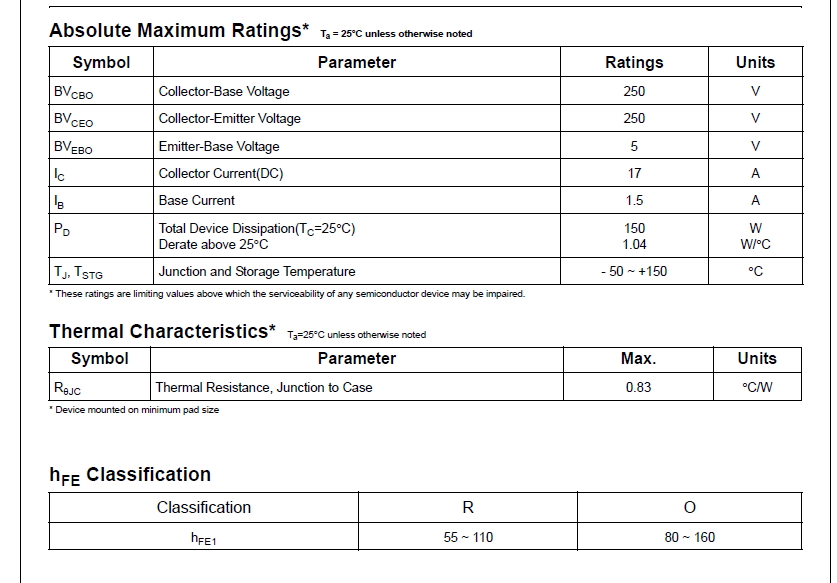

Carlos please read what is written several times: it is NOT the power dissipation. It is the combination of Ic and Vce that necessitates the paralleling. Please check out the SOA picture in the data sheet, that's the least you can do. Then calculate the Ic-Vce combinations that will occur in this amp driving a real world speaker with its phase shift. Please.

Wahab, SOA is not about power, it's the combination of Vce and Ic that is limited, even when it is a lot below the 'official' allowed power. The max dissipation is a DC spec. Check the SOA curve.
But hey, who am I to recite the data sheet. It is everybodies own choice what he wants to build, but if you lead people to a certain path, you also have a responsibility that goes further than trying to get the most followers.

You will also noticed that i retained a value of 50W
for devices rated at 200W TDP ,since the datasheets
specify this very same SOA at 25° C, which is not
the case with an amp that see its OPS device gladly
reach 70/100C°.

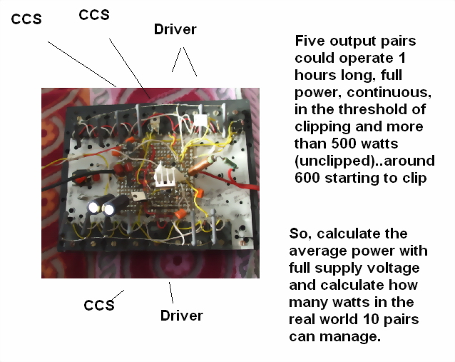

You see here the prototype, was tested...voltage has dropped, also power dropped naturally and was not the full power designed... you see that 5 output pairs (J4215 used, observe that some transistors are CCS and drivers) could manage to face 600 watts during one hour long (i used fan blower of course..the heatsink cannot face more than 250 watts of audio power...different than watts of heat).
If 5 pairs could manage 600 watts...then 10 pairs (suggested) will manage 1.2 Kilowatts...and the amplifier does not reach more than that unclipped...also supplies will have voltage drop... in real life this amplifier will not reach 900 watts RMS...so.... was tested folks!
And against real world there's no argument!

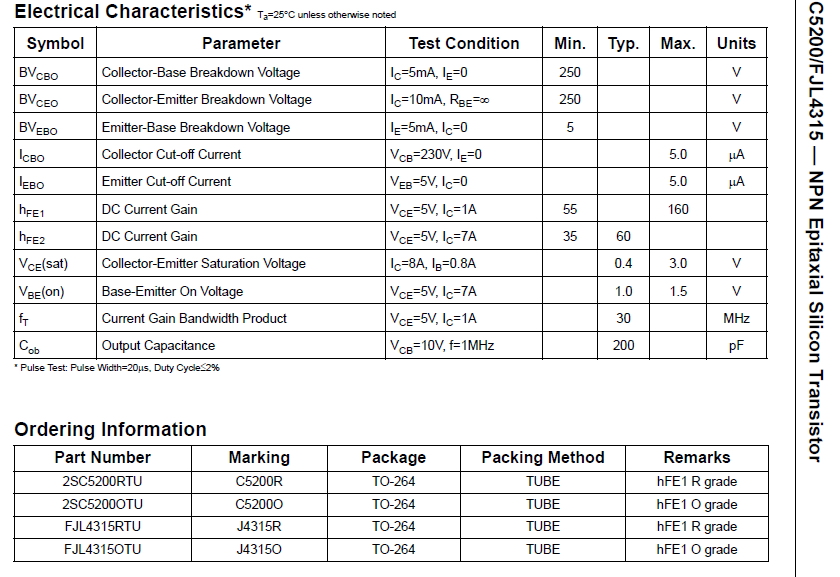

These transistors can manage to work with 180 volts peak to peak or i am wrong?
Maybe you are rigth if they cannot manage that...as this i could not test, my supply had voltage drops.
If then cannot, then i can replace them to MJL4281A..... them i will replace and will ask Alexmm to fix in the schematic and in the board layout.

Was tested, and i have used other transistors.... i suppose they are not that different, as they belong to the same family.

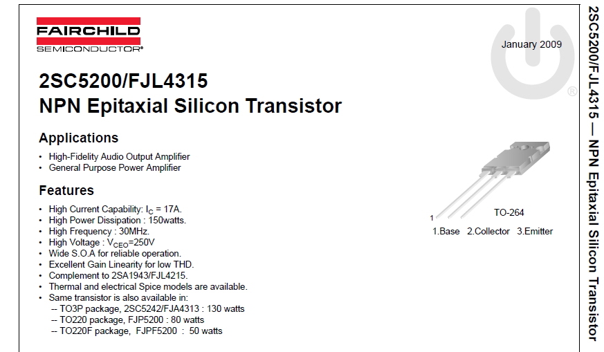

Here you have the J4215 and J4315 informations...datasheet is too much big to attach, but you can download it from the WEB.

Carlos, I tried to explain that it is not a power dissipation issue but a safe operation area issue. It has to do with Ic-Vce combinations (NOT Ic x Vce which is power) that is of importance.
Anyway, the issue should be clear.

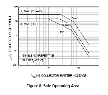

Wrong Carlos, this does not show SOA. You DO understand SOA, don't you?

This is the Safe Operation Area curve. You can see that at the moment the Vce reaches 100V, the max allowed IC is about 500mA.
This needs to be coupled with the phase shift of a speaker load which will draw appreciable positive current even with Vout=0 or negative, so you can get the situation that Vce is larger than Vsupply and STILL the transistor has to deliver current.
It's hard to predict the max phase shift of a speaker; often designers use 45 or 60 degree as design worst-case value. It can all be calculated but it takes a bit more than this post. So, be conservative, and for 100V supply use LOTS of output devices in parallel. Or, maybe someone here can do the calculations.

I see....so, it is not safe...have worked with 98 volts positive and negative
over 8 ohms...when voltage drop is not that big.... had produced almost 500 watts, during one hour, with 5 output pairs..and it is not safe.
Not safe means that will burn?..... or means that will burn because the SOA wants to burn?

Replacement suggestions.
This BC840 is the one reduces a lot distortion..but you can try a bigger one, alike MJE340/350.
To the drivers and CCS, you can use other transistors able to dissipate 10 watts and units that can face 200 volts or more from colector to emitter..there are millions of units you can use....current will not be the problem...and even the smaller one in To220 case will be able to face that current or more.
To the drivers you can even use the same transistors you use in the ouput..they can work fine there too, despite some small loss in gain...also i have used the power transistor as CCS to drivers.
BC546/556 can be substituted by 2N5401/5551 and other million of models, ancient and new models.
The output transistor may be units that can operate with more than 200 volts from colector to emitter, units able to face 5 amperes or more from colector to emitter, units to dissipate 100 watts or more.... so, these one you mentioned will fit...and other thousand transistors will fit too.
I am not the best one to suggest options of transistors, but at least i have tried to help...let's listen others....wait a little bit to see if other suggestions will be posted...as these guys are crazy to help..you see how they have jumped in the thread?... crazy to help maybe...we gonna see that soon.
