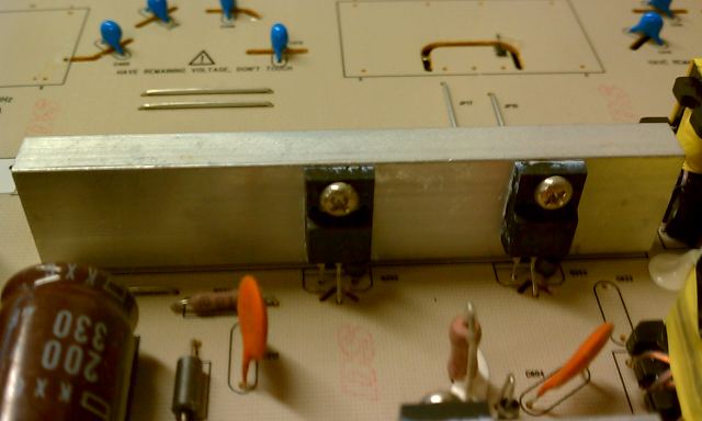

I have my Precision built with drivers, output transistors, and VBE multiplier on the same heatsink. The VBE multiplier is dead center, with the drivers on the sides, then follows the outputs, as per the PCB.
I had a quick question about this. Would it be better for me to take the drivers out and mount them on the top of the PCB with their own small heatsink? Such as this: (The heatsink currently resides on an LCD TV SMPS, but can be salvaged.) There are fins on the back, but they are horizontal, not vertical.
Also, I know it will be better if I move the VBE Multiplier transistor closer to an output transistor.
